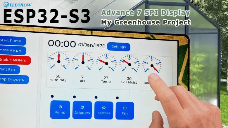

This project is a fully automated AI-powered greenhouse control system built using the Elecrow ESP32-S3 Advance 7" Display Module. It combines real-time environmental monitoring, automated device control, and smart decision-making to maintain optimal conditions for plant growth.
With features like touchscreen control, Wi-Fi connectivity, and modular code design, this system makes it easy to manage your greenhouse from anywhere. It’s a great example of how modern microcontrollers can be used for smart farming and sustainable agriculture.
👉 Watch the full project demonstration here: https://www.youtube.com/watch?v=N3X396OGql4

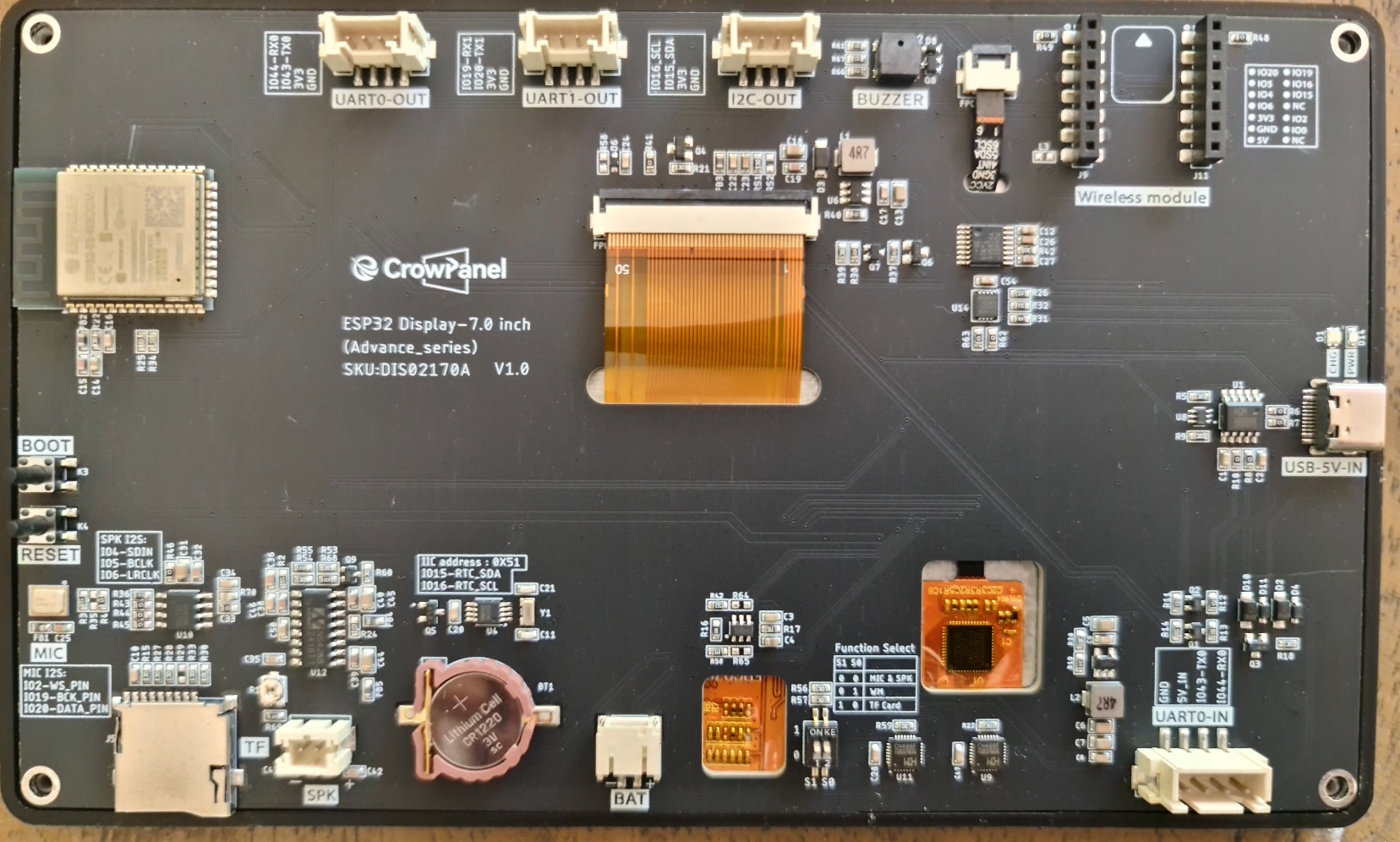

The core of this project is the Elecrow ESP32-S3 Advance 7", a powerful development board featuring:
  • A 7-inch 800x480 capacitive touchscreen
  • ESP32-S3-WROOM-1 with dual-core processor, Wi-Fi, Bluetooth 5.0, and AI acceleration
  • Built-in speaker, microSD slot, USB-C, RGB LED, and buzzer
  • Support for LoRa, LVGL, Arduino IDE, and ESP-IDF
This touchscreen not only displays the system dashboard but also provides direct interaction for controlling greenhouse operations.

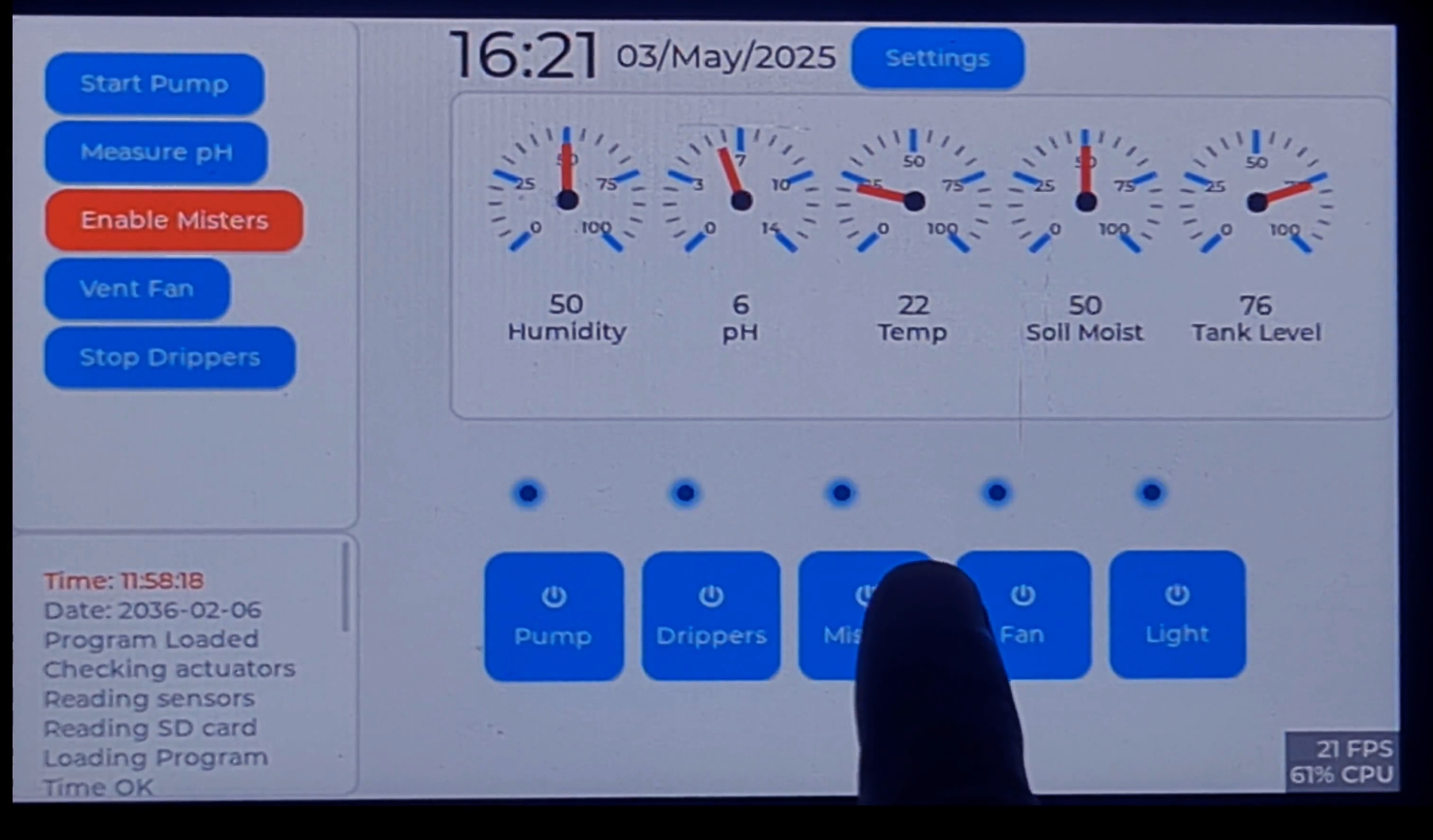

  • Real-Time Monitoring
    The system displays live sensor data for:
    • Air humidity and temperature
    • Soil moisture
    • pH levels
    • Water tank level
  • Automatic Actuator Control
    Based on sensor inputs, it automatically operates:
    • Drip irrigation pump
    • Misters
    • Exhaust fan
    • Grow lights
    • Water refill pump

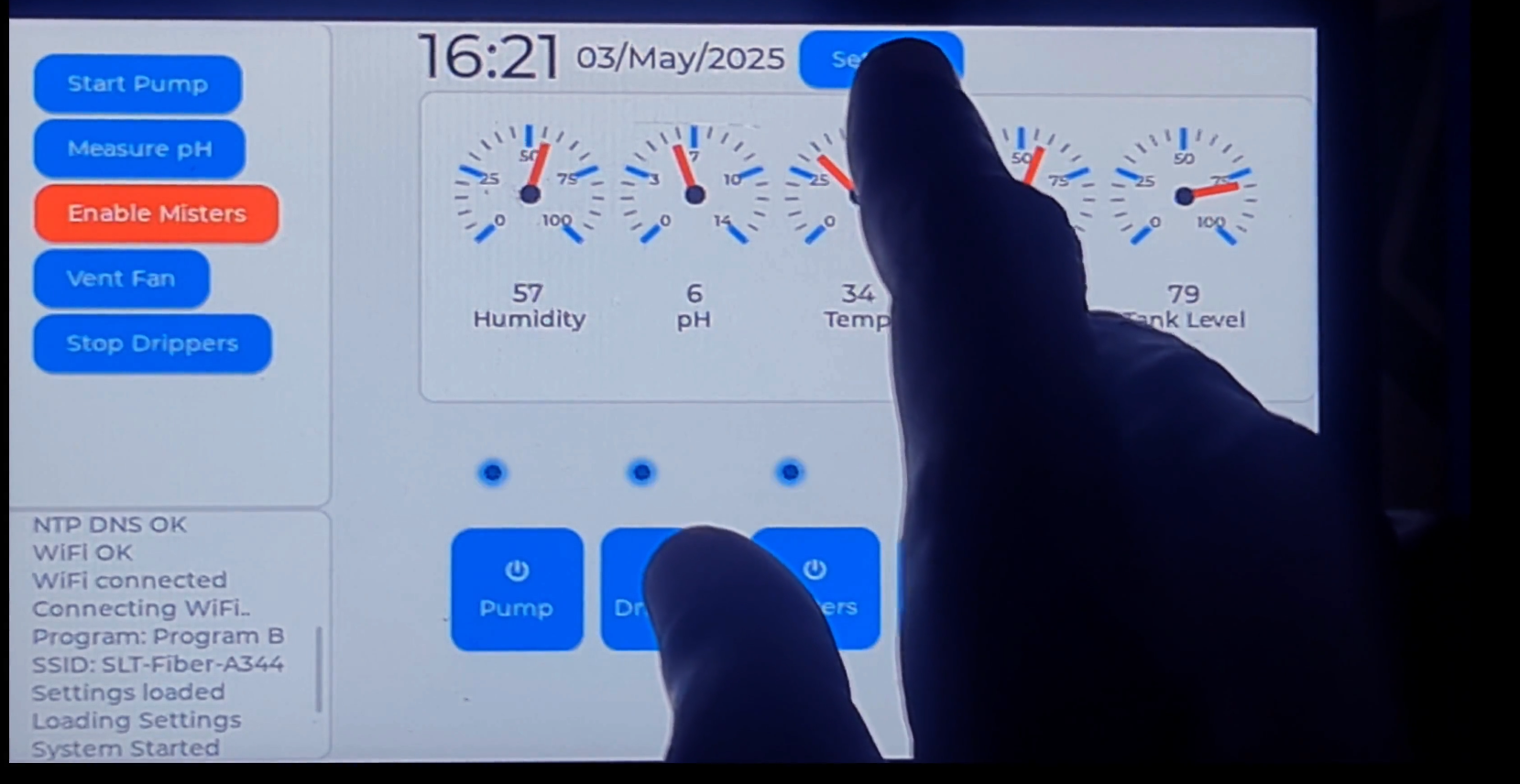

  • Manual Overrides & Touch UI
    Users can override automation and control each actuator directly using the touchscreen.

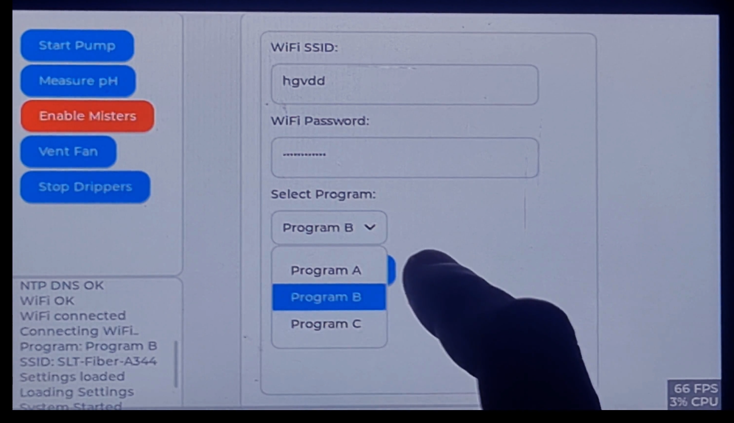

  • Settings Panel
    A full-featured settings screen allows users to:
    • Configure Wi-Fi
    • Switch between auto/manual modes
    • Adjust automation thresholds
    • Save preferences
    • Settings
    • Switch programs

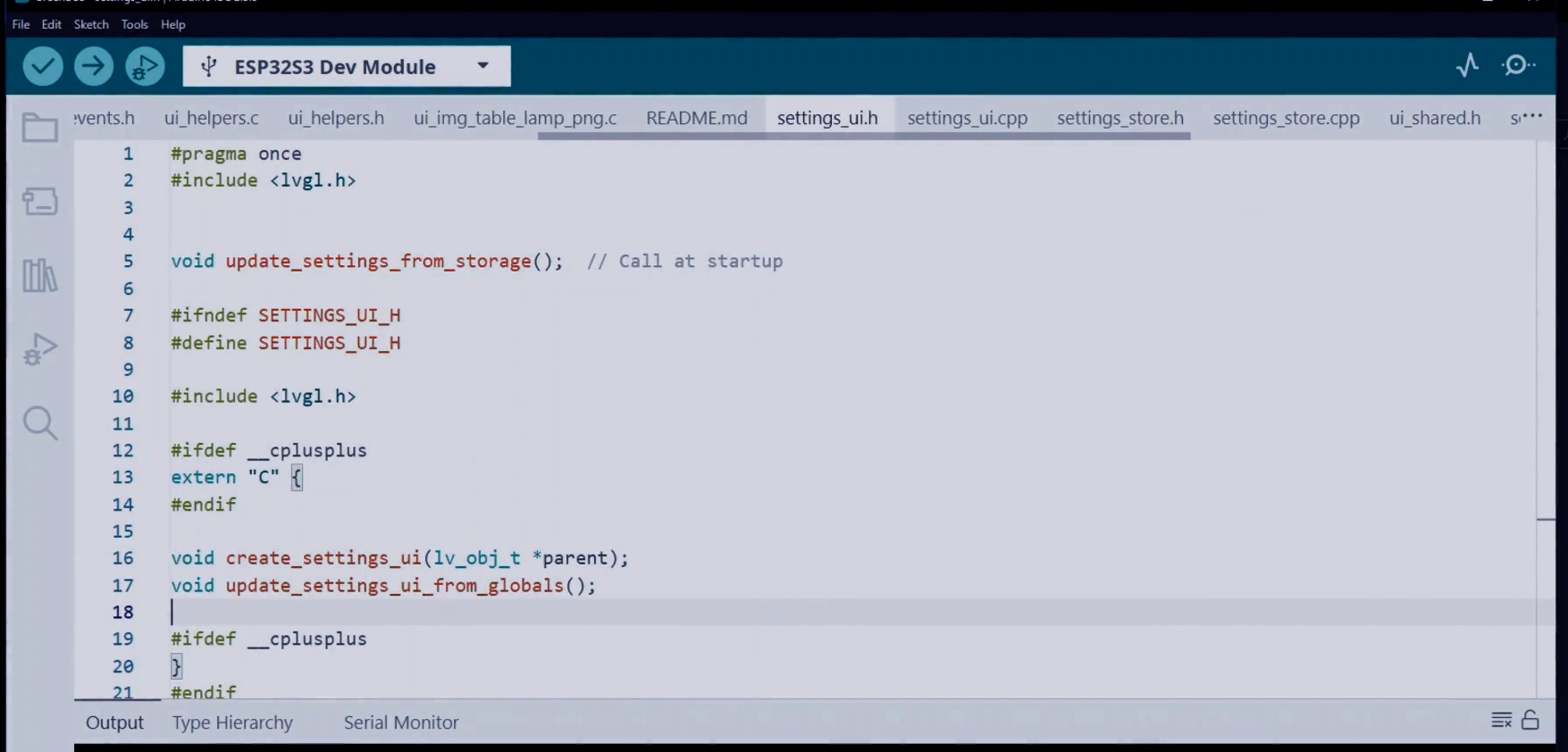

💻 Program and Code
The project is developed using the Arduino IDE, and the UI is built with the LVGL graphics library. The code is cleanly structured in modular files, separating:
  • UI components
  • Sensor handling
  • Automation logic
  • Device control
  • Wi-Fi and settings management
This makes it easy to expand or customize the system for different greenhouse setups.
Program Code
Some highlights of the programming approach include:
  • Event-driven button handling for manual control
  • Periodic sensor updates with data filtering
  • EEPROM or SPIFFS for saving user preferences
  • Use of timers for actuator cooldowns or cycling
  • Planned integration of AI inference for smarter decisions
The code is fully commented and designed with clarity for both beginners and advanced users.
