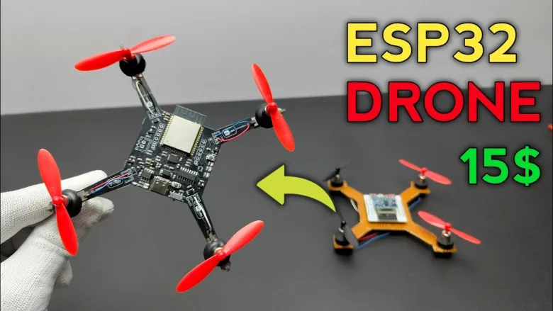

How I started
After understanding the working principle of a quadcopter, I immediately tested it like this I have made a simple frame using a common PCB and connected four motors. Surprisingly, I am able to lift the drone.  But without a controller and gyroscope, it is not possible to fly. So I added an ESP32 and mpu6050 module. MPU6050 can helps to stabilise the drone.  But after adding that, I am not able to lift off the ground.  Because the weight increased due to the extra modules.  To overcome this either we need to either increase the thrust of the motor or decrease the weight. Our goal is to build the cheapest drone, so we can't change the motors. So to decrease the weight, we can remove the separate modules, and we can build a dedicated PCB for the drone. A dedicated PCB solves two issues: it will decrease the total weight, and we can align the motors in perfect orientation and which will increase the stability.

Now I have separated the legs from pcb.  Now let's place the motors on the PCB. I am using 720-type brushed motors for this. To properly mount the motors, I used some rubber grommets. So first, I placed the rubber grommets on the PCB bracket, then placed the four motors.  After placing all the motors, I connected the motors to the PCB. Then I added the separated legs to the PCBS like this.  The final step is to add the propellers. I have tested different-shaped, different propellers, and I got good results with 55mm propellers. So I added the propellers to the motor. You have to care about the propeller direction. You can follow the image below for that.
So that's it, our completed drone looks like this. Now, about the battery, we can use a 3.7 or 3.8 li polymer battery for this drone. But. Make sure the weight is very and the discharge capacity should be a minimum of 25C. The discharge capacity is very crucial; if it is not enough, the drone will not work.
