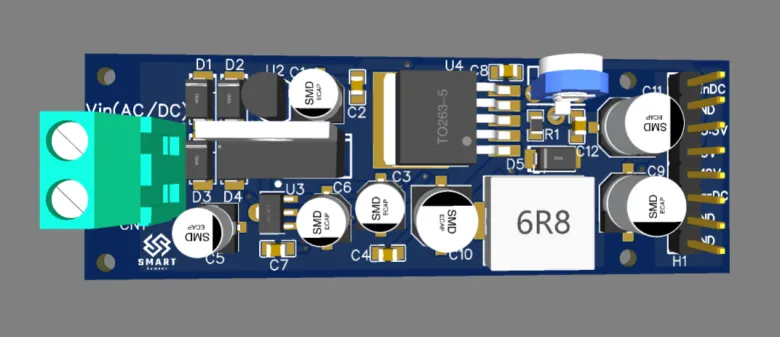

What is this project about?
The Universal Power Supply Board is a versatile solution designed for powering low-power devices such as microcontroller units (MCUs), sensors, and modules. With superior load and line regulation features, it ensures stable and precise voltage outputs, making it an ideal choice for various applications.
How does it work?
The board is capable of accepting a wide range of input voltages, either AC or DC, from 8V to 28V. It efficiently converts the input to provide multiple output voltages, including:
  • Fixed outputs: 3.3V, 5V, 12V
  • Variable DC output: Adjustable for specific requirements
  • Passthrough output: Matches the input voltage
With a load regulation of 60mV and a line regulation of 0.2%/V, the board guarantees minimal fluctuations and high reliability.

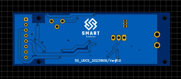

Schematic and Layout
  • Gerber Files
    Gerber_Universal-DC-Supply-Board_PCB_Universal-DC-Supply-Board_2025-01-24_599387566679321318e9a2.zip
