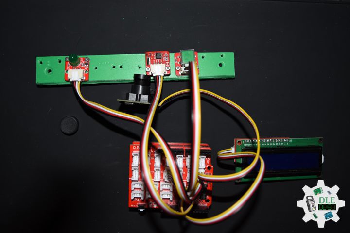

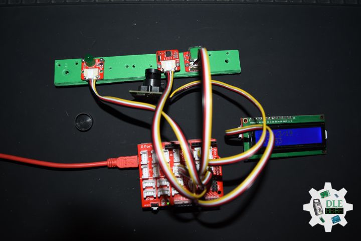

Crowtail - Serial Camera
The Crowtail Serial Camera is a JPEG color camera module easy for PC and MCU use. It has integrated image processing DSP to generate 320 x 240 or 640 x 480 JPEG images without thumbnail information, captured pictures will be stored in the internal buffer and transferred via UART port. The UART Can be configured to TTL or CMOS by hardware.
-Crowtail interface
-Default baud rate of the serial port is 38400
-640 x 480 or 320 x 240 resolution
-JPEG compressed image without Thumbnail Information
-5 Volt power supply

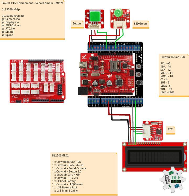

DL2503Mk02
1 x Crowduino Uno - SD
1 x Crowtail - Base Shield
1 x Crowtail - Serial Camera
1 x Crowtail - Button 2.0
1 x MicroSD Card 4 Gb
1 x Crowtail - RTC 2.0
1 x CR1220 Battery
1 x Crowtail - LED(Green)
1 x USB Battery Pack
1 x USB Mini-B Cable
Crowduino Uno - SD
SCL - A5
SDA - A4
SCK - 12
MISO - 11
MOSI - 10
CS - 4
BUT - 9
LEDG - 6
VIN - +5V
GND - GND
DL2503Mk02p
DL2503Mk02p.ino
getCamera.ino
getDisplay.ino
getEEPROM.ino
getRTC.ino
getSD.ino
setup.ino
