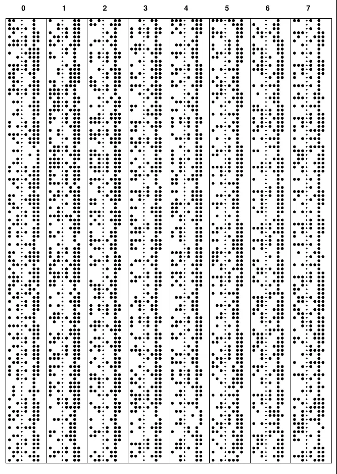

Punch tape patterns to PDF Gallery
Punched paper tape can be decorative, so this script can create PDFs full of them.
Anticipating the boards for my paper tape reader PCBs (https://hackaday.com/2022/04/16/paper-tape-reader-self-calibrates-speaks-usb/), I created a python script printing punched holes on paper.
Still have to cut the paper sheet to inch-wide strips and tape then together.
The reader firmware promises it can work in reverse mode, so I can test with these 'printed' holes and don't have to build a paper tape punch to test the reader.
The script is based on the FPDF library (http://www.fpdf.org/).
python3 punch2pdf.py punch2pdf.py
Produces the script in PDF paper tape format.
The script is functional, but not properly refactored. It currently prints 8 bits, no parity. 7-bit with parity might be a cool feature.
The page size is hard coded A4.
