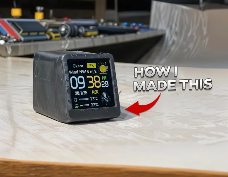

The Portable Mini Weather Station is a compact and versatile device designed to provide real-time weather updates, temperature readings, and other atmospheric details. Built with an ESP12F microcontroller and a 1.5" TFT display, this project combines modern technology with sleek design. The station fetches weather data directly from OpenWeatherMap, ensuring accurate and up-to-date information.
What sets this weather station apart is its web configuration portal, allowing users to personalize their settings effortlessly. Whether adjusting the Wi-Fi credentials, city code, UTC time offset, display brightness, or weather update interval, everything can be configured and saved in the ESP12F's EEPROM memory for persistent use.
Key Features:
  1. Portable Design: A compact and lightweight weather station powered by ESP12F, making it easy to carry and use anywhere.
  2. 1.5” TFT Display: A bright and colorful screen displays real-time weather, temperature, wind speed, and direction in an easy-to-read format.
  3. Web Portal for Configuration: Users can configure Wi-Fi settings, city codes, UTC time, brightness, and weather update intervals via a user-friendly web portal.
  4. EEPROM Data Storage: Configuration settings are saved to the ESP12F’s EEPROM, ensuring data retention even after power cycles.
  5. Real-Time Weather Updates: Fetches data using OpenWeatherMap API, including temperature, humidity, wind speed/direction, and weather conditions.
  6. Customizable Display: Brightness, city-specific data, and update intervals can be adjusted for user preference.
  7. Modern Aesthetic: Enclosed in a 3D-printed, stylish casing that blends functionality with beauty.
