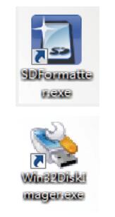

Step 2. Download and install the burning tool
Download SD Card Formatting Tool (SDFormatter 5.0.1) Link: https://www.sdcard.org/downloads/formatter_4/
Download System Burning Tool (Win32DiskImager) Link: https://sourceforge.net/projects/win32diskimager/

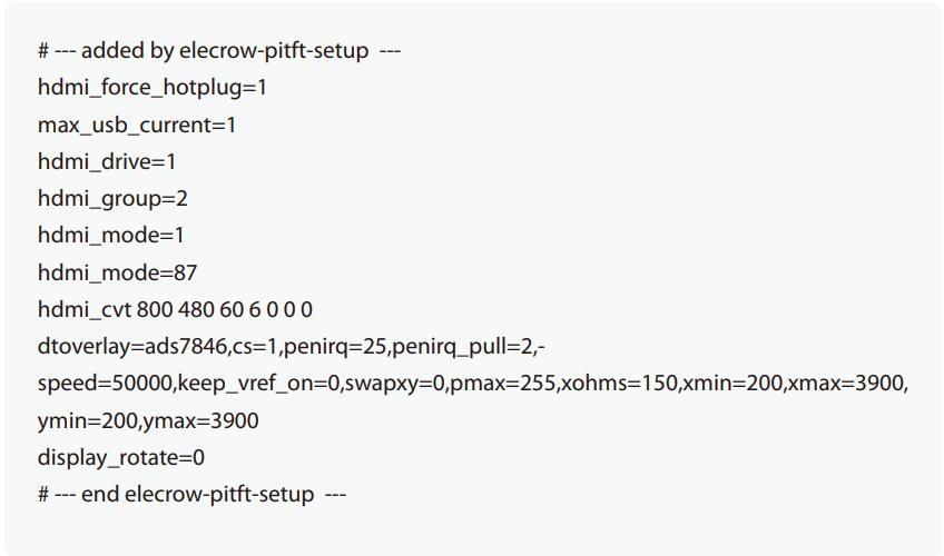

Step 5. Modify the “config.txt”
Open the config.txt file of SD card root directory and add the following code at the end of the file, save and eject SD card safely:
