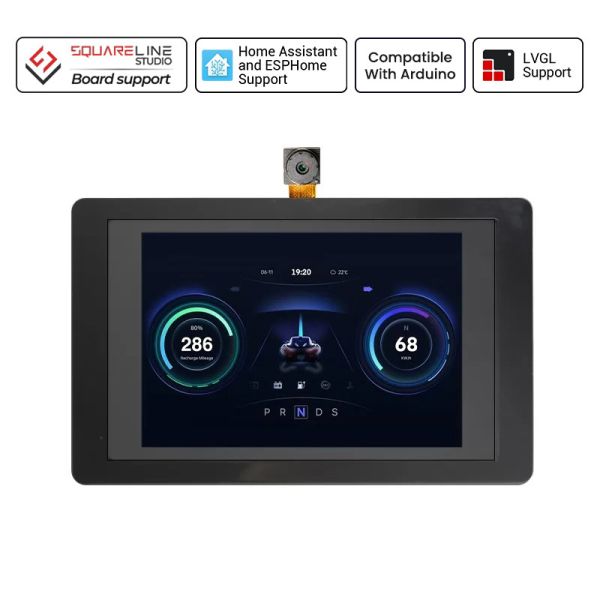

[ESP32 3.5" terminal] 3.5-inch parallel SPI TFT-LCD with 320*480 resolution and OV2640 camera, integrated ESP32-S3 module, supports 2.4 GHz Wi-Fi and Bluetooth-compatible 5 (LE);
[Wide Compatibility] Compatible with Arduino/LVGL/PlatformIO/Micropython. Mature software support, support ESP-IDF and Arduino IDE development, and LVGL;
[Crowtail interfaces, plug and play] With 4 Crowtail interfaces (HY2.0-4P connector), plug and play with various Crowtail sensors. [❤️What you get] 24H Friendly Customer Service and 1 Year warranty.1x ESP32 3.5" Terminnal,1x USB-C Cable, rich wiki.

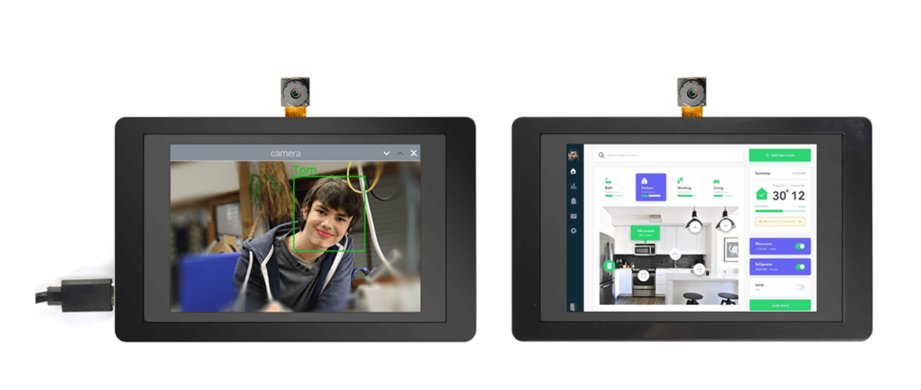

  • As a smart home central control screen, it can perform video surveillance and face recognition, allowing you to keep abreast of home dynamics.

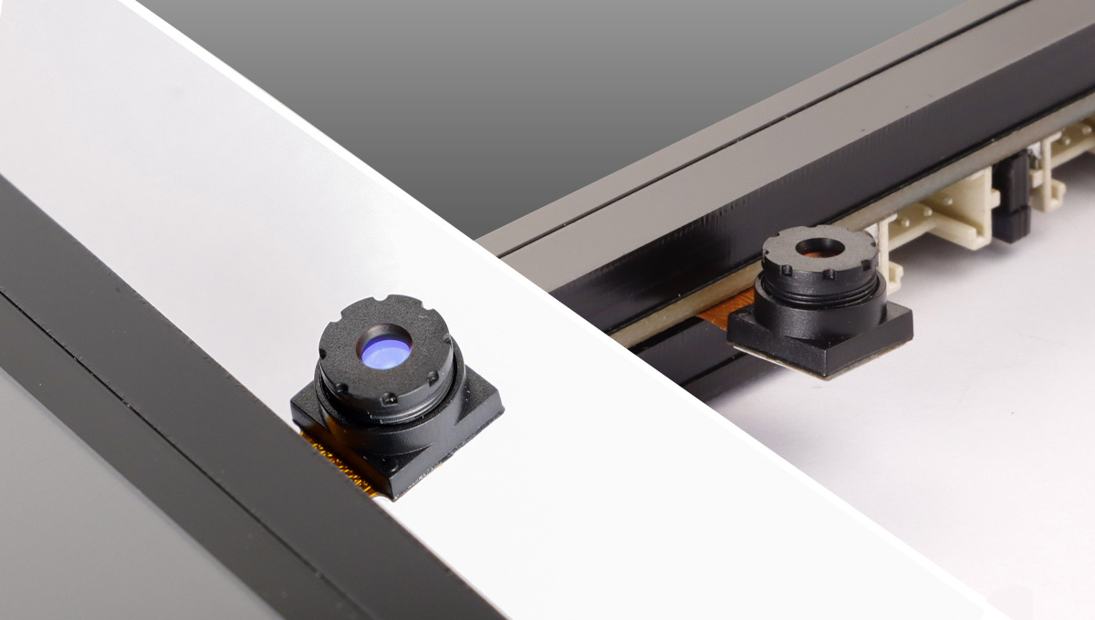

ESP32-S3 camera module application
ESP32 S3 3.5inch Terminal with OV2640 camera

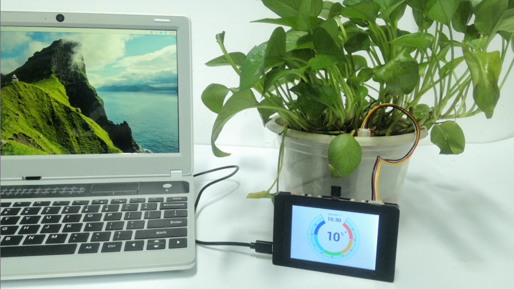

Connect with Crowtail Sensors
It can be connected with 150+ types of Crowtail modules to complete more interesting projects.
ESP SPI Terminal connets with sensor ESP32 3.5inch terminal uses the OV2640 camera

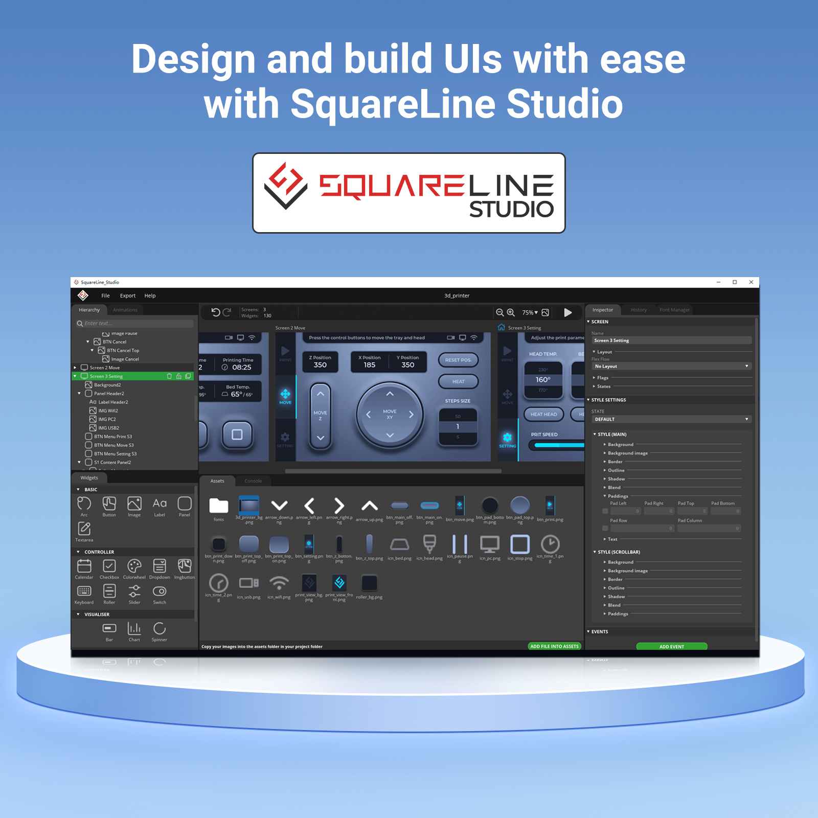

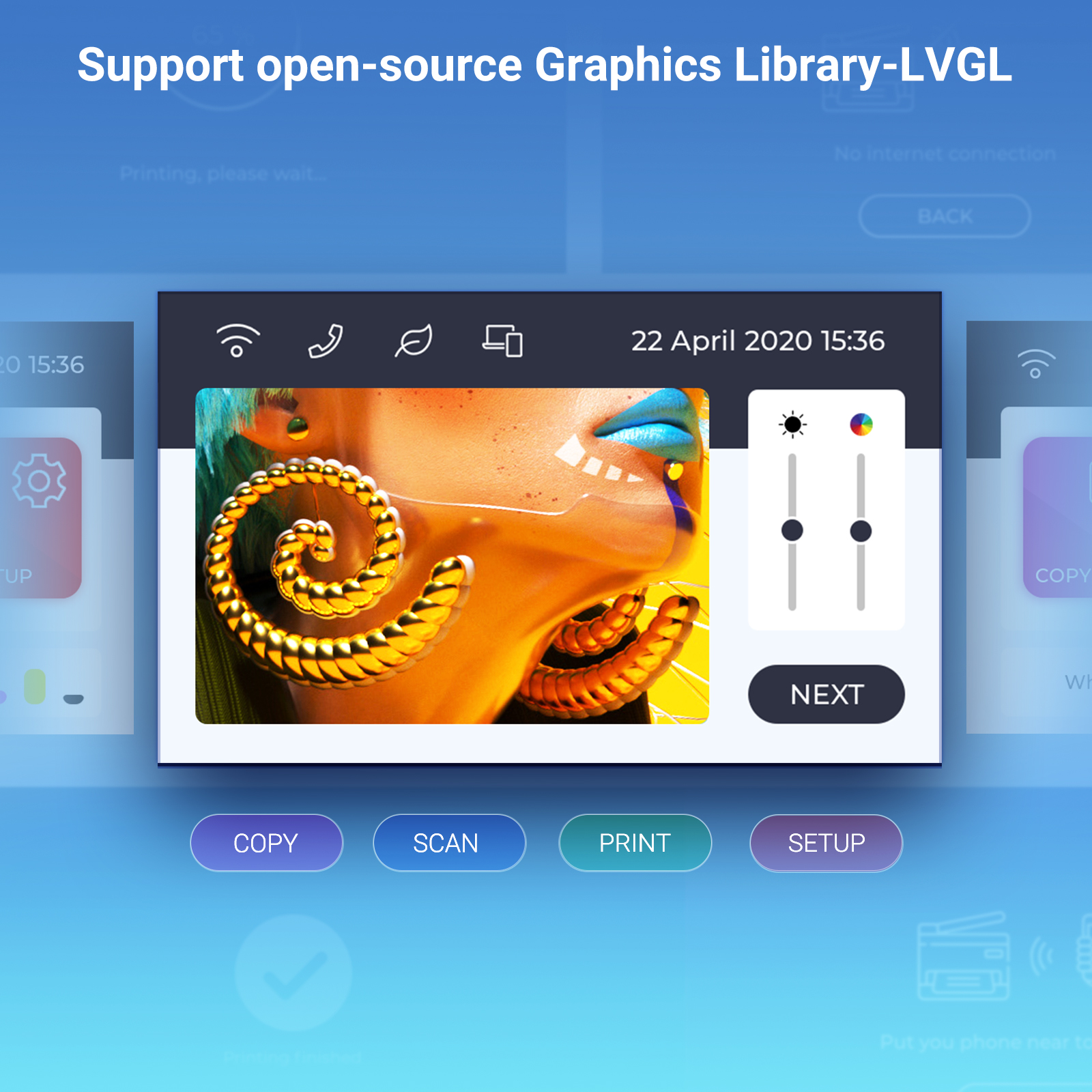

It supports LVGL graphics library. You can design a variety of UIs.
ESPs3 camera 3.5inch module support LVGL
Design and build UIs with ease with SquareLine Studio
Use SquareLine Studios to design and implement your own LVGL UI and export ready to use projects with one click.
Squareline Vision has entered BETA, sign up now to get 40% off all licenses. https://vision.squareline.io/
ESPs3 camera module support squareline studio

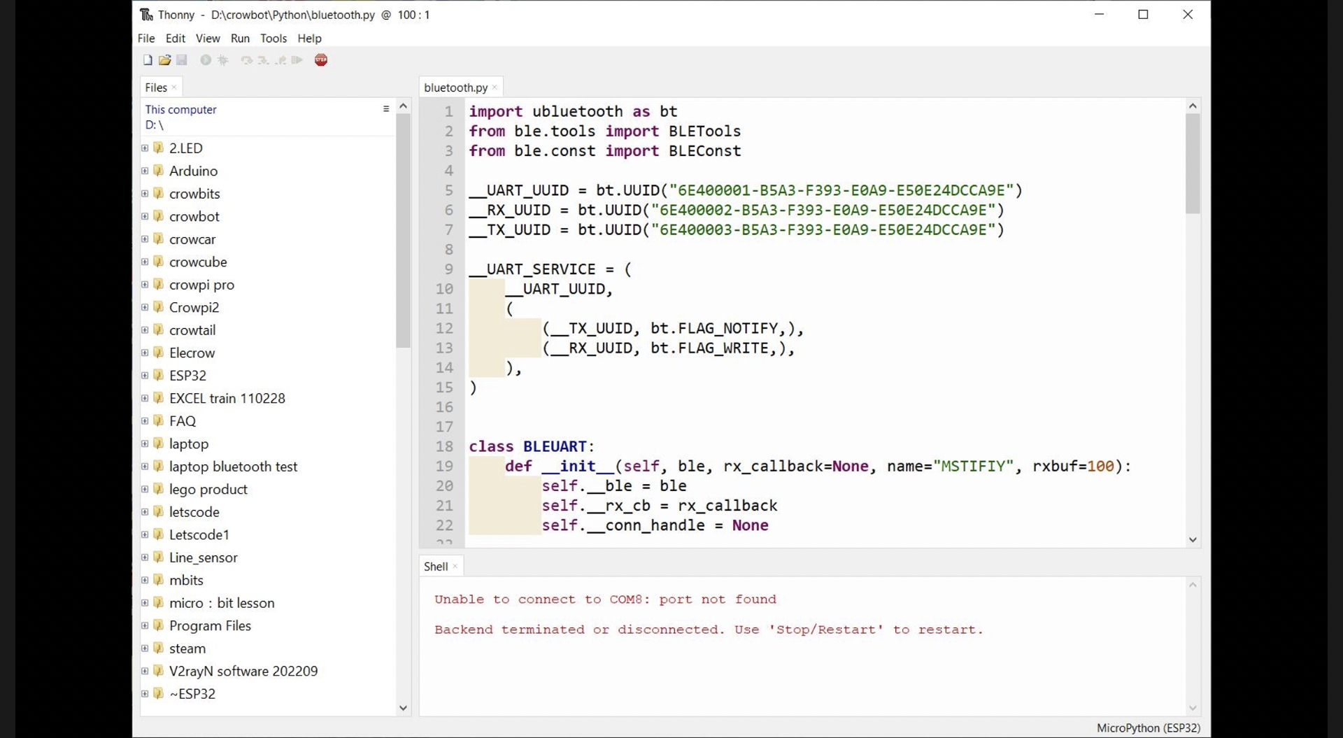

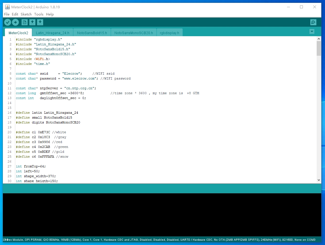

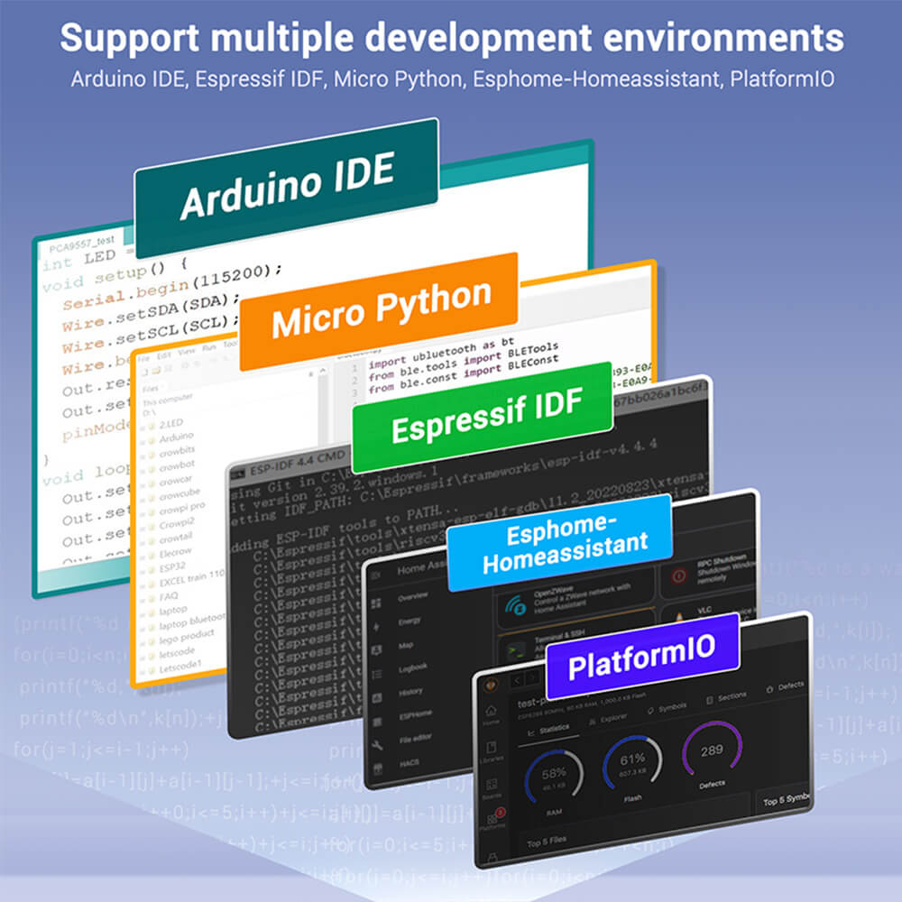

Programming Environment Support
It supports programming with VS Code, Arduino IDE, Espressif IDF, Esphome, and PlatformIO. Different projects can be easily developed.
ESP32 s3 cam module supports multiple programming

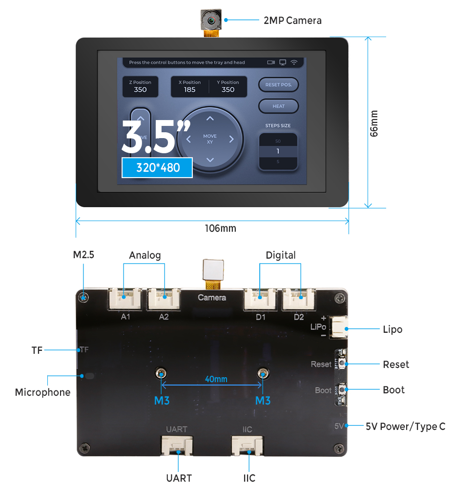

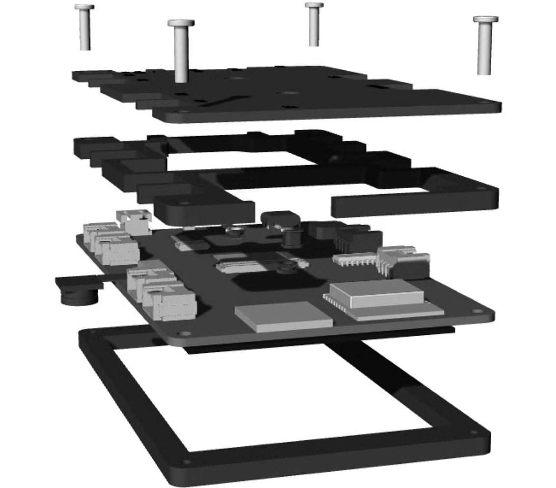

Structure Overview
ESP32 s3 cam module structure
ESP SPI Screen Hardware Overview
Interface overview of ESP32 S3 Cam touch module
  • RESET button. Press this button to reset the system.
  • LiPo port. Lithium battery charging interface (lithium battery not included)
  • BOOT button. Hold down the Boot button and press the RESET button to initiate firmware download mode. Users can download firmware through the serial port
  • 5V Power/Type C interface. It serves as the power supply for the development board and the communication interface between the PC and ESP-WROOM-32.
  • 6 Crowtail interfaces (2*Analog,2*Digital,1*UART,1*IIC). Users can program the ESP32-S3 to communicate with peripherals connected to the Crowtail interface.
  • Integrated ESP32-S3 module, which supports 2.4 GHz Wi-Fi and Bluetooth-compatible 5 (LE)
  • 3.5 inch TFT 320*480 resolution touch LCD display with 2M Pixel OV2640 camera
  • Support USB, UART, SPI, I2C, PWM, and I2S communication protocols
  • Supports 1T1R mode, data rate up to 150 Mbps, Wireless Multimedia (WMM)
  • Compatible with Arduino/LVGL/Esphome-homeassistant/PlatformIO/Micropython
  • Supports hardware accelerated encryption (AES, SHA2, ECC, RSA-4096)
  • Support TYPE-C USB power supply and polymer lithium battery power supply with 6 Crowtail interfaces (4P 2.0 connector), plug and play with various Crowtail sensors
