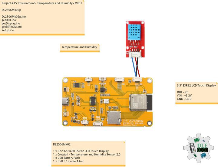

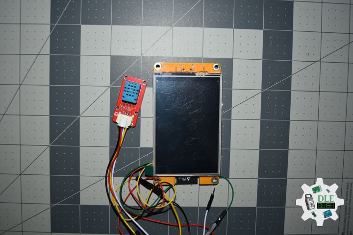

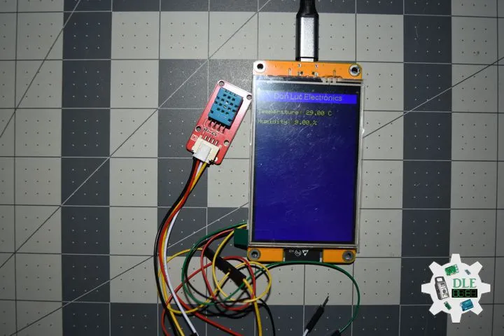

3.5” 320x480 ESP32 LCD Touch Display
This 3.5“ display is a high-performance development module integrates the ESP32 WROOM 32E module. It has powerful development capabilities and rich resources, providing great convenience for developers. It is equipped with a 3.5-inch screen with a resolution of 320 x 480 and supports rich color display of up to 262K colors (RGB666), ensuring clear images and bright colors. The module provides a variety of interfaces, including SPI, UART, etc., which are convenient for connecting various peripherals to meet diverse development needs.
In addition, it supports external speakers to play audio, has its own RGB three-color indicator for rich status indication, and is also equipped with a resistive touch screen for convenient human-computer interaction. It uses a standard TYPE-C interface to facilitate program downloads and power supply, and comes with a micro TF card slot for easy expansion of storage space. It supports external lithium batteries, is lightweight and portable, and has a built-in battery charging management circuit to ensure safe battery charging and discharging. We also provide a wealth of sample programs and technical support to help developers get started quickly. It is suitable for smart home, industrial control and maker projects.
Crowtail - Temperature and Humidity Sensor 2.0
This module can help you detect the temperature and humidity of the environment of your house. The module contains a DHT11 temperature and humidity sensor that is a complex sensor with a calibrated digital signal out. It uses digital module acquisition technology and the temperature and humidity sensor technology. The sensor consists of a resistance-type moisture element and an NTC temperature measuring element. Because of the single-wire serial interface, it is easy to use the module.
DL2506Mk02
1 x 3.5” 320x480 ESP32 LCD Touch Display
1 x Crowtail - Temperature and Humidity Sensor 2.0
1 x USB Battery Pack
1 x USB 3.1 Cable A to C
3.5” ESP32 LCD Touch Display
DHT - 25
VIN - +3.3V
GND - GND
DL2506Mk02p
DL2506Mk02p.ino
getDHT.ino
getDisplay.ino
getEEPROM.ino
setup.ino
