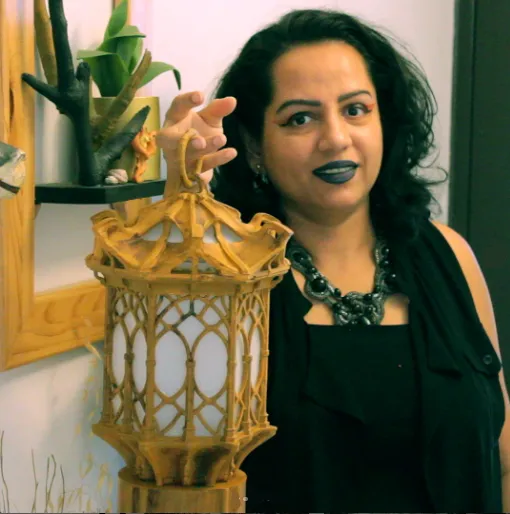

Demo
So, this is how my final setup looks like.
The red glow inside the lantern (bit hard to see in the bright sunlight), indicates that the battery is charging.
Press the push button switch from the base of the lantern to turn it on or off.
Do comment, and let me know if there are any scopes of improvement.
