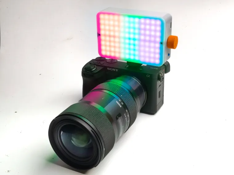

3D printed 20W RGB Portable Video Light
This small 20W RGB video light can be fully 3D printed and is very simple to operate. You can switch on the light by pressing the button on the side once. By rotating the encoder, we can cycle through the hue value. After pushing the encoder, we can switch to the brightness control mode. We can adjust the brightness of the LED by rotating the encoder. If we push the encoder button again, we can switch back to the hue control mode. It's a one-knob operation.

Apart from being a maker, I am also a videographer. So I needed an RGB video light. What I needed was an RGB light that was small, portable, magnetically attached to any metal surface, and could also accommodate accessories such as grids, diffusers, etc. but the lights with the kind of features I meant were costly. So I figured I could make one for a third of the cost. These requirements brought me to this project
Additionally, I included a magnetically attachable diffuser for softening the LED light, and we can also attach a honeycomb grid on top of it to reduce the light spill. I included a 1/4-inch thread on the bottom to attach to a camera to make it easier to mount this light. I also added a powerful magnet on the back so you can easily attach it to any metallic surface. It is powered by a 5000mah battery which can run up to 2-3 hours. It is also rechargeable via USB-C. Battery status can be checked using the 4 LEDs on the back of the light. Now let's see how to build one yourself

    We can use the 1/4-inch thread on the bottom to mount it to a light stand or any other tripod. Additionally, if you need to mount it to a camera with a hot-shoe mount, we can use a 1/4" Flash Hot Shoe Screw Adapter.
