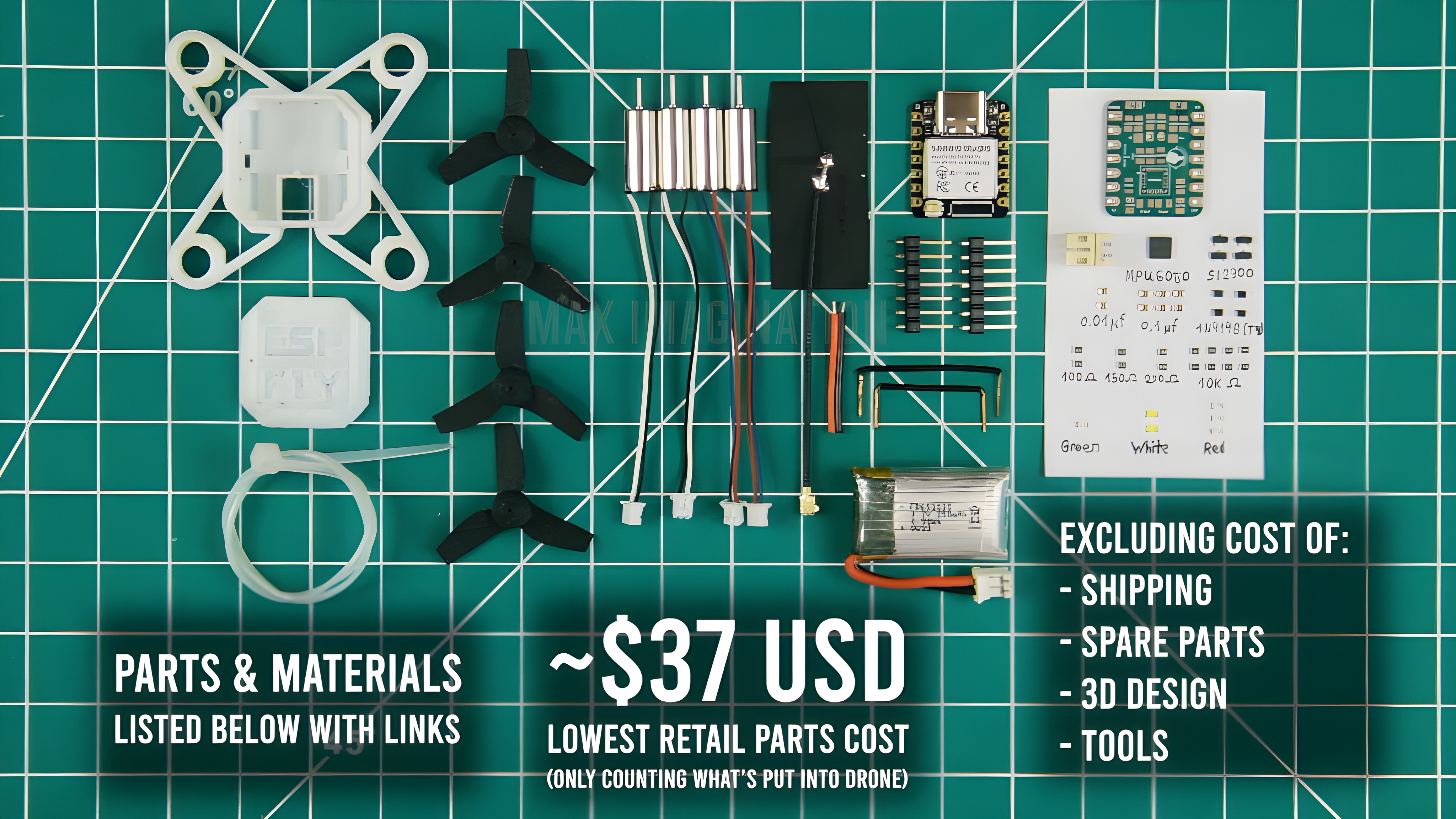

1. Gathering Parts and Resources
To bring the ESP-FLY to life, you’ll need a lightweight frame, coreless motors, a custom PCB, an ESP32-S3 microcontroller, an inertial measurement unit (IMU), MOSFETs for the motor driver, and more.
Here’s the full parts list with links:
(x1) Seeed Studio XIAO ESP32-S3 - 10% OFF | Code: MaxImagination (valid until April 12):
On Seeed Studio Official Website: https://www.seeedstudio.com/XIAO-ESP32S3-p-5627.html?utm_source=youtube&utm_medium=MaxImagination&utm_campaign=ESP32drone ($7.49)
On Amazon: https://amzn.to/4byrbve
On AliExpress: https://s.click.aliexpress.com/e/_ok4s5cv
(x1) MPU6050 IC - https://amzn.to/4gJoGY1 ($4.40)
(x4) SI2300 N-MOSFET - https://amzn.to/42XAFhq ($0.55)
(x4) 1N4148 Switching Diode - https://amzn.to/4k2RDBa ($0.08)
Resistors - 0805 SMD (From Kit): https://amzn.to/3X3Mi2l ($0.10)
(x9) 10KΩ
(x2) 200Ω
(x2) 150Ω
(x2) 100Ω
Capacitors - 0805 SMD (From Kit): https://amzn.to/41i0lUJ ($0.09)
(x6) 0.1μF
(x2) 0.01μF
LEDs - 0805 SMD (From Kit): https://amzn.to/41zA9nl ($0.30)
(x3) Red
(x2) White
(x1) Green
(x1) 90° JST Power Connector - https://amzn.to/3X06ges
($0.18) (x4) Micro Coreless Motors - https://amzn.to/3EDFUZD ($10.99)
(x1) 150-250mAh LiPo Battery - https://amzn.to/4bS8YZB / https://www.seeedstudio.com/Crazyflie-Nano-Quadcopter-Spare-battery-BC-BL-01-p-1362.html ($9.99 avg)
(x4) Propeller - https://amzn.to/4i0U0Ct ($2.50)
(x1) Small Zip-tie - https://amzn.to/4gMhQRv ($0.04)
Solid core jumper wires - https://amzn.to/41PWBtG ($0.10)
4g of 3D printed filament for frame/enclosure - https://amzn.to/4izYf8l ($0.07)
(x1 of 5) PCB made by JLCPCB - ($0.42) https://jlcpcb.com/?from=MaxImagination
Total cost of the above parts excluding cost of shipping, spare parts, 3D model, and tools you may need: $37.30 USD (+- $10)
It’s the lowest retail parts cost - only counting what is put into the drone.

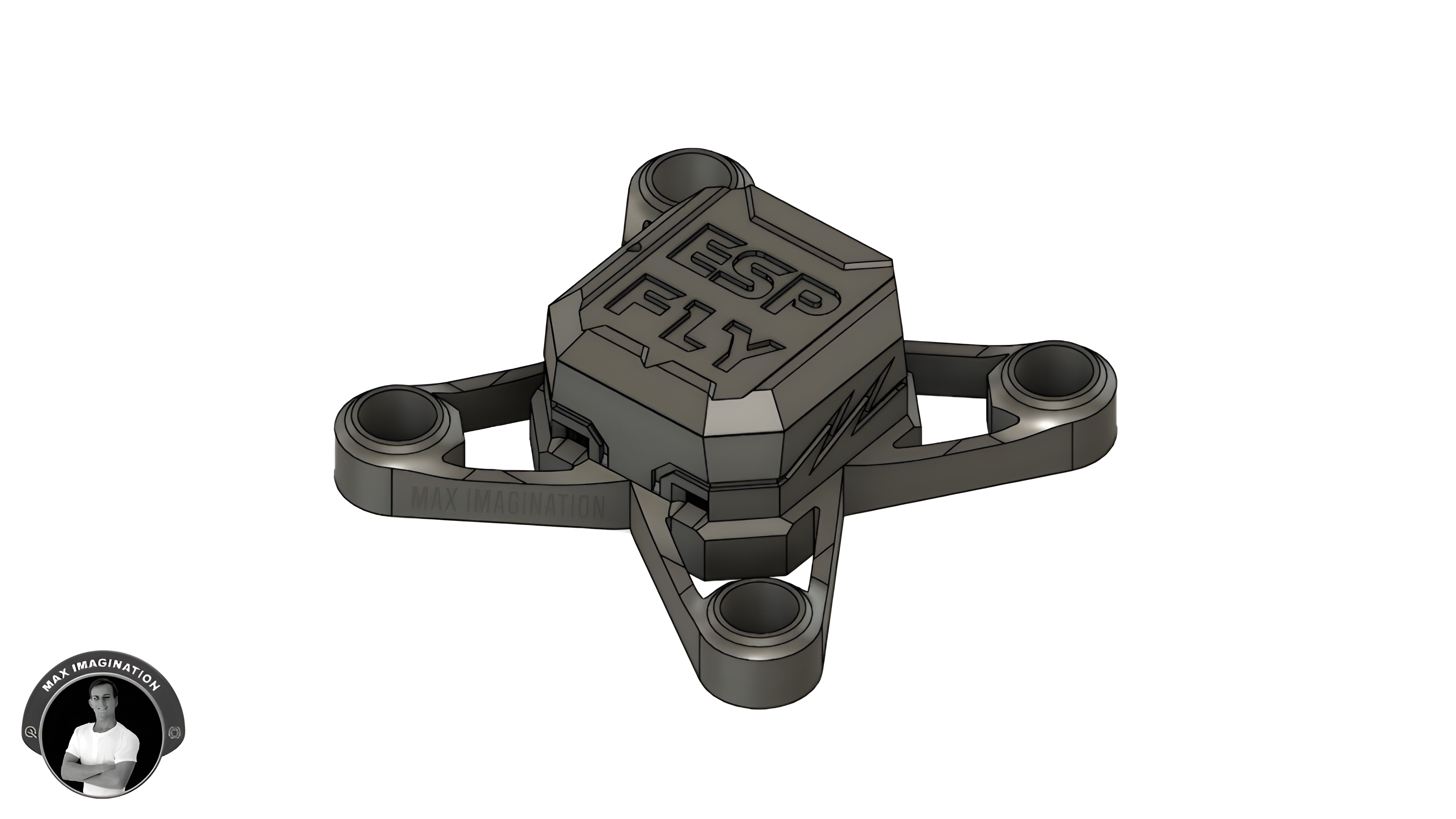

2. Designing the Drone Frame
Using my go-to CAD software - Autodesk Fusion, I modeled the 50mm quadcopter frame with basic aerodynamics in mind.
The design features a closed body, two-prong motor arms, and an engraved top cover with an optional cover containing an FPV camera mount for first-person-view flying.
Purchase the STL files from Cults 3D and use the recommended 3D print settings listed there:
https://cults3d.com/en/3d-model/gadget/esp-fly-an-esp32-micro-drone-body-frame-3d-design-stl-files

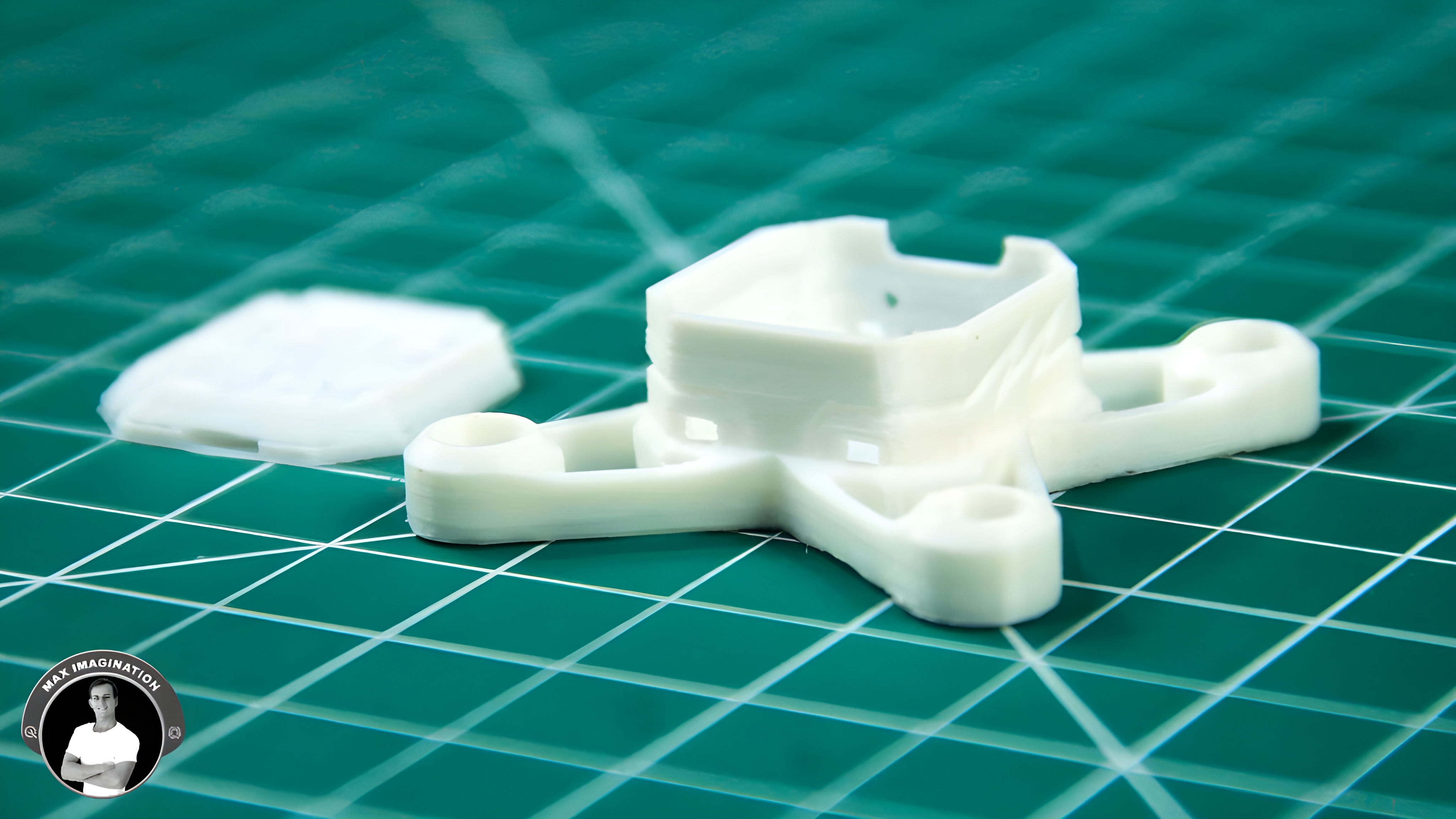

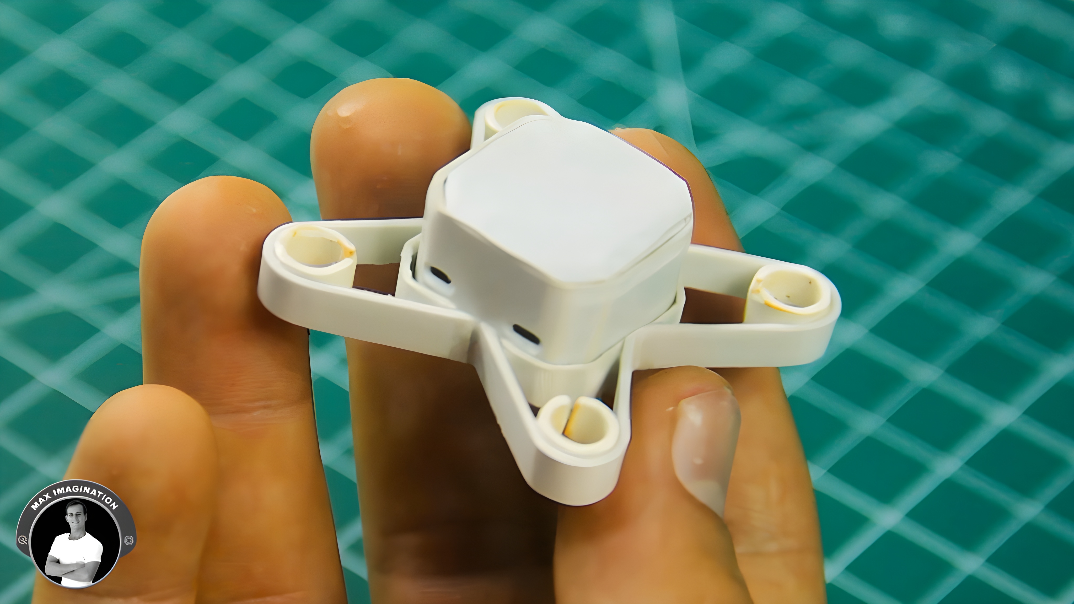

3. 3D Printing the Frame
While the printer heats up, import the three parts into your slicer, position them, and apply the recommended print settings:
Layer Height: 0.12mm
Infill Density: 10%
Support: Yes
Speed: 100mm/s
Nozzle Temp: 220°
Build Plate/Bed Temp: 60°
Cooling: Yes
Additional info: ⬇️
Print Material: ePLA (1.75 mm): https://amzn.to/4izYf8l
PLA material cost (~5g) : $0.1 USD
3D printed parts weight: ~5g including alternate covers
I used an Elegoo Neptune 4 Plus for its speed and high-quality prints - completing the frame in just 30 minutes!

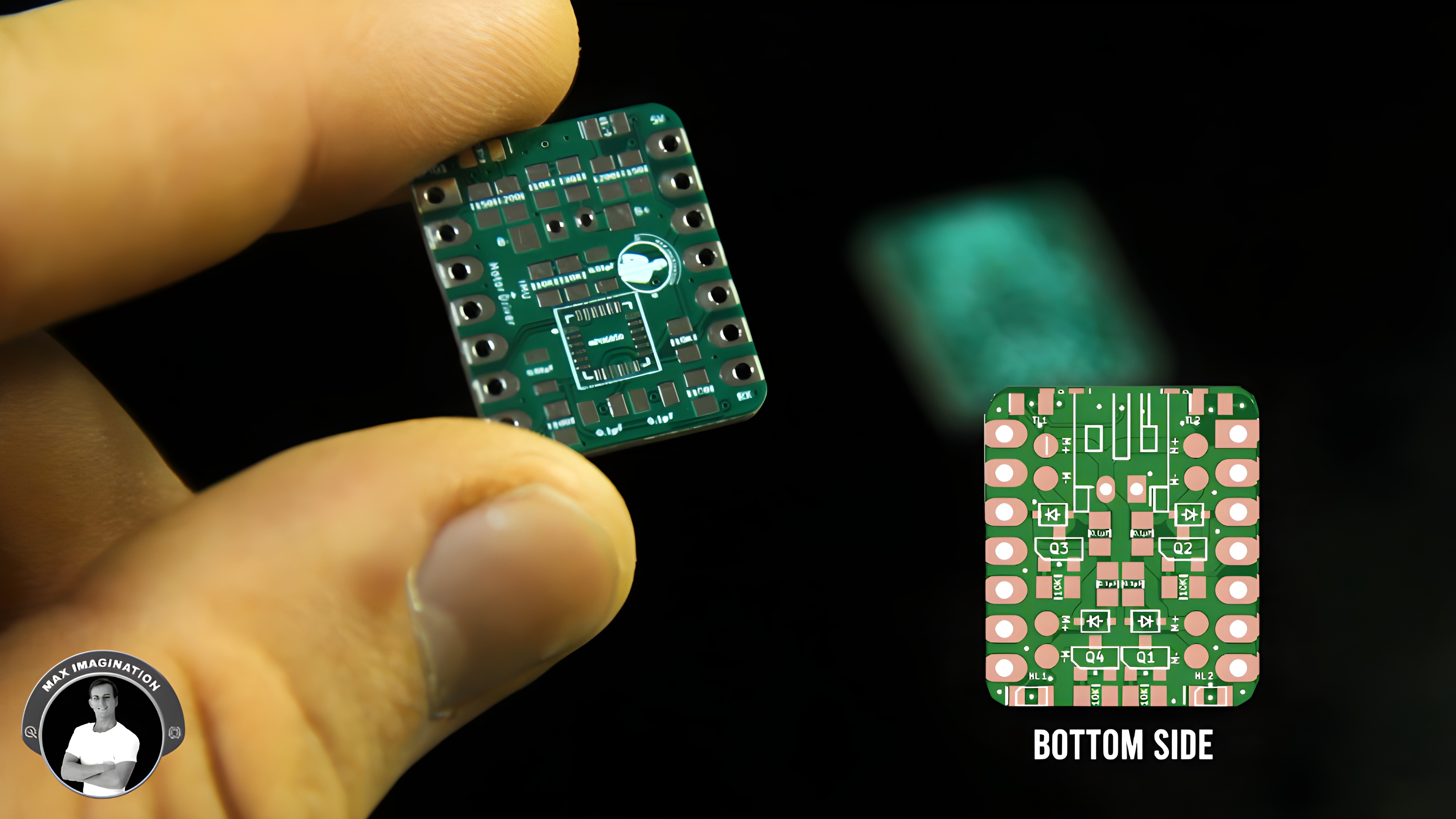

5. Designing & Ordering the PCB
Using Flux PCB design software, I integrated the motion sensor, motor drivers, and LED indicators into a compact 4-layer PCB.
Upload the Gerber file to JLCPCB and select your board specs:
Set the layers to 4, choose your desired quantity, select 1.2mm thickness, and pick a board color - green is the fastest and most cost-effective option. Don’t forget to select "Remove Mark", and that’s it! Add it to your cart, choose shipping and payment options, and place your order - it’s as simple as online shopping.
JLCPCB offers high-quality PCBs as low as $2! https://jlcpcb.com/?from=MaxImagination
6. PCB Assembly - Soldering Components
Using an SMD stencil ordered along with the PCBs, apply solder paste to one side of the PCB, then place resistors, capacitors, indicator LEDs, and the MPU6050 IMU for the top side which is reflow soldered using a hot plate. For the motor driver side, add some solder paste to those pads, hand-solder the components such as the resistors, diodes, capacitors, MOSFETs, and JST battery connector.
When it comes to placing the MPU6050 motion tracking IC, it’s crucial you align the dot on the chip with the dot on the PCB for correct orientation. The chip and other SMD components can be bought in tape reels or salvaged from modules and other boards.

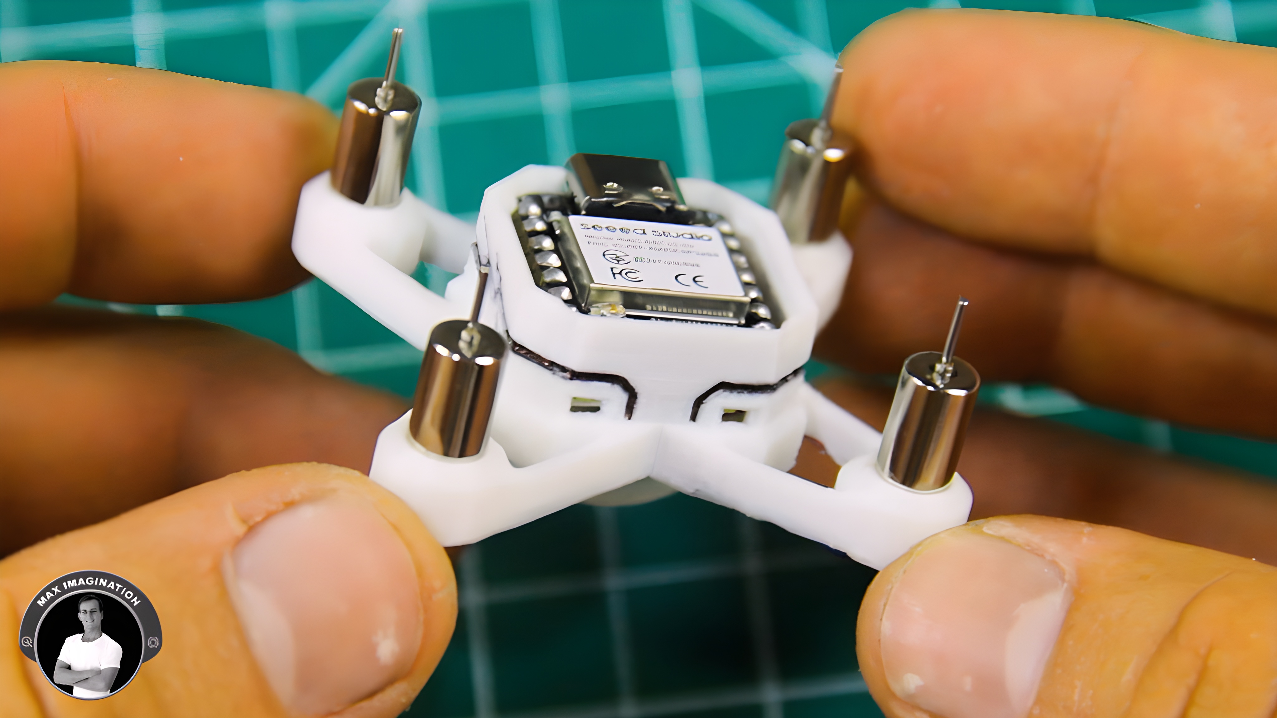

With the IMU or Inertial Measurement Unit + motor driver module complete, it weighs only one gram (1g)!
7. Installing the ESP32 Flight Controller
Now that the IMU/motor driver module is assembled, it’s time to give the quadcopter its brain.
Seeed Studio’s XIAO ESP32-S3: https://www.seeedstudio.com/XIAO-ESP32S3-p-5627.html?utm_source=youtube&utm_medium=MaxImagination&utm_campaign=ESP32drone
Mount the microcontroller onto the custom module with orientation in mind using short wires to bridge battery lines and pin headers for connecting the board’s pins.
This tiny yet powerful board handles low-latency (7-25ms), WiFi-based control and direct battery charging via USB-C, making it perfect for micro drones.

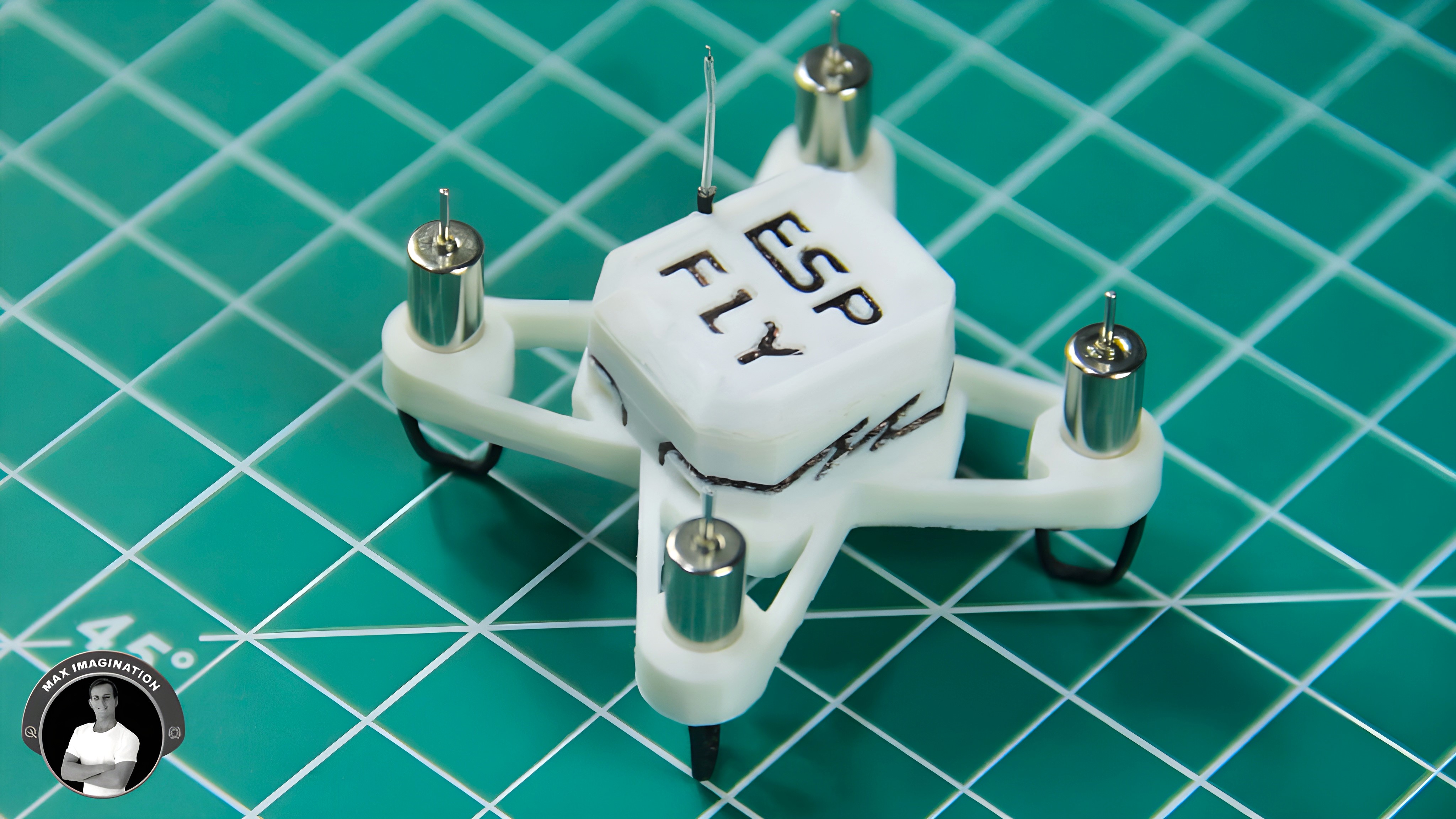

8. Main Assembly
To make it stand out, you may color the debossed areas with a pen such as the drone’s name, decorative details, and branding.

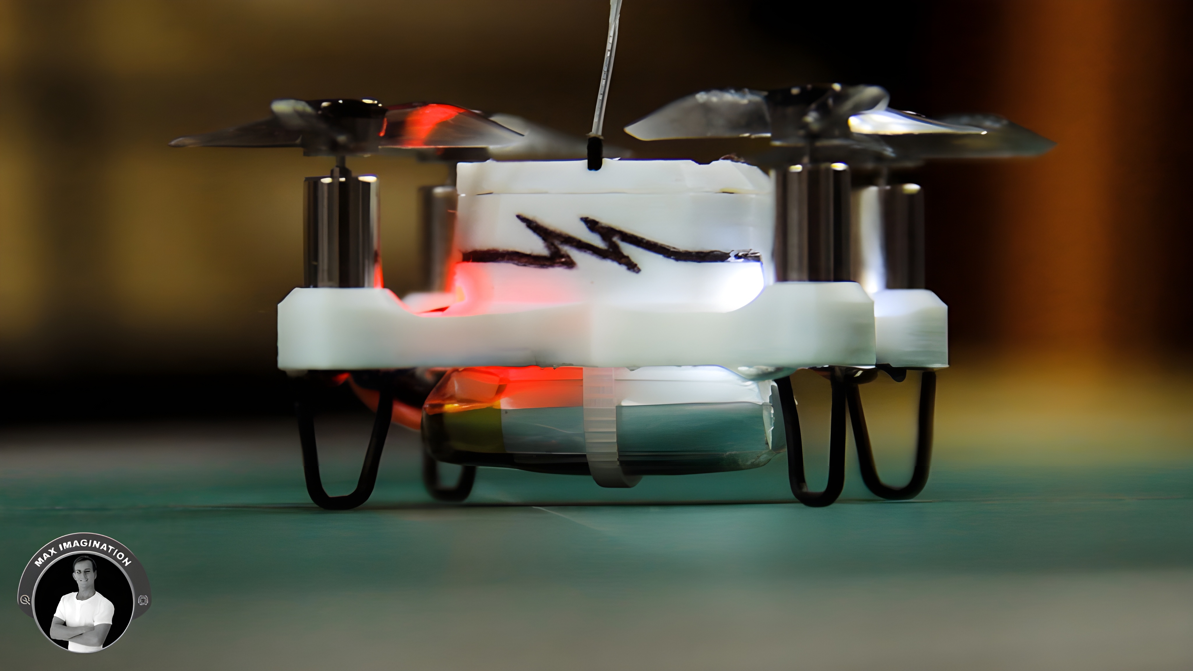

Secure the flight controller inside the frame, add a zip-tie battery strap, and insert the 6x15mm coreless motors into the arms. When you buy these motors, check you get two clockwise (CW) and two counter-clockwise (CCW) motors which can be told apart by wire color. This is crucial because each motor needs to rotate in a specific direction, requiring some to have reversed brushes to ensure proper operation and minimize wear.
Route and solder the motor wires, ensuring the correct CW and CCW motor order:
  • Front Right = CCW (Black & White wires)
  • Rear Right = CW (Blue & Red wires)
  • Rear Left = CCW (Black & White wires)
  • Front Left = CW (Blue & Red wires)
Use a tiny amount of superglue to fix the motors in place.

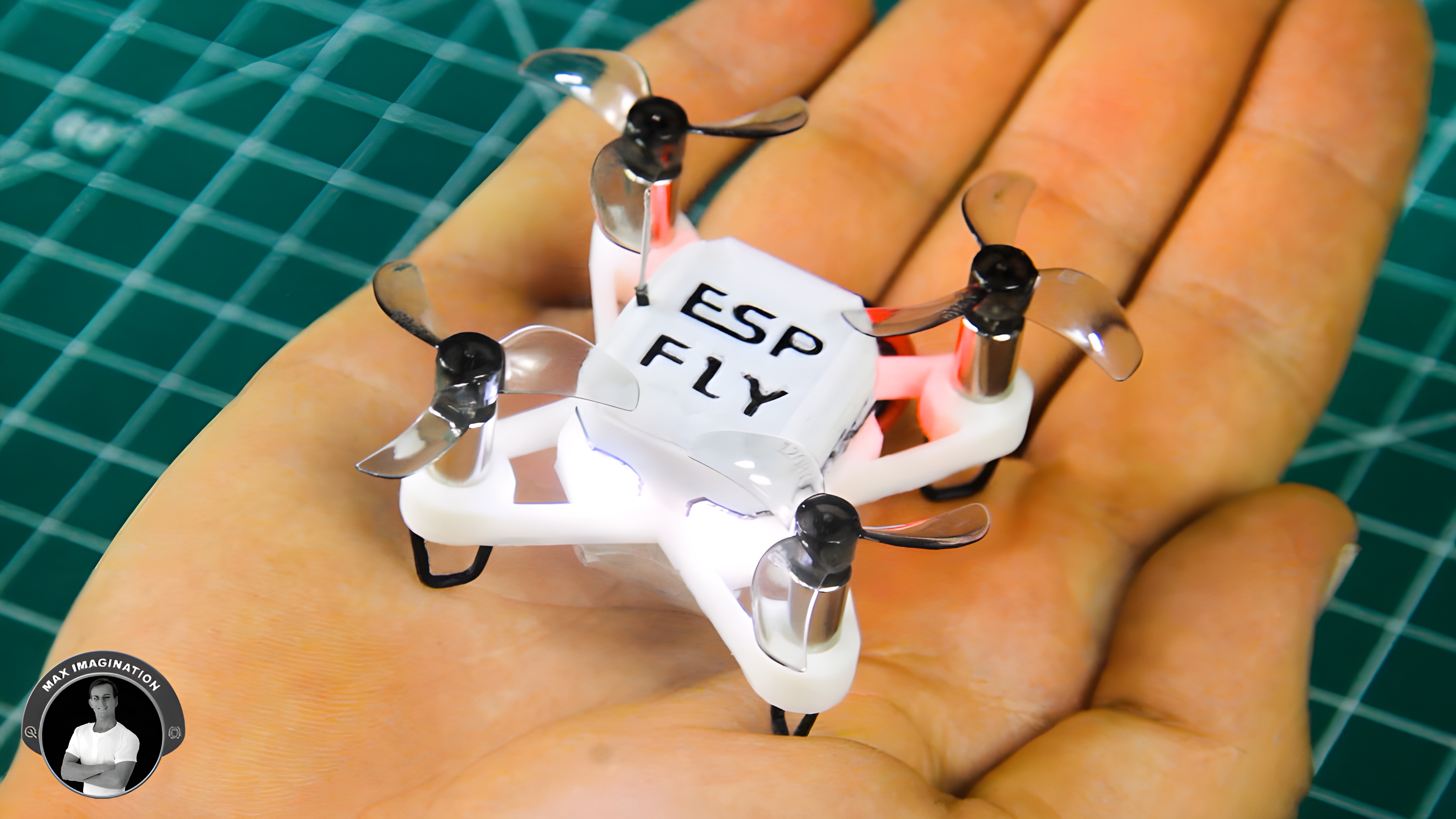

9. Adding Landing Gear & Antenna
For legs (landing gear), bend four 25mm solid-core jumper wires into V-shapes and insert them into the holes in the motor mounts.
Modify the microcontroller’s included antenna by removing the flex PCB and trimming the shielded portion, then route it under the drone’s cover for a 100m control range.
10. Installing Propellers & Battery
Use GEMFAN tri-blade props for 0.8mm shafts, ensuring the correct spin direction. Any other 30mm Bi, Tri, Quad, or more bladed propellers with a 0.8mm shaft diameter will work.
The motors shall spin the props inward in relation to the front and rear of the drone and be able to produce downward thrust. Be careful when attaching these so that the rotor does not pop through the motor bottom part.
Replacing these propellers can be easily done with the included prop-removal tool.

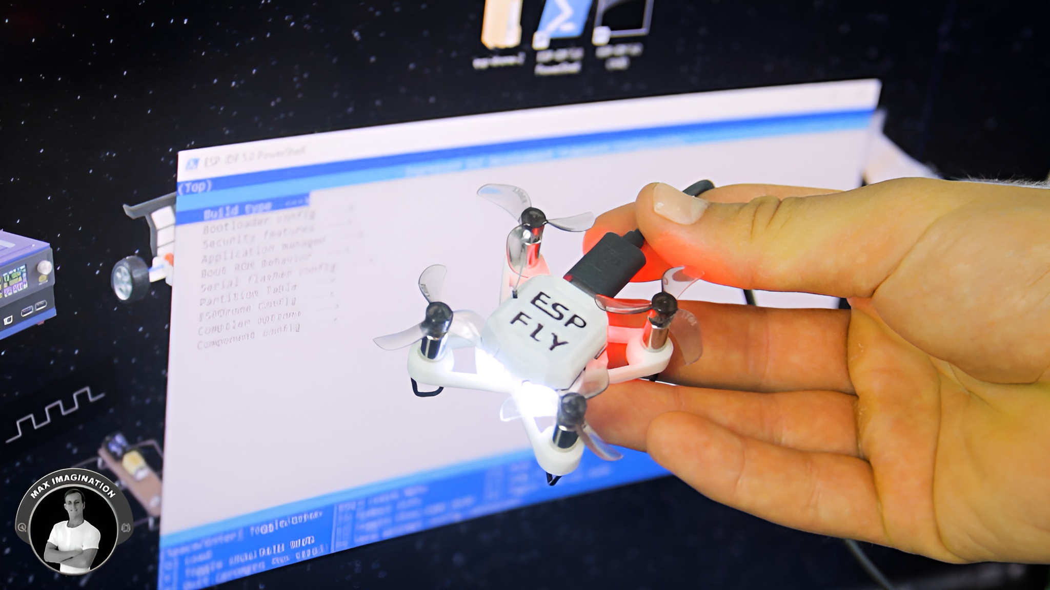

11. Flashing the ESP-Drone Firmware
Now, it's time to flash the firmware onto the drone using ESP-IDF, the official development framework for ESP32 chips. The ESP-Drone firmware and project, originally developed by Espressif, was inspired by BitCraze’s Crazyflie - a micro drone with a lot more sensors commonly used in swarm coordination. For technical details, refer to Espressif’s documentation: https://docs.espressif.com/projects/espressif-esp-drone/en/latest/gettingstarted.html
A big thanks to Circuit Digest and Jobit Joseph for their modified version of ESP-Drone firmware, which helped make this project more accessible. Also, shoutout to DR Electronics for assisting with the software setup. I've linked their channels in the project resources section.
To Flash the Firmware:
  1. Download ESP-IDF 5.0.7 (Found in project resources, ~0.96GB).
  2. Run the installer and select PowerShell & ESP32S3 board support when prompted.
  3. Download the firmware (use my pre-configured firmware files for the ESP-FLY).
  4. Extract the firmware, navigate to the esp-drone folder, and copy its directory path.
  5. Open ESP-IDF PowerShell, type “cd “ with the space, then paste the folder path and press Enter.
  6. Type “idf.py -p COMX flash monitor” (replace COMX with your actual port, found in Device Manager).
If everything is set up correctly, you’ll see "Ready to Fly" in the output log. If you spot sensor, CPU, or driver warnings, don’t worry - these components aren’t used in this build. Just ensure the motion sensor is detected and the WiFi access point is active.
To Customize the Firmware Settings:
  1. Type “idf.py menuconfig” in PowerShell.
  2. Navigate through the ESPDrone Config menu.
  3. Adjust pins, sensors, LEDs, and motor assignments if needed.
  4. Save changes, then reflash the firmware.
For advanced tuning, use the Crazyflie Client:
  1. Type “cfclient” in PowerShell to open the interface.
  2. Connect your PC to the drone’s WiFi AP (password: 12345678).
  3. Configure joystick mapping and select the UDP address.
  4. View real-time battery voltage, motion tracking, pitch, roll, and yaw data.
  5. Adjust trim, rates, thrust limits, and flight behavior.
Now, your ESP-FLY is almost fully configured and ready to be flown!

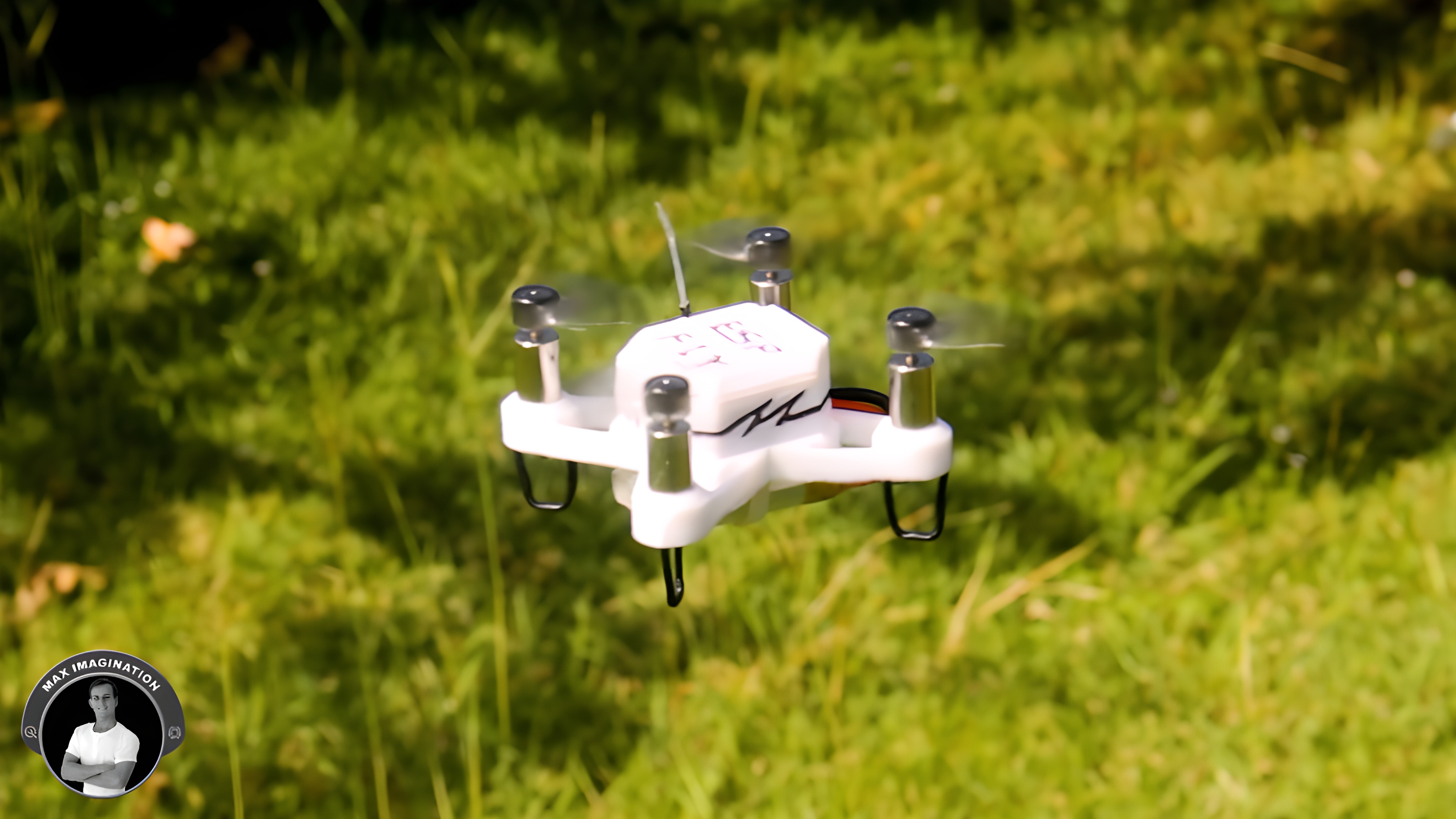

    13. Flight Test & Performance
    Throttle up and get airborne! The ESP-FLY has a 2.7:1 thrust-to-weight ratio (68g over 25g), enabling smooth, stable flight even in moderate wind conditions and lasts 5 ½ minutes in the air with a 250mAh battery.
    I took mine up to 50 meters before losing sight - so the range is more than enough!
    Another element complimenting its performance is its weight of 18g alone and 25g (grams) with the battery, the ESP-FLY is lighter than my 2024 Mini Arduino FPV drone. Its thrust-to-weight ratio ensures agile flight, while WiFi control removes the need for a dedicated transmitter like on my Arduino drone.

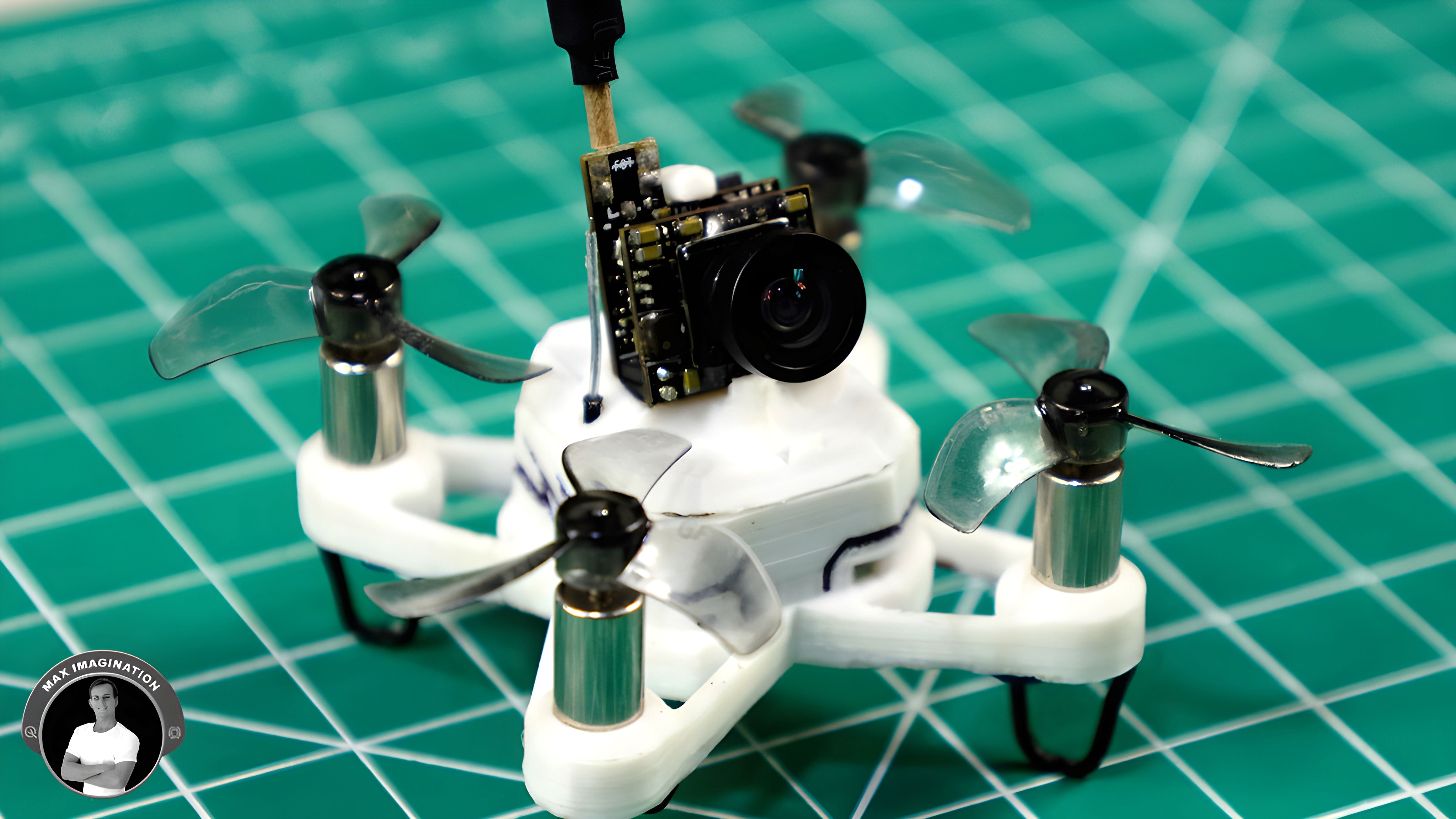

    14. Adding an FPV Camera
    For immersive FPV flying, install a WT07 3g micro FPV camera with the extra 3D-printed camera mount cover. Wire it directly to the battery connector at the bottom of the board, then bind it to FPV goggles using an auto-search. The 100m+ video range makes it perfect for indoor and outdoor flights!

    • FPV Camera: Add a WT07 micro FPV camera for first-person view flying or OV2640-style camera connected to microcontroller (when firmware gets an update to support one).
    • Larger Battery: Upgrade to a higher capacity 300-450mAh LiPo for longer flight times.
    • Improved Antenna: Swap out the short, modified WiFi antenna for a high-gain external antenna to extend control range.
    • Custom Tuning: Adjust flight parameters in the Crazyflie Client for better handling.
    • Alternative Motors & Propellers: Experiment with different coreless motors and prop sizes to optimize performance.
    • RGB LEDs: Add addressable LEDs for custom lighting effects during flight.
    All of these modifications can be implemented within the existing firmware, making the ESP-FLY even more capable.
