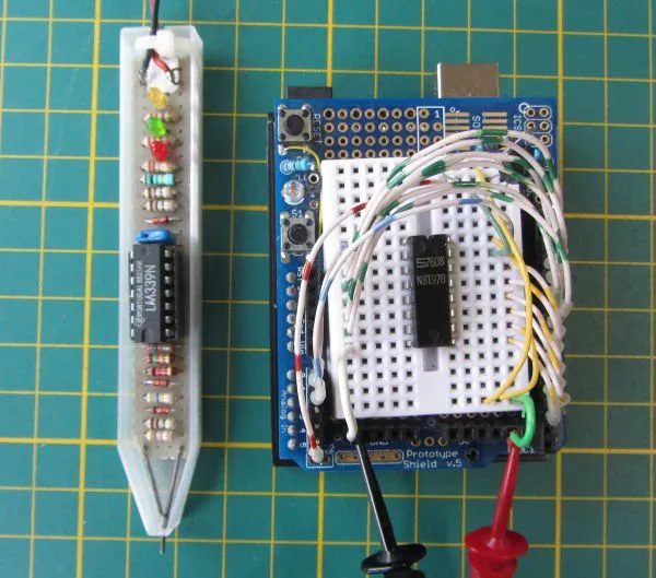

A simple TTL-I.C.-logic tester based on an Arduino and a Python script.
It only tests a limited set of different I.C.s from the 7400 series, having 14 and 16 pins.
The chip-definition is in a separate JSON-based text file, adding new I.C.s is as simple as creating a Boolean expression for its output pins.

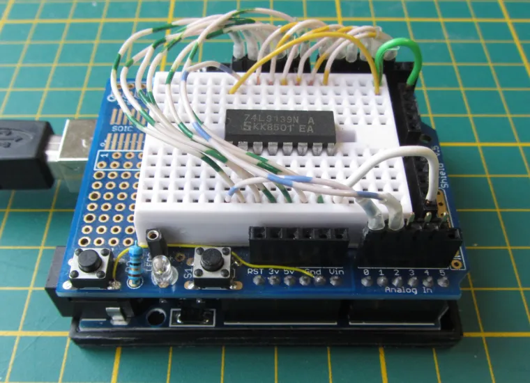

The tester prototype hardware part was build on an Arduino UNO, but moved to an Arduino Mega 2560.
The software part is a +300 lines Python 3 script and a text/JSON based I.C.-definition list.
The original algorithm was based on boolean expressions generating all possible input patterns, but a direct imperative set- and expect-pattern list is added.

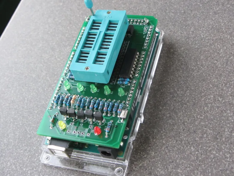

The PCB for a Arduino Mega 2560 based shield is now populated and being tested. It should allow testing IC's with 14, 16, 20, 24 and 28 pins and power at the highest pin number.

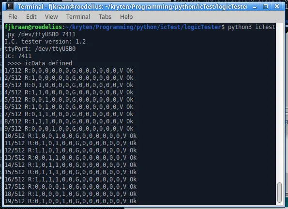

What the Python script does:
1. find the I.C. definition in the library
2. send the config to the Arduino
3. loop through:
  1. generate a bit pattern for all the exercise pins
  2. fill the query-template with the exercise logic levels
  3. fill the expected result template with exercise logic levels
  4. calculate the values for the query pins (convert to Python logic expression and evaluate)
  5. fill the expected result template with query logic levels
  6. send the query to the Arduino
  7. retrieve the response from the Arduino
  8. compare the expected result with the actual result
4. declare result and exit
New for version 1.3 are minimal power switching and Arduino only debugging commands. Note that the shown N8T97 is 44 years old and still working.
(The logic probe is an old Elektor design)

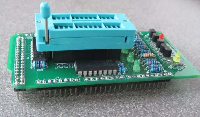

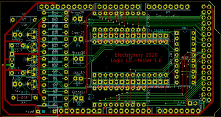

The Mega shield
(11/13/2020 at 08:51)
The PCB for the Arduino Mega 2560 finally got populated and somewhat tested. The layout is not perfect and the result isn't quite fit for the promotion poster, but probably good enough for testing and usage. This project is just to make digital logic I.C.s testing easy, not to win beauty contests.
Some issues found with construction and testing:
  • the LED resistor value of 330 ohm is way to low for the Arduino pins. It is changed to 3k3 ohm.
  • the resistor arrays were hard to find and weren't the designed size, so some extra resistors were needed to fill the missing positions. It would look better if all positions were discrete resistors.
  • The MOSFETs ordered had a different package than the PCB design.
The next stage is:
  • to test the board,
  • add more and larger I.C.s to the library,
  • implement test algorithms for tri-state, open collector, ...
At one time I might upload an updated schema and PCB, but as long as the current design is fixable, I won't order and test it.
There are five pins were power can be applied, being the highest pin number for 14, 16, 20, 24 and 28 pin I.C.s. For different power pin schemes, the breadboard solution of the prototype could be used.

Schematic and Layout
  • icTester_v1.3.pdf - Schema of PCB v 1.0
