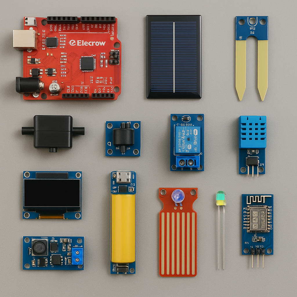

Hardware Components
  • DHT22 Temperature/Humidity Sensor
    X 1
  • Micro Submersible Water Pump (5V DC, ~100L/H)
    X 1
  • Soil-Based Energy Harvester Module
    X 1
  • 18650 Li-ion Battery & Holder
    X 1
  • 5V 1W Solar Panel (with JST connector)
    X 1
  • RGB LED Common Anode
    X 1
  • Water Level Sensor (Floatless Type)
    X 1
  • MIT App Inventor/Blynk Services
    X 1

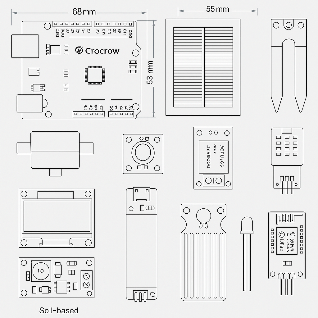

Schematic and Layout
  • Technical drawing
