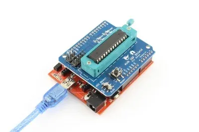

Step 2: Plug AVR ISP Shield
第 2 步:插入 AVR ISP 屏蔽
Plug AVR ISP Shield onto the Arduino/Crowduino. Connect the board to PC using USB cable.

Step 6: Plug the Atmega328P-PU
第 6 步:插入 Atmega328P-PU
Plug the atmega328P-PU IC into the IC holder of the AVR ISP shield. Please be careful about the direction of the atmega328.
