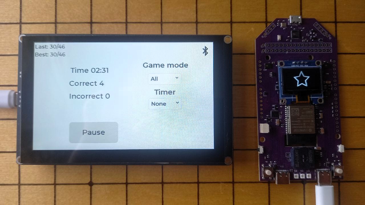

To address this, we enhanced the setup with CrowPanel. It connects to the GRC AI DevBoard via Bluetooth and starts communicating with the C3 microcontroller inside. Here’s what CrowPanel adds:
  • Live feedback on correct and incorrect answers
  • Score counters and visual indicators on screen
  • Automatic app launching: CrowPanel switches the DevBoard into Teacher 3+ mode upon connection
  • Game control UI: Choose between all words or specific categories, and pause the game when needed
A screenshot shows how the user interface looks during gameplay.
