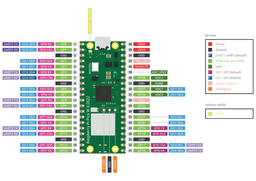

The Raspberry Pi Pico W (datasheet) is built around the RP2040 microcontroller designed by Raspberry Pi. Its specifications include:
  • RP2040 microcontroller (datasheet) (dual-core ARM Cortex-M0+ @ 133 MHz)
  • 264 KB of SRAM
  • 2 MB of QSPI flash memory
  • 802.11n Wi-Fi connectivity (2.4 GHz) via Infineon CYW43439 chip (datasheet)
  • 26 multifunction GPIO pins
  • Support for 2× I2C, 2× SPI, 2× UART
  • PWM output on 16 pins
  • Three 12-bit analog input pins
  • On-chip clock and timer with year, month, day, weekday, hours, seconds, and automatic leap year calculation
  • On-chip temperature sensor connected to a 12-bit ADC
  • Micro-USB port for power and programming
  • Operating voltage: 1.8 V – 5.5 V
  • Form factor: 21 mm × 51 mm
  • Operating temperature range: –20 °C to +85 °C

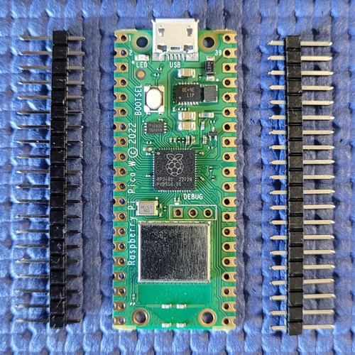

  • If you bought a Pico or Pico W (not Pico H or WH), it won't come with header pins soldered—you'll need to solder them yourself.
  • You can use a small fine-tip soldering iron (~25–30 W) and lead-free solder (97% tin, 3% copper, 1 mm diameter).

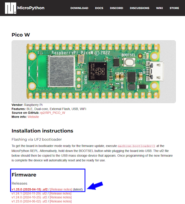

Step 1: Download the MicroPython Firmware
  1. Go to the official MicroPython website and navigate to the Pico W firmware page: https://micropython.org/download/rp2-pico-w/
  2. Download the latest .uf2 firmware file (e.g., version v1.25.0 dated 2025-04-15).
  3. Save the .uf2 file to your computer.

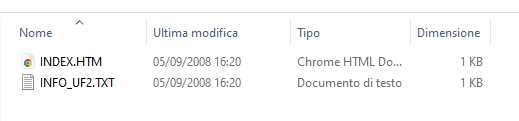

  4. The computer should detect a new USB drive labeled RPI‑RP2.
You’ll see two files: INDEX.HTM and INFO_UF2.TXT.

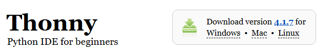

You can use either a serial-terminal or an integrated development environment (IDE). A beginner-friendly method is to use Thonny:
  • Thonny is a free, open-source Python IDE ideal for beginners.

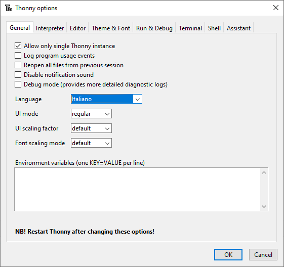

How to Install and Configure Thonny:
  • Install and launch the application.

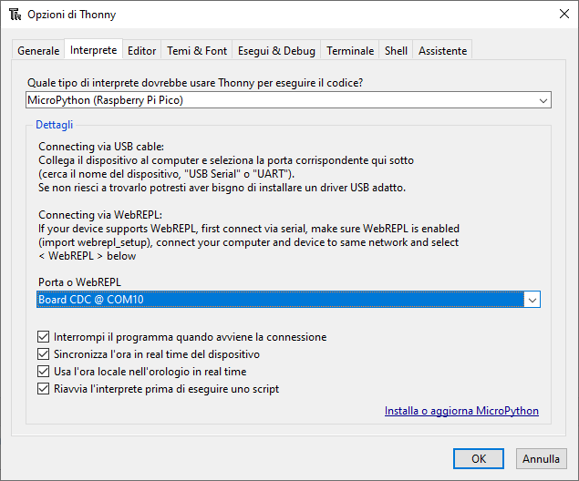

  • Go to Tools → Options → Language, select your preferred language, and restart Thonny.
  • Then go to Tools → Options → Interpreter, and choose the Pico W as the interpreter.
  • Select:
    Interpreter: MicroPython (Raspberry Pi Pico)
    Port: It should be detected automatically (e.g., COMx or ttyACM0)
Click OK

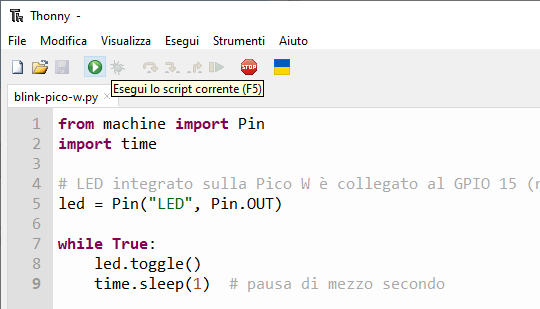

Step 5: Run a Test Program (Blinking LED)
The Pico W has a built‑in LED connected on GPIO 15 (note: GPIO 25 is used on original Pico). Type this example in Thonny:
from machine import Pin
import time led = Pin("LED", Pin.OUT) # Built-in LED on GPIO 15
while True:
led.toggle()
time.sleep(1) # 1 second pause
Running this will make the LED blink at 1 second intervals. To start the program click on the Run button
