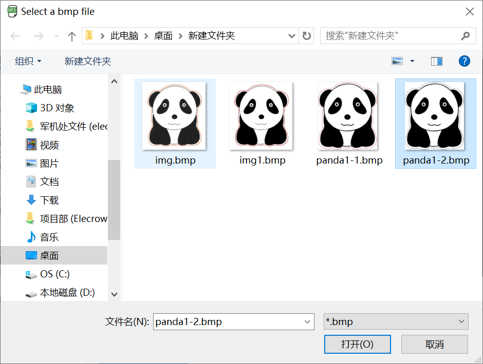

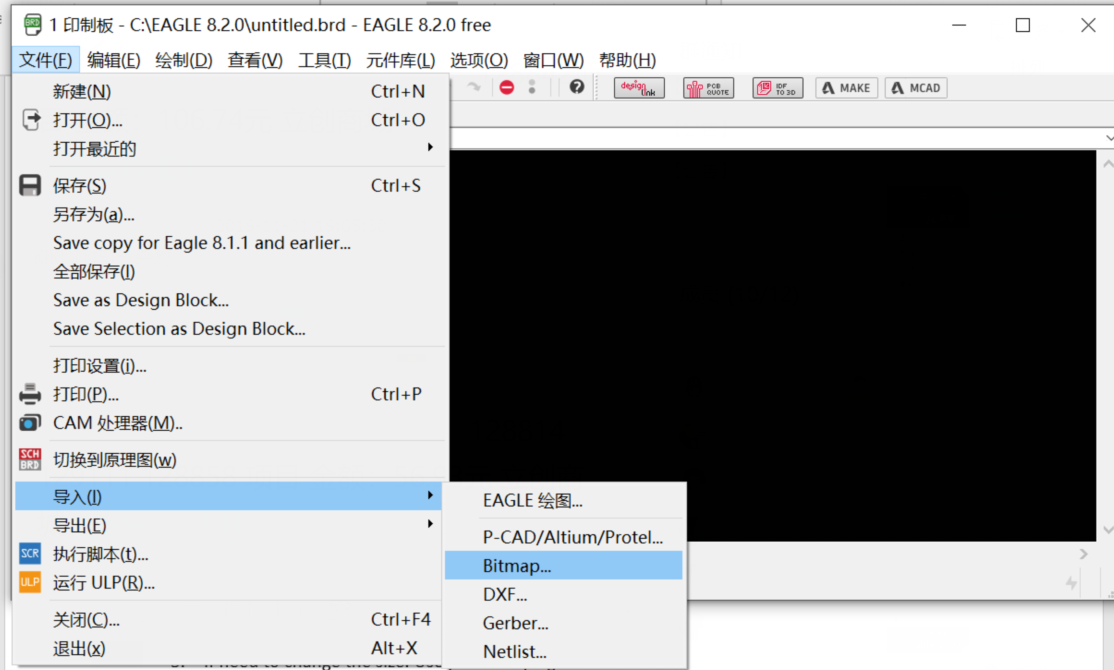

a. It’s time to input the BMP file to eagle. The following are the details steps. Click file ->input->Bitmap and then click ok.
b. Select a BMP file, Click open.

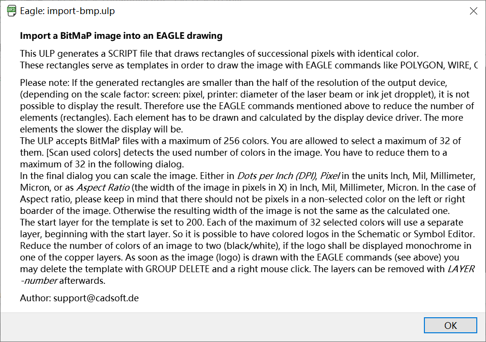

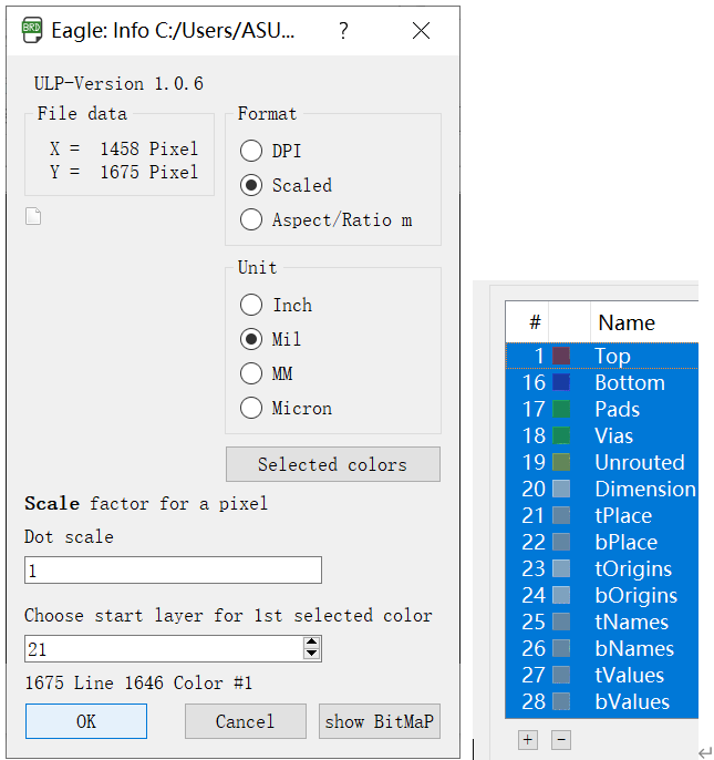

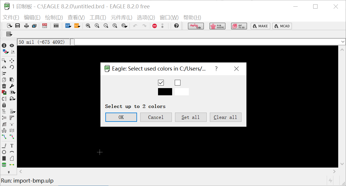

C. Select used colors, In the picture what we used is the black area as silkscreen
D. We put the black area on the PCB top side. So we select 21layer tPlace and then click ok.

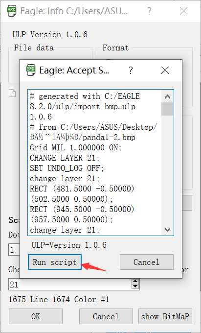

E. Click Run script button.

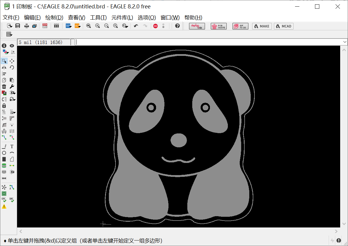

F. Then the BMP picture is input to the tPlace layer as silkscreen. Measure the size of the import image in eagle and adjust the size of BMP file and input again.

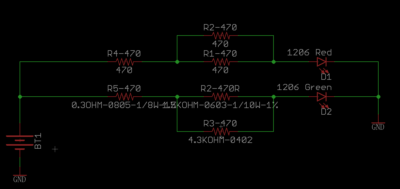

3. Design the circuit in the schematic

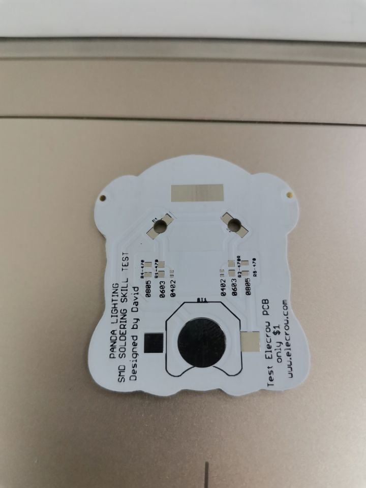

All the resistors are 470R, two 0805, two 0603 and two 0402. The led lighting normal if the 0402 resistor can’t be solder, just not so bright.
And the led is used normal 1206 LED that needs soldering on the back side of the led to make the lighting better.

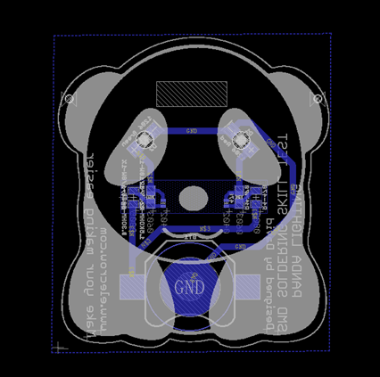

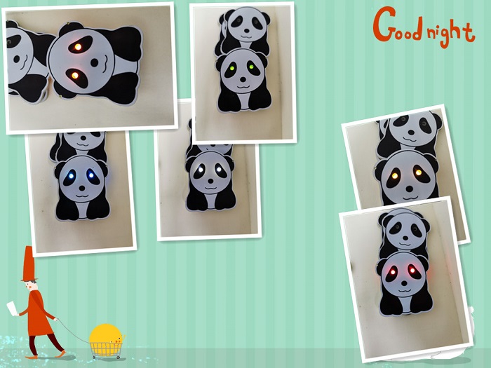

4. Layout and add text description. export gerber file and send to the PCB factory. The following picture show the layout finished board and PCB prototyping sample.
