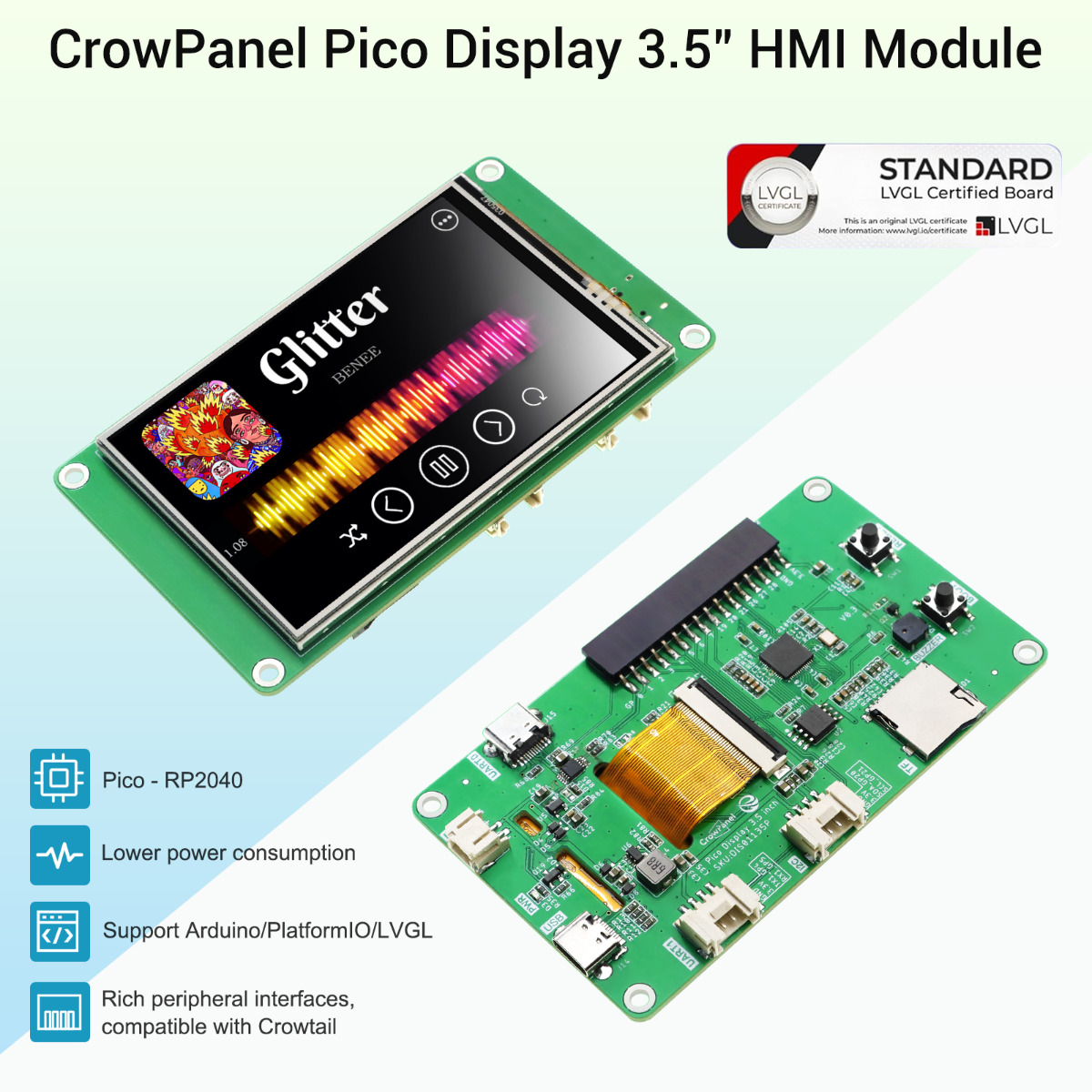

CrowPanel Pico Display is an HMI module series that utilizes the powerful Raspberry Pi RP2040 (ARM Cortex-M0+) as its main controller. It is equipped with a 32-bit dual-core chip running at a clock frequency of up to 133 MHz. With 264kb of built-in SRAM and a 2MB flash memory chip, it integrates power supply, voltage regulation, and counter functions into a single microcontroller. This series of touch screens incorporate high performance, low cost, and user-friendly features.
The Pico 3.5” Display has a resolution of 480*320 and comes with a touch pen for flexible screen manipulation. It has flexible I/O peripherals and a unique programmable input/output (PIO) subsystem, including practical communication interfaces such as I2C, UART, common IO ports, and USB. It also features a lithium battery interface and a buzzer alarm, enabling communication with almost any external device. This provides professional users with flexibility and powerful expandability, allowing seamless connection to the physical world and control of various aspects of smart homes.
The module comes with abundant resources, including development SDK, and documentation. It has a very low entry barrier, making it suitable for beginners and hobbyist users. It supports C/C++ programming languages, is compatible with the Raspberry Pi ecosystem, and is suitable for the TensorFlow Lite open-source machine learning framework and the LVGL graphics library. It serves as an excellent platform for machine learning applications and is the preferred solution for Pico-like HMI interaction terminals.

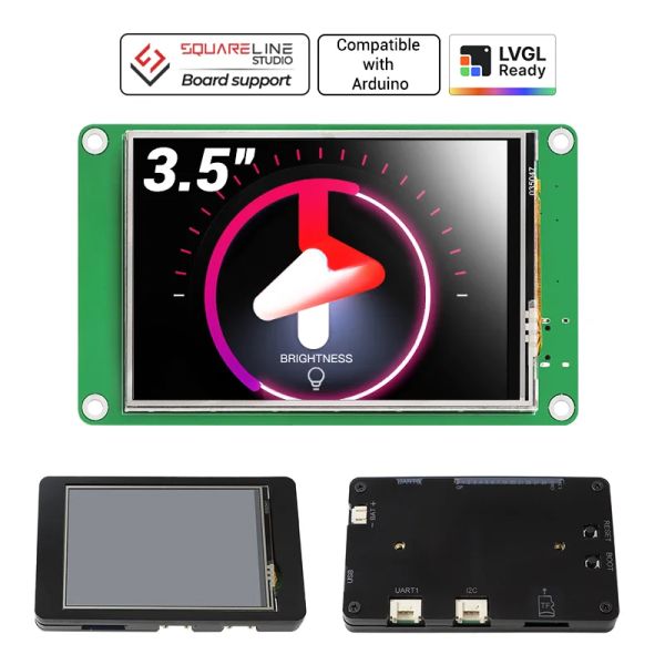

Support multiple development environments
It supports a variety of development environments such as Arduino IDE, Thonny IDE, and MicroPython, to meet the needs of different developers and make every project possible.
3.5 inch HMI module support multiple development environments
3.5 inch HMI display support multiple development languages
It supports the LVGL graphics library. You can design a variety of your UIs.
3.5 inch touch module support open-source Graphics Library-LVGL
Simplifying UI Design and Development with SquareLine Studio
Easily design and implement your own LVGL UI with SquareLine Studios, and export ready-to-use projects with one click.
Squareline Vision has entered BETA, sign up now to get 40% off all licenses. https://vision.squareline.io/
3.5 inch touchscreen monitor can use SquareLine Studio easily

  • 3.5 inch Pico Display: 480*320 resolution, resistive touch and comes with a touch pen
  • RP2040 Microcontroller: Equipped with a 32-bit dual-core chip, it achieves a maximum clock frequency of 133 MHz.
  • TN Panel: Offers a wide color gamut and exceptional brightness for optimal display performance.
  • Energy Efficiency: Supports low-power sleep and hibernation modes, promoting energy conservation and environmental consciousness.
  • Exceptional Extensibility: A wealth of interfaces, including I2C, UART, IO ports, USB, a lithium battery interface, and a buzzer alarm, ensures remarkable extensibility.
  • Ease of Use: A user-friendly experience is guaranteed with the provision of a detailed development SDK, and comprehensive documentation, ensuring a smooth learning curve.
  • Broad Compatibility: Supports C/C++, and MicroPython programming languages while exhibiting compatibility with the Raspberry Pi ecosystem. It is also well-suited for the TensorFlow Lite open-source machine learning framework and the LVGL graphics library.
  • Versatile Applications: Ideally suited for a wide range of applications within the Internet of Things (IoT), intelligent home control, smart factories, intelligent agriculture, and as an HMI interactive terminal.
