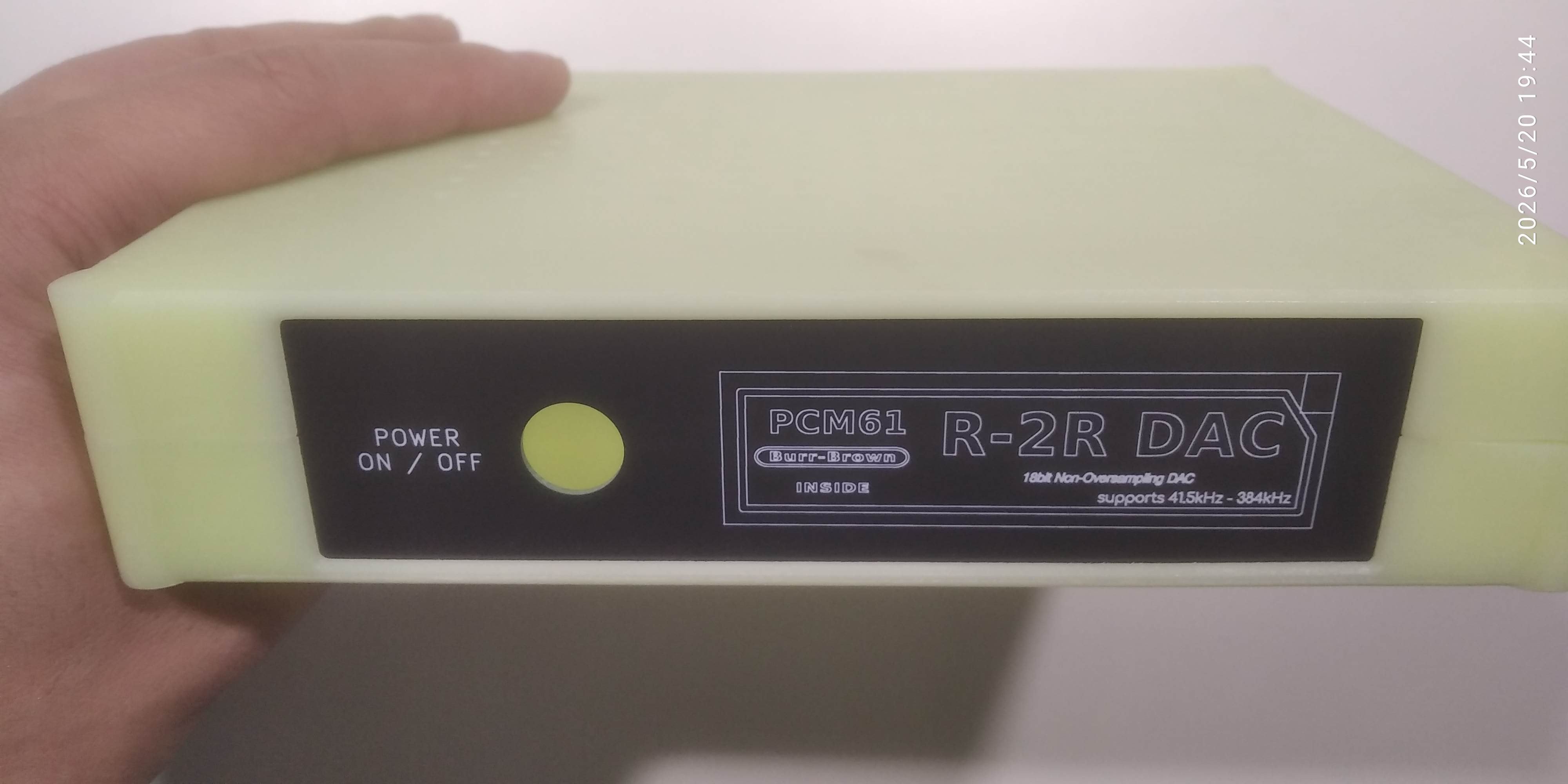

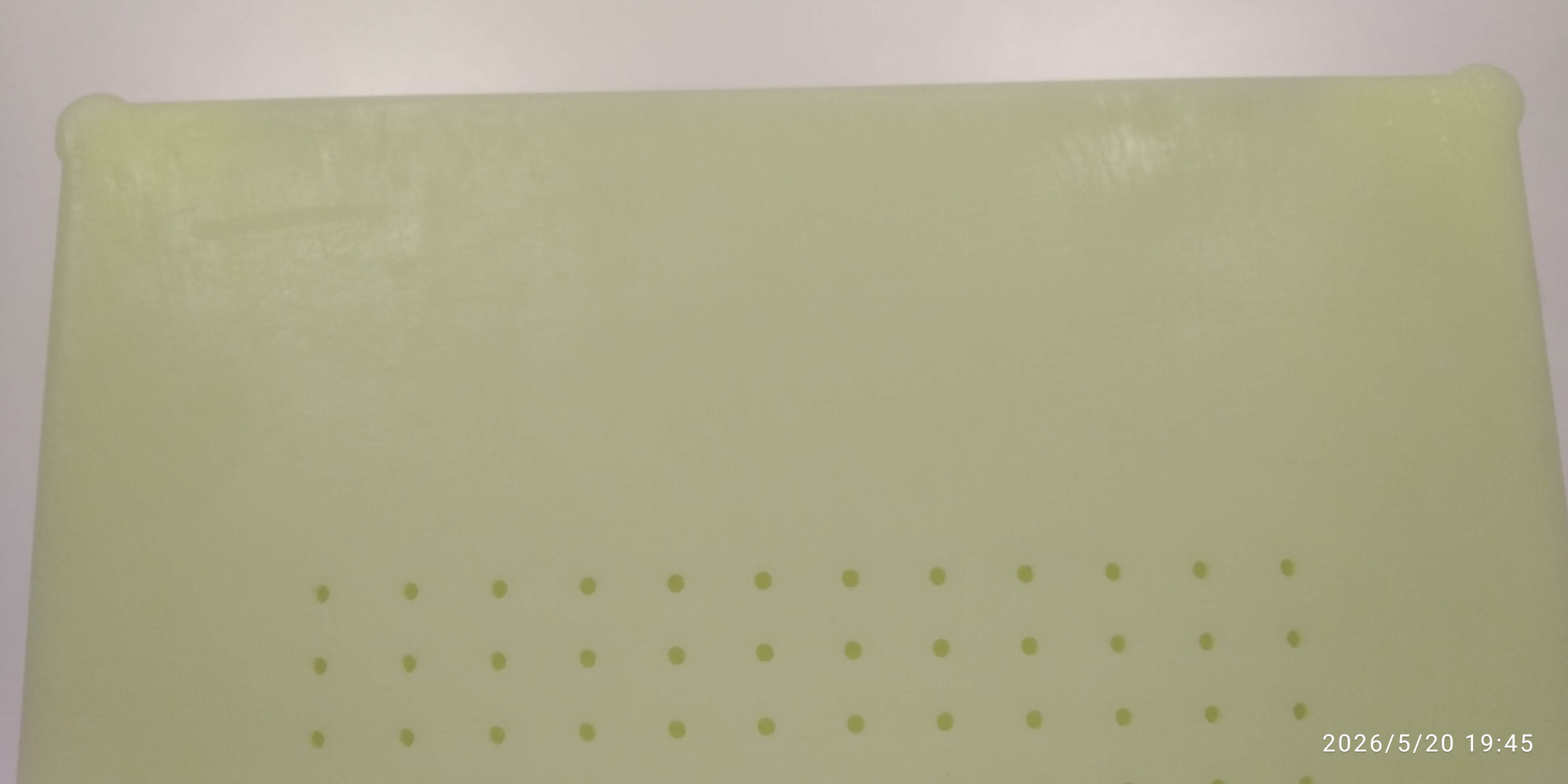

3D-printed enclosure for a DAC top
3D-printed enclosure for a DAC with panels made from FR4 PCB material. This is the top part of an electronic device enclosure. The material is UV-curable Yellow High Toughness Resin. The dimensional accuracy is good, and the hardness is also good. The surface is smooth, but there are visible traces of post-processing and washing after printing, seen as scratches and marks. The color, as shown, is light green. In my opinion, it is not really suitable as a final product without painting and additional finishing. The material is good for prototyping and modeling, but I would not recommend it for a final consumer-facing product.
