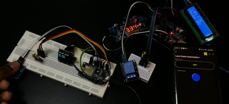

 LoRa Based Smart Home Control System (5KM Range)
Project Overview
This project demonstrates a long-range smart home control system built using RYLR998 LoRa modules, NodeMCU ESP8266, and Arduino Uno.
Unlike traditional WiFi-based home automation systems, this project uses LoRa (Long Range communication) technology to enable wireless communication up to 5KM range under line-of-sight conditions.
The system supports both:
  • Online control via the Blynk IoT mobile application
  • Offline control using a capacitive touch sensor
This ensures reliable operation even in environments where internet connectivity is unstable or unavailable.

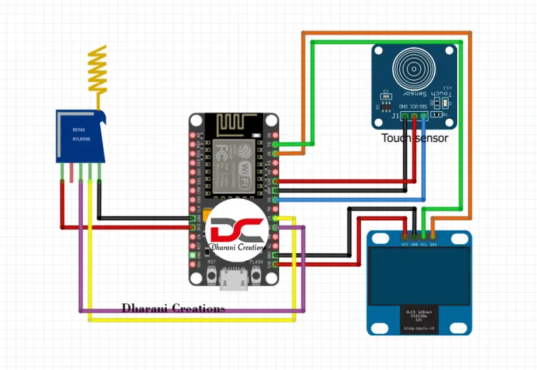

1️⃣ Transmitter Section (NodeMCU Side)
The NodeMCU acts as the control and communication unit.
It performs the following functions:
  • Connects to WiFi
  • Communicates with the Blynk IoT platform
  • Reads input from the touch sensor
  • Sends commands via LoRa module
  • Displays system status on OLED screen
When a user presses the relay button in the Blynk app or touches the sensor, the NodeMCU sends a command through the LoRa module to the Arduino unit.

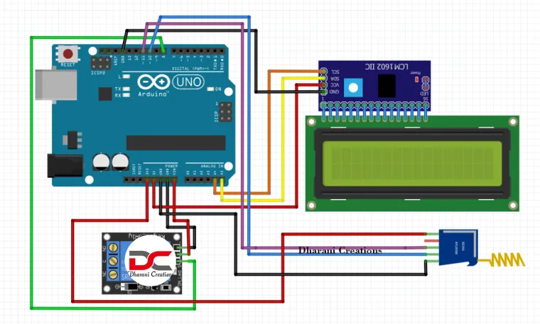

2️⃣ Receiver Section (Arduino Side)
The Arduino Uno acts as the execution unit.
  • Receives LoRa command
  • Controls the relay module (Active-Low logic)
  • Sends acknowledgment (ACK) back to NodeMCU
  • Displays system status on 16x2 LCD
When a command is received, the relay is switched ON or OFF accordingly. The Arduino then sends an acknowledgment message back to the NodeMCU to ensure proper synchronization.

Schematic and Layout
  • Diagram
    https://github.com/DharaniCreations/LoRa-Smart-Home-Control-5KM-Range-
    View
