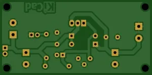

I made a small DC-DC power supply for prototyping, projects, assembly and electronic experiments.
LM317 DC power supply
  • LM317

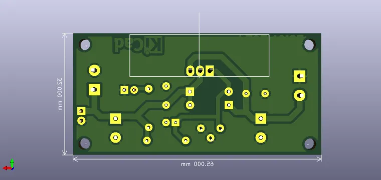

This is a DC-DC module built around the well-known LM317 IC, it does not contain the diode bridge, so it cannot be used directly with an AC transformer. I also chose some usual connectors, you can tighten the wires with some screws and that's it.
This circuit is capable of reducing DC voltage, but keep in mind that the input voltage must be at least 3V higher than the output voltage. The LM317 circuit has various built-in protections, more details can be found at this link : https://www.ti.com/lit/ds/symlink/lm317.pdf .
There is enough space for an 11x36mm heat sink, because I can't know what parts each one has, I can't specify a specific model.
