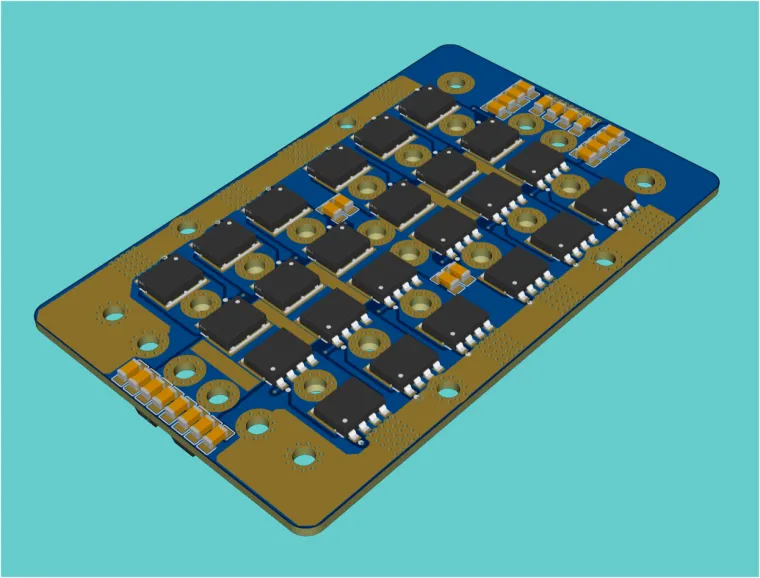

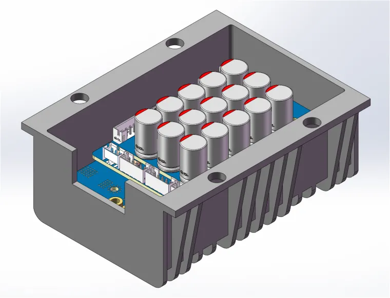

  5. Thermal optimization: Implement an efficient PCB layout, low-loss power 300A Vishay MOSFETs, and an appropriate cooling strategy.

Long endurance is a central design goal of the project. The ESC will be optimized to reduce energy losses throughout the power-conversion and motor-control process.
The development strategy includes selecting low-loss 300A Vishay MOSFETs, optimizing gate-drive voltage and switching characteristics, minimizing parasitic inductance, improving PCB current paths, and High power density top side cooling package.

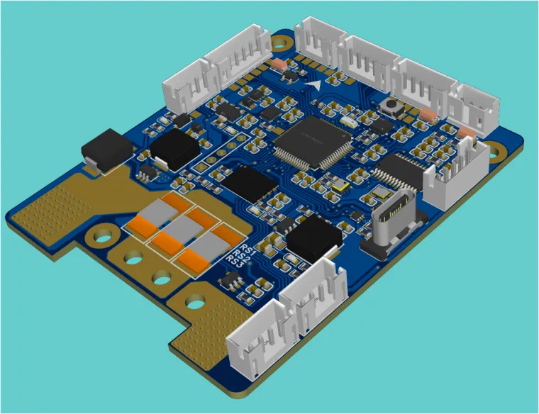

Flight controller integration Betaflight, via supported protocols
