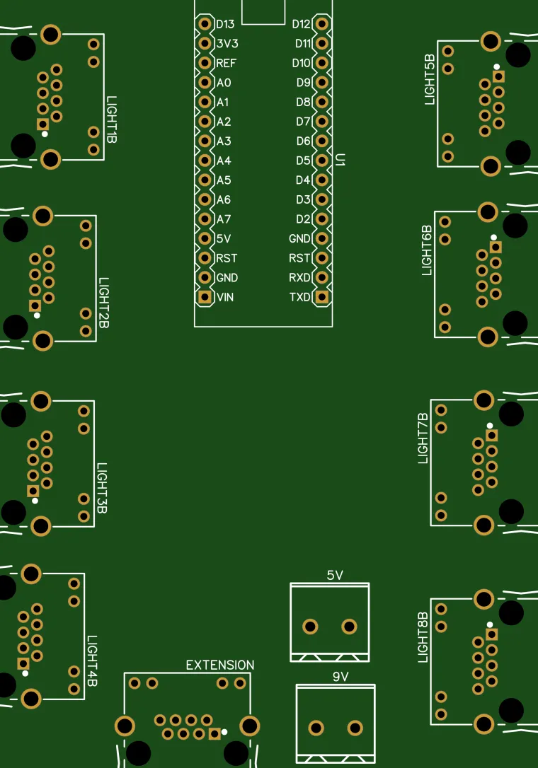

A modular lighting rig based around the Arduino Nano, this is the base station, the endpoints are included in another project.
Modular Lighting Rig: Base Station
  • FastLED
This is a modular lighting rig based around the Arduino nano, as there was no others available at the time for me to use in my live shows.

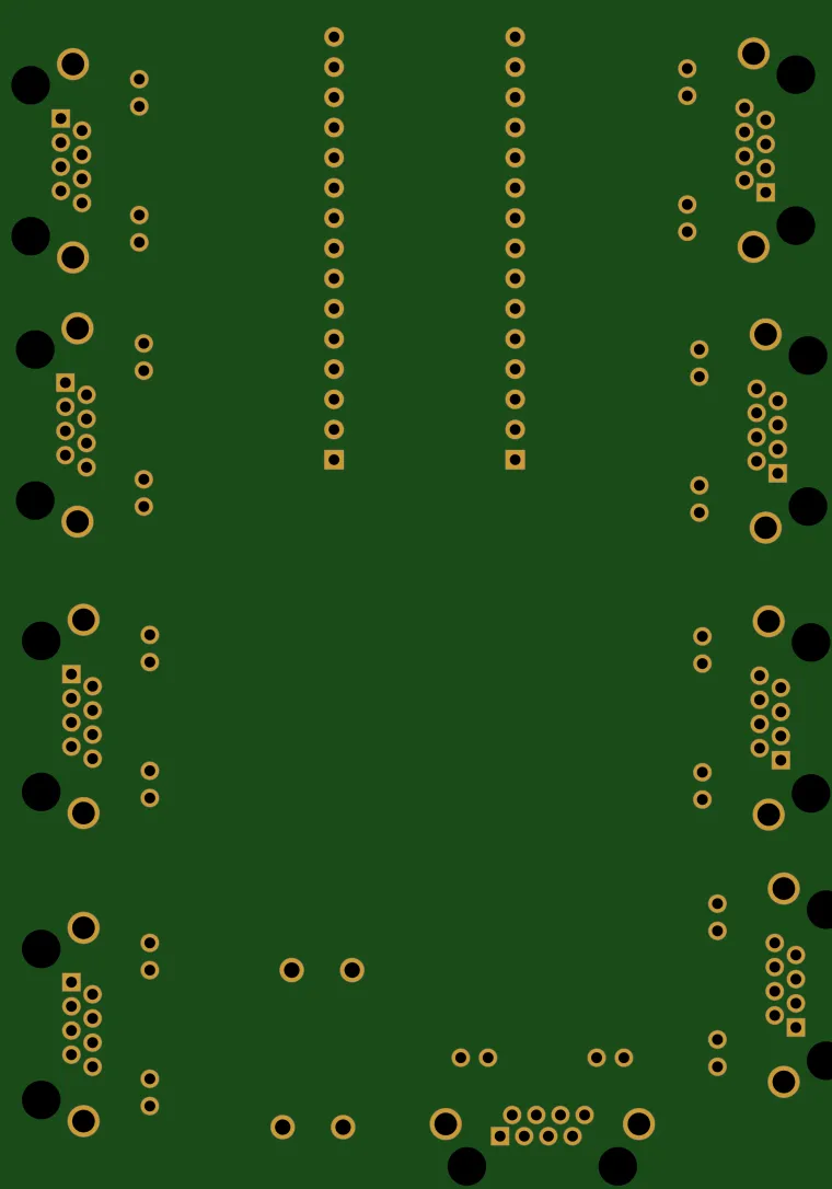

I was able to successfully make this on a proto-board, however, the PCB should work too.
This allows for 8 lighting outputs, take a look at the endpoints I have made available too.
The RJ45 pinout is as follows.
1 - 5V
2 - 5V
3 - Blank
4 - Data
5 - Data
6 - Blank
7 - GND
8 - GND
Please note that this is still a work-in-progress, and I haven't made a consumer ready software for this. I'd love to see what sort of softwares you can make! If you don't have programming knowledge, ChatGPT can help write the code.
I have included the schematic in the links below.
