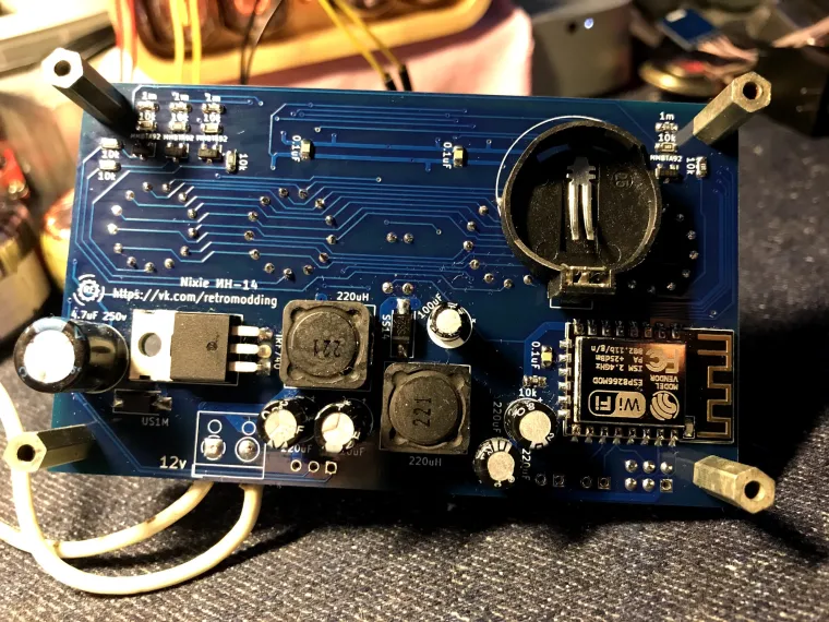

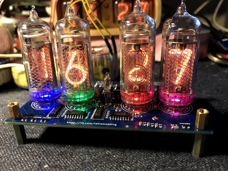

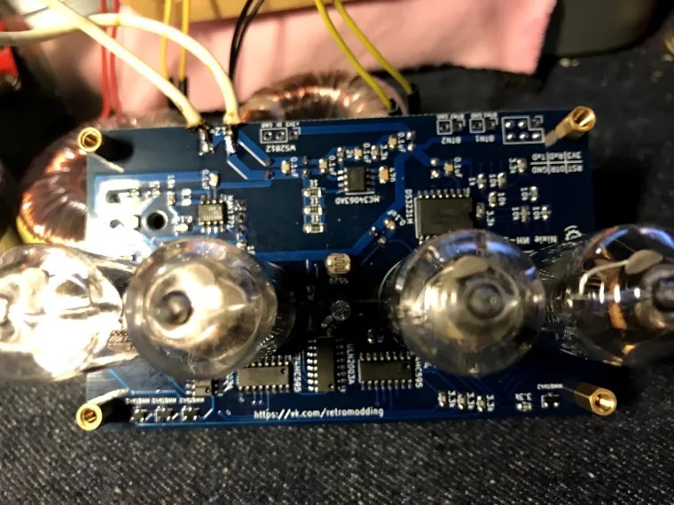

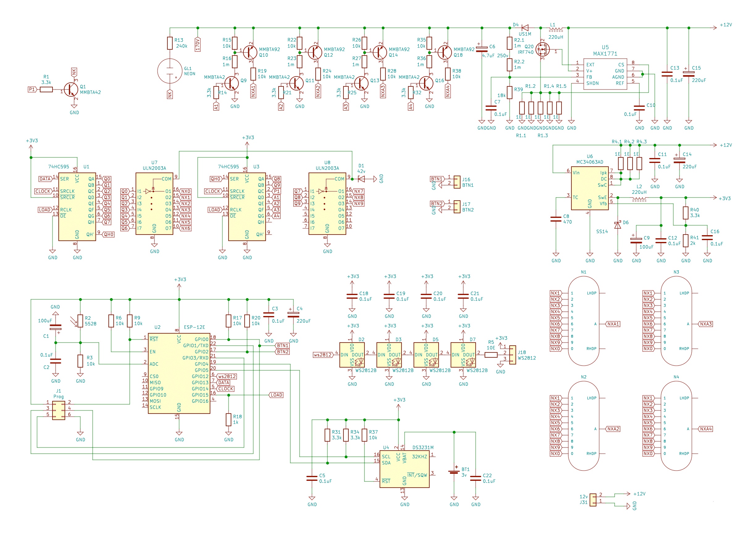

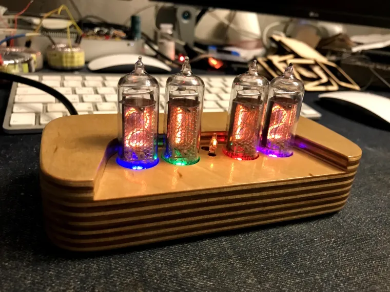

IN-14 Lamp Clock with WiFi v2
Opportunities:
  • Automatic setting and synchronization of the exact time when connected to the network.
  • 3 alarm clocks (the functionality is available when the Player mini module is connected , with the ability to adjust the frequency, time, melody and volume , notification by time of 1h, 30m, 15m, 10m and 5m (functionality is available when connecting the DFPlayer mini module), with the ability to adjust the frequency, melody and volume, it is also possible to notify by voice every hour
  • Manual or automatic brightness adjustment depending on the illumination.
  • The ability to control 8 SW2812 LEDs.
  • Management and configuration via the web interface.
  • Built-in lamp recovery function (Treatment of cathode poisoning).
  • turning off the indicator after a certain time and turning on, resetting the time by an external signal (when connecting a human presence detection sensor)
