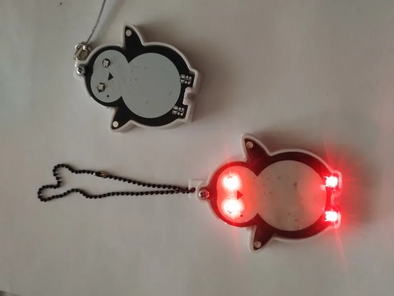

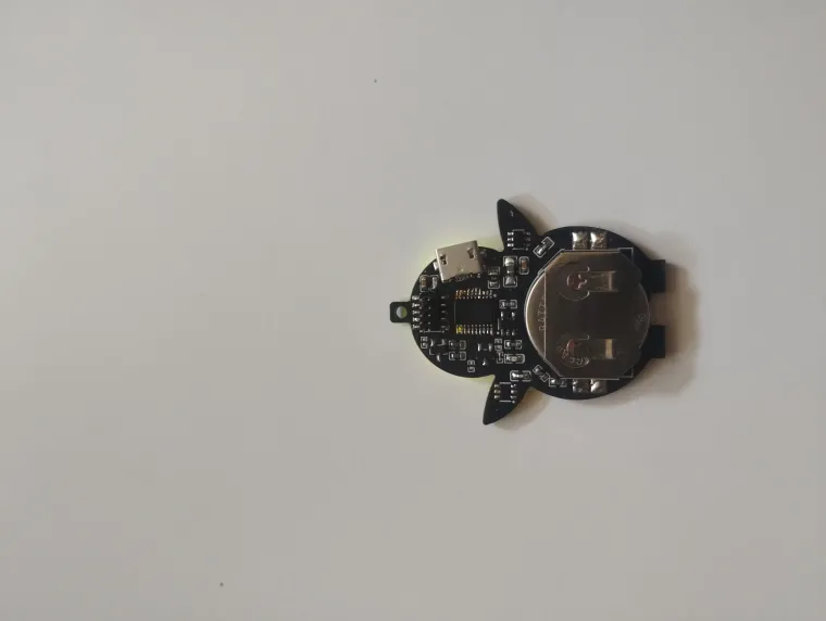

Kapacita22uF
Penguin -Keychain
Dev. board and Keychain with ch32x033, 4x ws2812b-2020, micro USB
Penguin -Keychain
Tools, APP Software Used etc.
  • WCH-LinkE
  • Moun River Studio Community

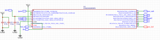

This is my development board for ch32x033 designed for learning and at the same time usable as a keychain, usb hw key for passwords...

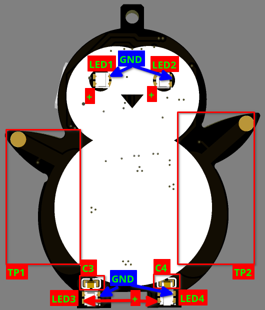

WS2812-2020 :

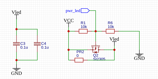

LED POWER:

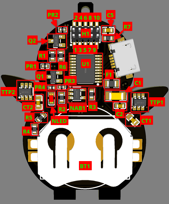

U1:
H1, microUSB:

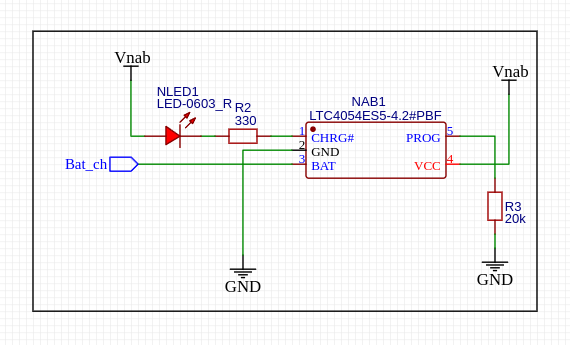

CHARGER:
BATTERY POWER:
TOUCH IC:
Keychain mode:
-LED, LIR2032 battery or other Lion, Charger, LED power off , VCC Power Off When USB Plugged In(PR4,R4,Q1),
-NO usb data
-DON'T USE NON-RECHARGEABLE BATTERIES LIKE CR2032 !!!
- OR DO NOT CONNECT USB IF USING NON-RECHARGEABLE BATTERIES (CR2032 ...)!!!
-OR REMOVE BATTERIES BEFORE CONNECTING THE USB!!!
ID Name Designator Footprint Quantity Manufacturer Part Price
1 CR2032_C9900001893 BT1 BAT-SMD_CR2032 1 CR2032
2 4.7u C1 C1206 1
3 0.1u C2,C3,C4,C5 C0603 4
4 18pF CT1,CT2 C0603 2 HGC0603G0180J500NTHJ 0.003
5 0R F1 R0805 1
6 WS2812B-2020 LED1,LED2,LED3,LED4 LED-SMD_4P-L2.0-W2.0-TL_WS2812B-2020 4 WS2812B-2020 0.076
7 LTC4054ES5-4.2#PBF NAB1 SOT-23-5_L3.0-W1.7-P0.95-LS2.8-BL 1 LTC4054ES5-4.2#PBF 5.451
8 LED-0603_R NLED1 LED0603_RED 1 19-217/R6C-AL1M2VY/3T 0.019
9 0R PR4 R0402 1
10 SI2305 Q1,Q2 SOT-23-3_L2.9-W1.3-P1.90-LS2.4-BR 2 SI2305 0.032
11 10k R1,R4 R0603 2
12 330R R2 R0603 1
13 20k R3 R0603 1
14 100R R7 R0603 1
15 Touchpoint TP1,TP2 TOUCHPOINT 2
16 TTP223-BA6 TTP1,TTP2 SOT-23-6_L2.9-W1.6-P0.95-LS2.8-BL 2 TTP223-BA6 0.159
17 CH32X033F8P6 U1 TSSOP-20_L6.5-W4.4-P0.65-LS6.4-BL 1 CH32X033F8P6 0.413
18 U-F-M5SS-W-5 USB1 MICRO-USB-SMD_MICRO-USB-A9 1 U-F-M5SS-W-5 0.083
