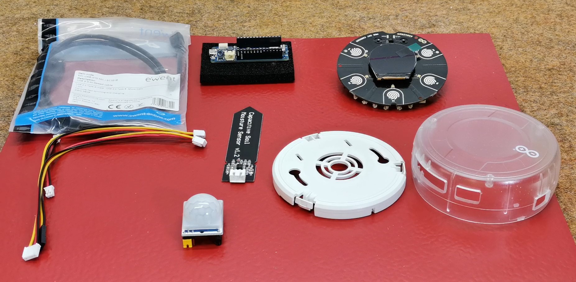

   First, let's see what components this kit contains:
  - MKR IoT Carrier with a place for a 3.7V lithium battery
  - Arduino MKR WiFi 1010 board
  - Plastic box for carrier
  - moisture sensor
  - PIR sensor
  - and various cables that are needed to connect external components, as well as a USB cable for connecting to a PC
  - MKR IoT Carrier board contains several sensors for:
      - Temperature and humidity
      - Pressure sensor
      - Light sensor
      - 5 capacitive buttons
      - than 2 relays
      - micro SD card reader
      - different types of connectors
      - and on the front side, color display.

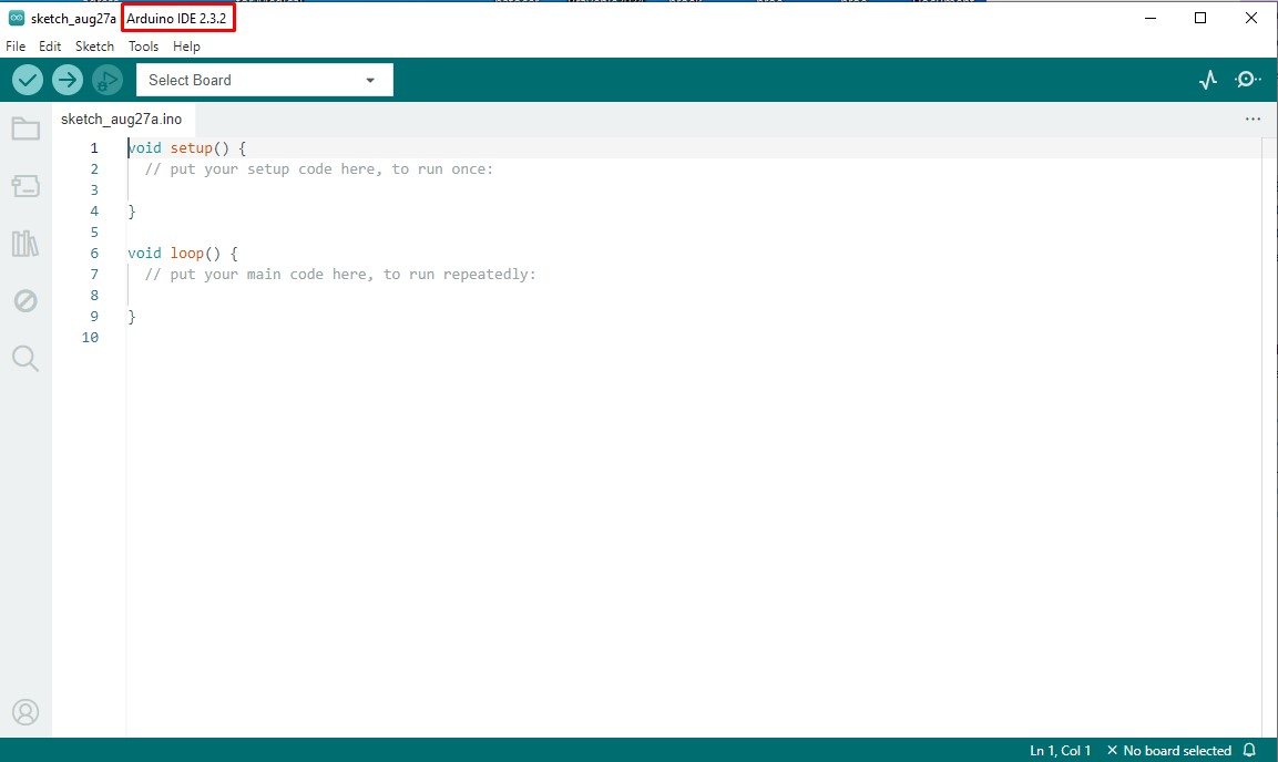

  First we need to download the Arduino IDE software from the () given address. I am specifically using the current latest version 2.3.2.
  You can also use the Arduino Web Editor (requires an account), which is directly connected to Arduino IoT Cloud, but more about that on another occasion. Then we connect the module to the USB port of the computer and the arduino IDE editor will show options for updating the libraries and boards, where we need to install them. I have already performed this operation before.  Next we select the appropriate COM port and we are ready to install the first code. And now, logically, to make sure that everything is connected and installed correctly, we will upload a very simple Blink sketch.
  The onboard LED of the Arduino MKR WiFi 1010 is connected to pin13, and a small relay is also connected to the same pin, so that both visually and acoustically we will be able to make sure of the functionality of the device. Now we can finally upload the previously mentioned sketch for Simon Says game. Let me not forget to mention that the original sketch is the work of Julián Caro Linares and all credit goes to him. We paste the code in Arduino IDE and press compile. If we get error we need to install "Arduino_MKRIoTCarrier" library.
  In Sketch - include library - manage libraries - search for desired library and install. Now we can compile code without error.  Next is uploading the code to the Arduino board. Now the game is ready for testing and we will see how it behaves in real conditions. At start we need to chuse between three difficulty levels: Easy, Normal, and Hard.
