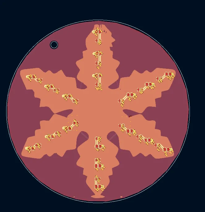

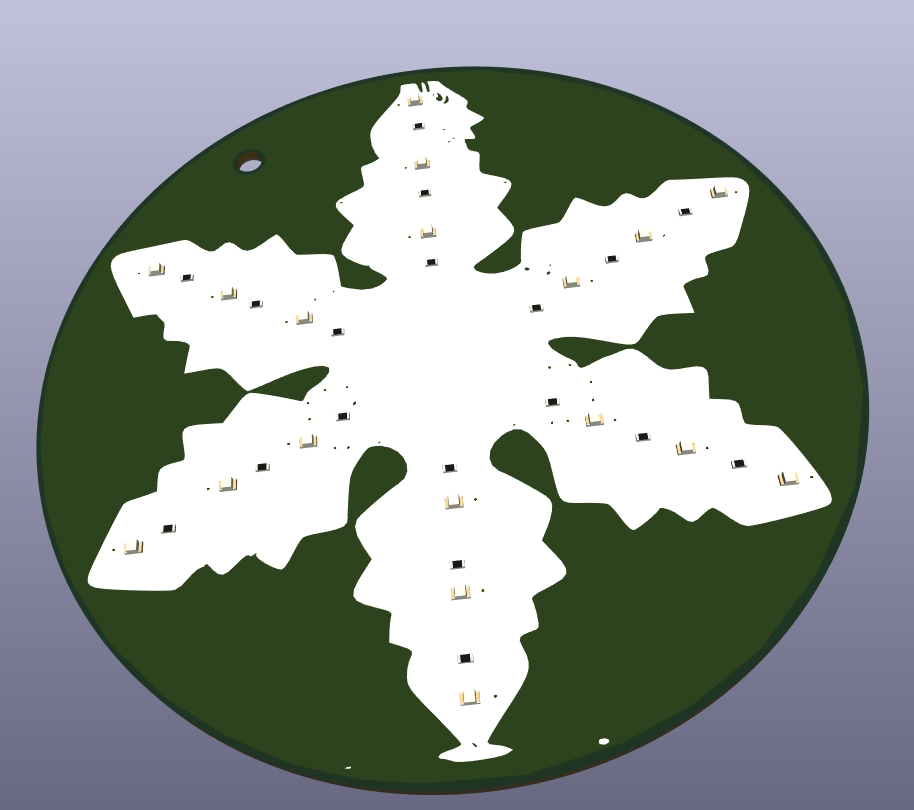

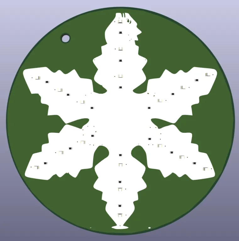

Christmas decoration built on 18 LED diodes.
Christmas ornament

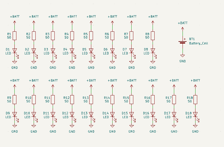

Schematic:
Parts List:
- LEDs (Red)                 x 18
- Resistors 50               x 18
- CR2032 Battery Cell  x 1
