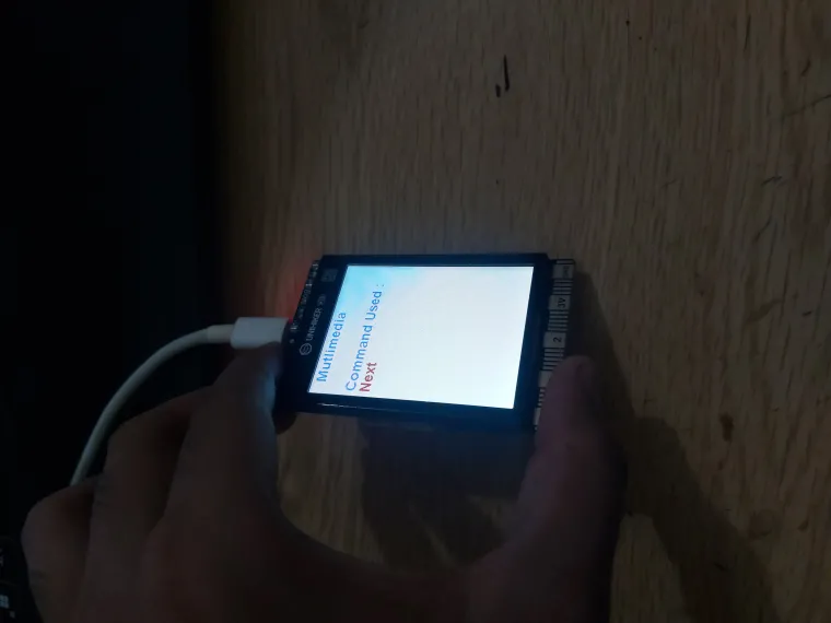

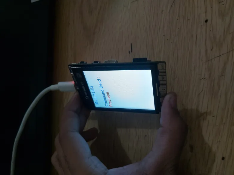

  • Tilt Right → Next Track
  • Tilt Left → Previous Track

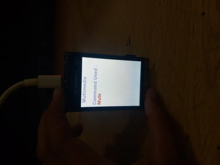

  • Shake (High Acceleration) → Mute
The K10 sends these commands directly to an ESP32 acting as a BLE (Bluetooth Low Energy) Keyboard, which then communicates with any Bluetooth-enabled device — including laptops, PCs, tablets, or phones.
Meanwhile, the K10’s LCD screen displays the current command in real time, giving instant visual feedback every time you perform a gesture.
