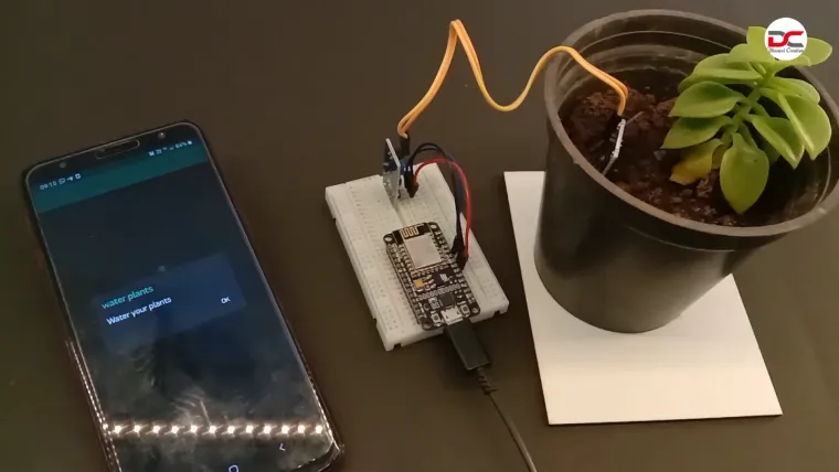

  1. NodeMCU connects to Wi-Fi and initializes Blynk
  2. Reads soil moisture via analog pin
  3. Converts analog reading into a moisture percentage
  4. Sends this data to Blynk app (e.g. gauge widget on a virtual pin)

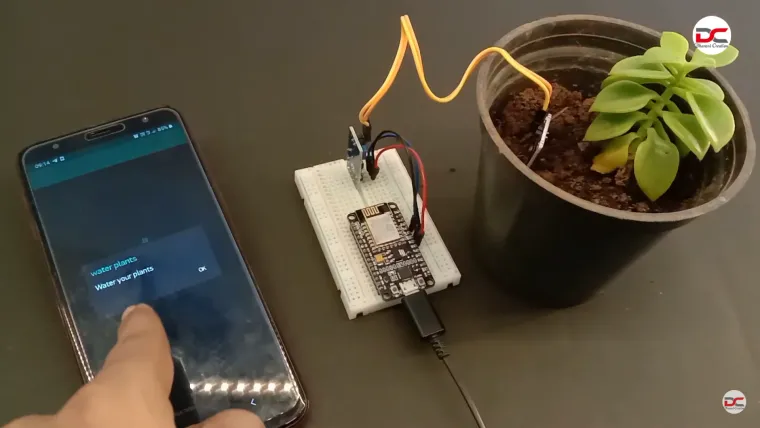

  5. If moisture falls below a user-defined threshold (set via Blynk slider), the system:
    • Sends a notification message
    • Activates the relay to power a mini pump (or other actuator)Optional: Temperature sensor readings can be used to add more controls

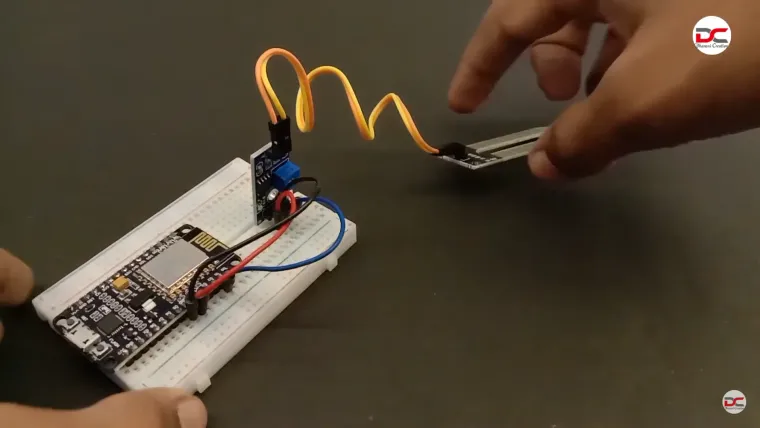

  • Soil Moisture Sensor
    • Power: 3.3V or 5V to sensor
    • GND to NodeMCU GND
    • Analog output → A0 (via resistor divider if needed) Relay Module
    • IN from digital pin (e.g. D0, D4)
    • Relay contacts to control external device (e.g. pump) powered by 12 V or appropriate supply Optional Temp Sensor
    • DHT11/22 or DS18B20 connected to a data pin (e.g. D14/OneWire)
