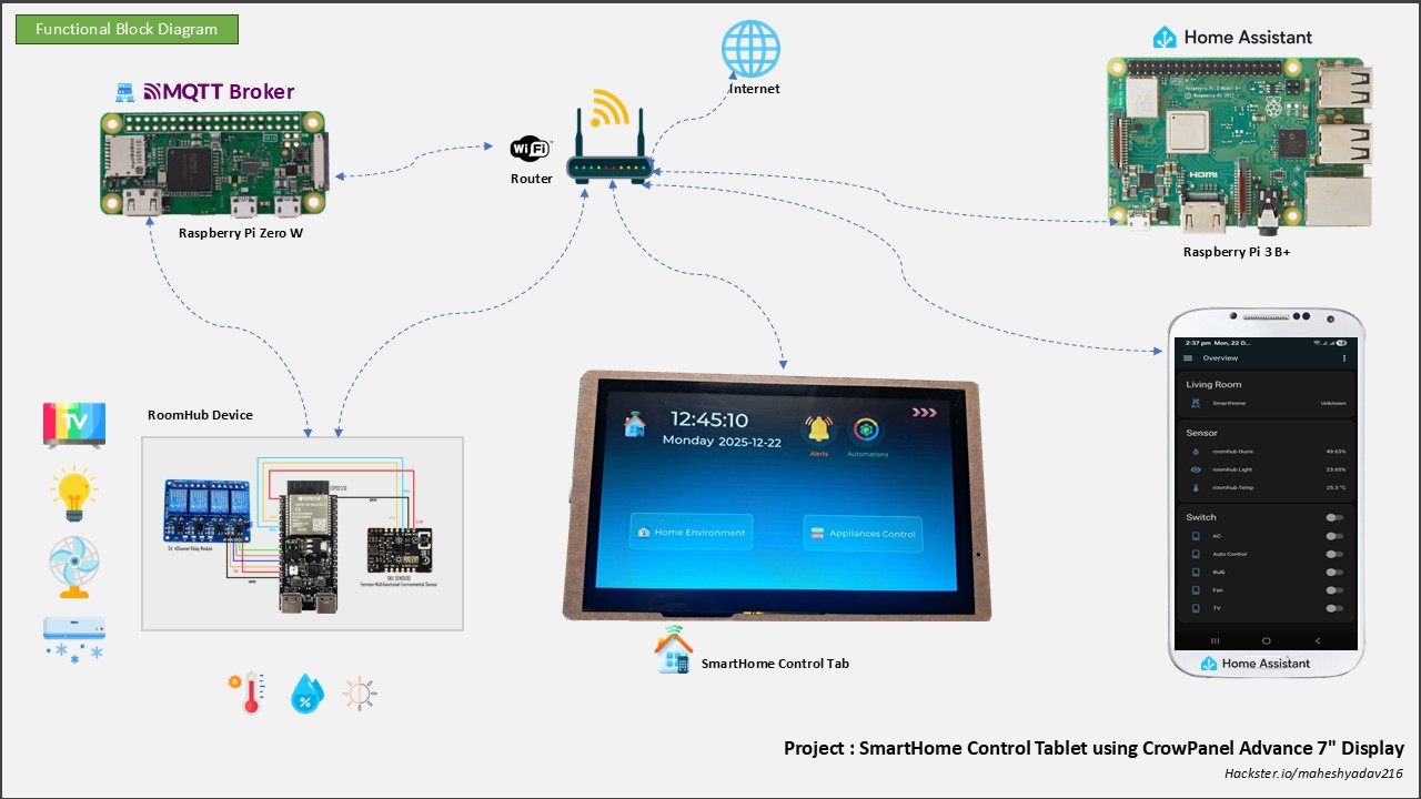

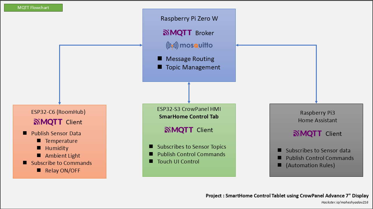

How It Actually Works - The System Architecture
The SmartHome Control Tab isn't a monolithic system. It's designed with clear separation of concerns, which sounds fancy but really just means: if one part breaks, the rest keeps working.
The Main Players:
CrowPanel Tablet (ESP32-S3) - The Star of the Show
  • Renders the entire UI using LVGL
  • Handles all touch interactions
  • Subscribes to MQTT for sensor updates
  • Publishes MQTT commands to control devices
  • Manages the RTC for accurate timekeeping
  • Drives the buzzer for alerts
  • This is what users see and interact with
RoomHub (ESP32-C6) - The Behind-the-Scenes Worker
  • Reads sensors (temperature, humidity, light via SEN0500)
  • Controls relay switches for AC, fan, TV, lights (For demo only 4 appliances)
  • Publishes sensor data to MQTT
  • Receives control commands from MQTT
  • Basically the "muscle" that executes commands
MQTT Broker(Raspberry Pi ZeroW)
  • Acts as the message bus
  • Tablets talks to broker, broker talks to devices
  • Completely local - no cloud involved
  • Think of it as a local post office for messages
Home Assistant (RaspberryPi3)
  • I use it for automation and logging
  • But here's the key: the tablet works even if Home Assistant is offline
  • It's a nice-to-have, not a dependency
So, in our setup
  • Raspberry Pi Zero W → MQTT Broker (Mosquitto)
  • ESP32-C6 (RoomHub) → MQTT Client (publishes sensor data, subscribes to commands)
  • ESP32-S3 CrowPanel (SmartHome Control Tab) → MQTT Client (subscribes to sensor data, publishes control commands)
  • Home Assistant (optional / secondary) → MQTT Client

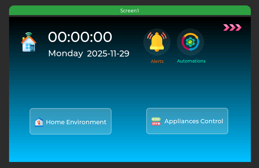

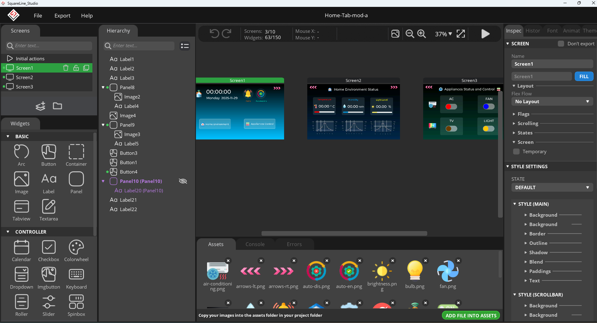

The UI Design - Keeping It Simple
I spent embarrassing amounts of time on the UI. Not because I'm a perfectionist (okay, maybe a little), but because a good interface should be invisible.
I used SquareLine Studio for designing the UI.

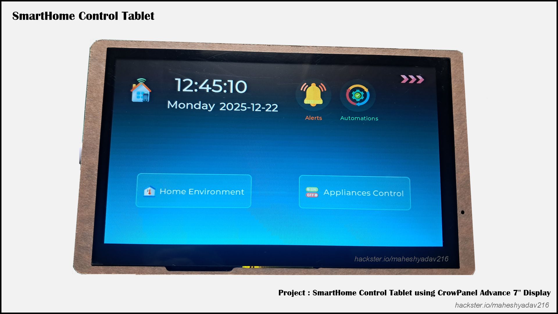

Dashboard
So there are 3 screens, 1. Home, 2. Sensor Readings, 3. Appliances Controls

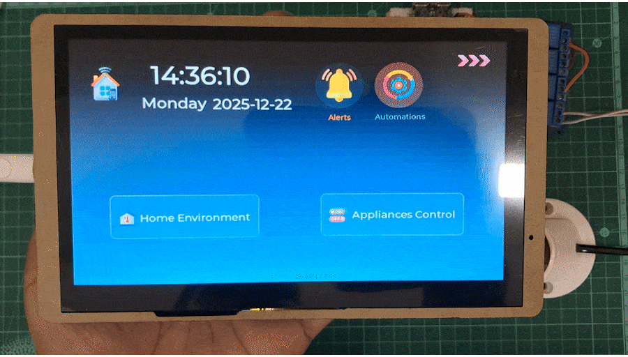

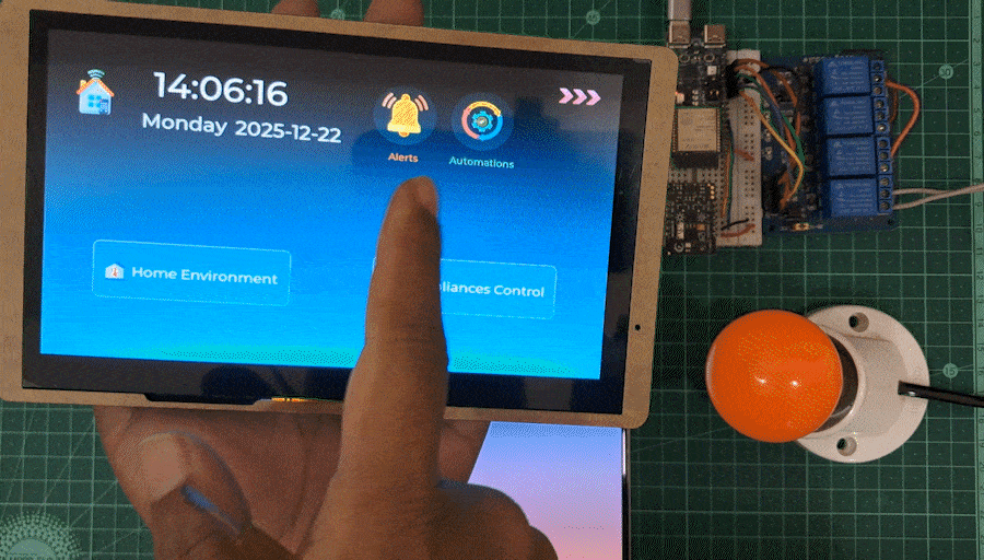

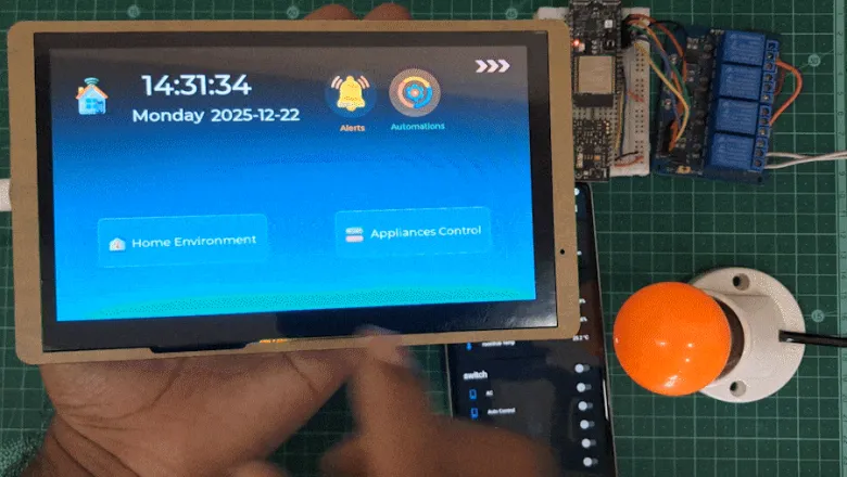

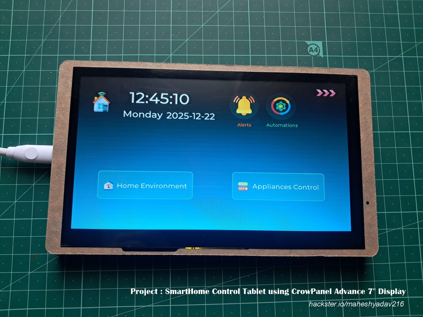

Home Screen
  • Large clock display
  • Current date
  • Day of week
  • Synced via SNTP, backed by hardware RTC
  • Big buttons to navigate towards other two screens
  • Two buttons with 'meaningful icons'. One is to Silence the buzzer Notifications/Alerts and second one is to Control the Automations

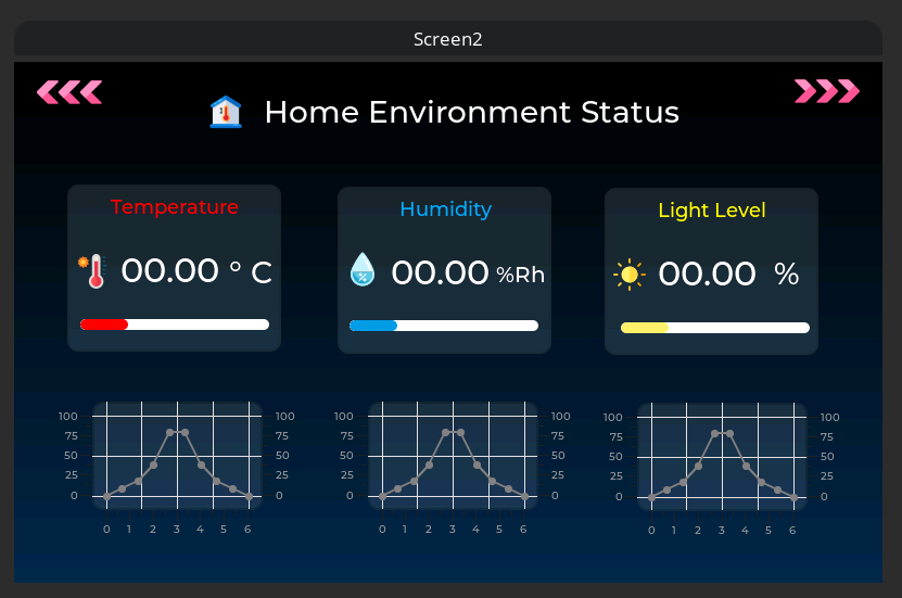

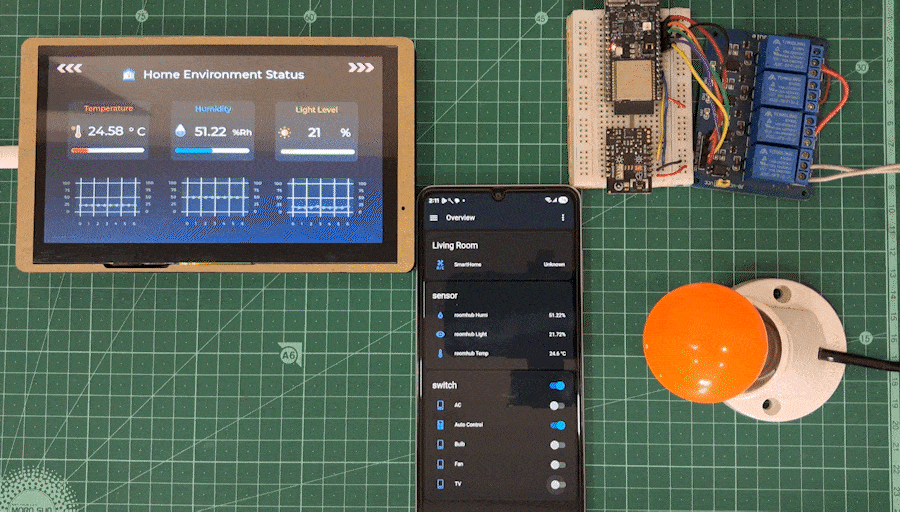

SecondScreen (Home Environmental Readings)
  • Big, clear temperature reading (because squinting sucks)
  • Humidity percentage
  • Light level indicator
  • Real-time updates every 2 seconds

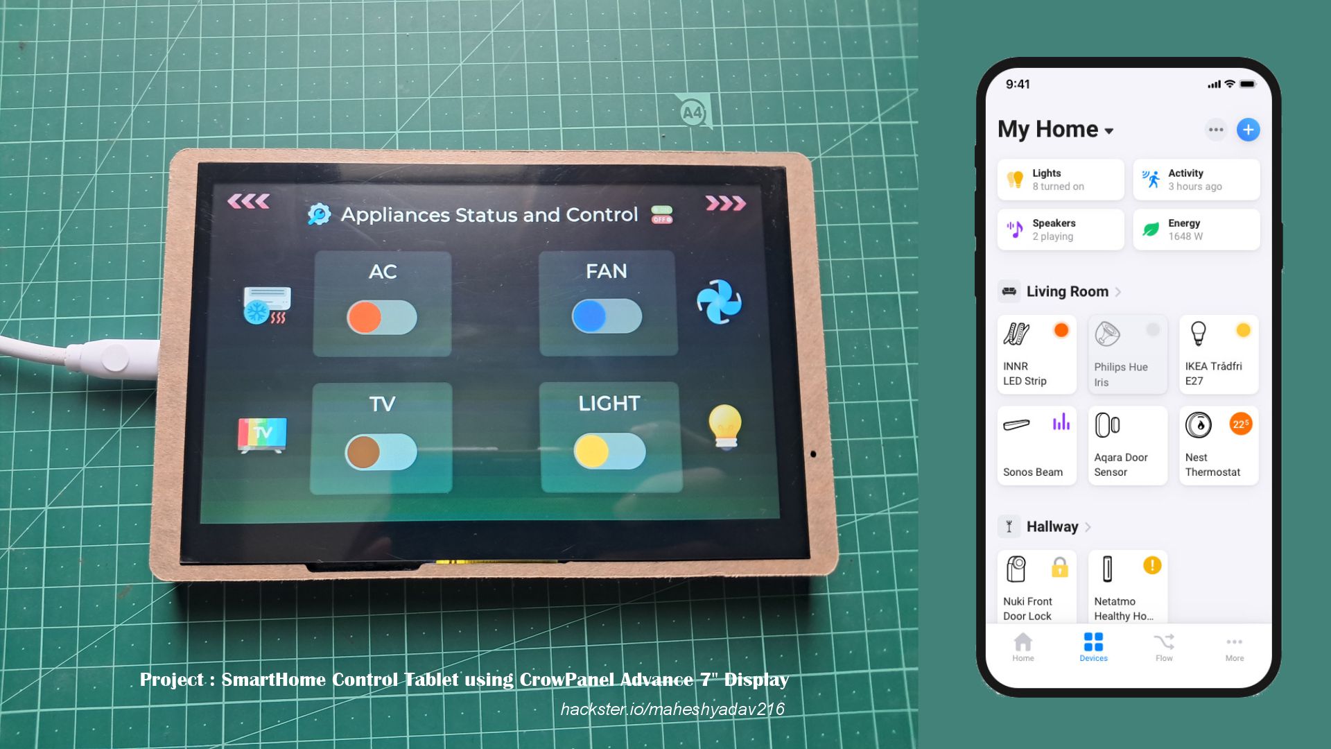

ThirdScreen - Quick Controls : Four big buttons for the essential appliances:
  • AC - Toggle air conditioning
  • Fan - Toggle ceiling fan
  • TV - Power control
  • Lights - Room lighting
  • Each button shows current state (ON/OFF) with color coding:
  • ON state is simulated with shadow effect
  • Tap to toggle, real time view
Navigation through screens - SWIPING through screens is enabled. Also there are big Right and Left Buttons also added
No submenus. No hidden options. Just tap and go.
Why These Design Choices?
Large Touch Targets : Those buttons are 150x80 pixels each. You can hit them without looking. You can hit them with oven mitts on. This isn't a phone - precision isn't required.
Color Coding Over Icons : Icons are ambiguous. Is the fan on or off? With color, there's no guessing. Blue means running, gray means off. Universal and instant.
Minimal Text : Although, Temperature doesn't need a label saying "Temperature:" but with the thermometer icon and °C add more beauty. Less reading, more glancing.
Screensaver : There is 1 min timeout delay to dim the display with (big text "TOUCH TO WAKE" screensaver. And also after five minutes screen goes off.

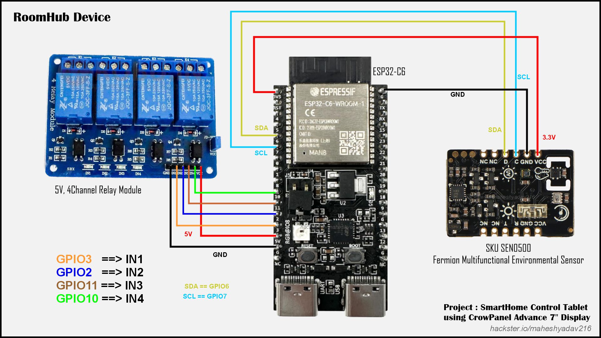

1. RoomHub [ESP32-C6] - Arduino
  • For programming RoomHub device, I used Arduino IDE.
  • I used 'SEN0500 Fermion Multifunctional Environmental Sensor'.
  • This multifunctional environmental sensor comprises SHTC3 temperature & humidity sensor, BMP280 atmospheric pressure sensor, VEML7700 light sensor, and LTR390 ultraviolet sensor into one and offers 5 kinds of environmental parameters.
  • The sensor has an MCU processing chip onboard that converts the raw data of sensor into values with standard unit so you can directly use them. For example, ℃ and °F for temperature, % for humidity, Kpa for atmospheric pressure, lx for light illuminance, and mw/cm² for ultraviolet.
  • The environmental sensor supports two communication methods, UART and I2C.
  • Here you can find its Wiki Page and Here You will get its Arduino Library
  • 5V, 4 Channel Relay board is used to connect the appliances.
  • Code organizes all communication under the home/roomhub/ topic hierarchy - sensor data publishes to topics like home/roomhub/sensor/temperature, while device control happens through command/state pairs (e.g., home/roomhub/relay/ac/cmd for commands and home/roomhub/relay/ac/state for feedback).
  • The beauty of this structure is that ANY client can subscribe to sensor data or send commands - whether it's the CrowPanel tablet, Home Assistant, a phone app, or even another ESP32. The system uses retained messages (the true flag in mqtt.publish()) so new devices joining the network immediately see the last known state without waiting for updates.
  • ESP32-C6 microcontroller that acts as the automated climate control system for a smart room. It continuously monitors environmental conditions using a SEN0500 sensor (temperature, humidity, and light levels) and intelligently controls four devices through relays: an AC unit, ceiling fan, TV, and light bulb.
  • The magic happens in the automatic climate control logic - when temperature hits 27°C, the AC kicks on automatically; when humidity exceeds 54%, the fan starts running; and when the room gets dark (below 1% light), the bulb illuminates. Each control uses hysteresis (different on/off thresholds) to prevent annoying rapid toggling.
  • Code will be shared below in Resources section as well as on GitHub

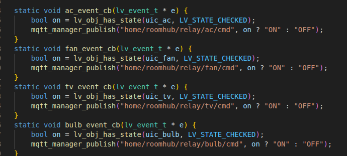

2. SmartHomeTablet : CrowPanel Advance 7" HMI Display - ESP-IDF
  • The tablet uses the PubSubClient library to handle MQTT
  • Tablet subscribes to sensor topics, states of Relays and Automation settings
  • Every time you tap a button, the tablet publishes "ON" or "OFF" to the appropriate command topic. The RoomHub is listening, receives the command, and flips the relay. Simple, reliable, fast.
  • FreeRTOS Task Management - The ESP32-S3 runs FreeRTOS, which means real multitasking. I split the work across three tasks - UI Rendering, MQTT Handler, Alert System.
  • This separation means: the UI never freezes waiting for network or sensors. Even if MQTT is struggling to reconnect, you can still tap buttons and see the interface respond instantly.
  • The Buzzer Alert System -
  • ProjectCode for this HMI Display will be shared below in Resources section as well as on GitHub

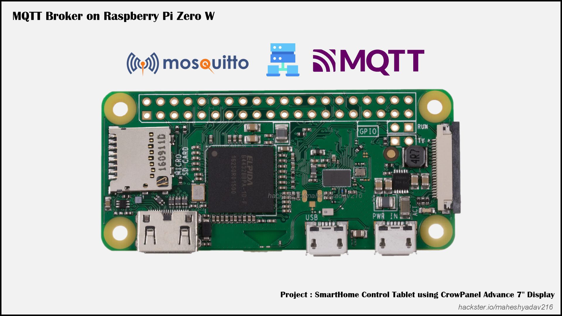

3. MQTTBrokeronRaspberry Pi Zero W
  • I used separate device to run the MQTT broker.
  • Using the Raspberry Pi Zero W as an MQTT Broker makes it the central, always-on message hub of the SmartHome Control Tab system.
  • It allows the ESP32-C6 (RoomHub), ESP32-S3 CrowPanel (HMI tablet), and Home Assistant to communicate directly and reliably, even if Home Assistant is offline.
  • This design improves local autonomy, low latency, and system resilience, turning Home Assistant into an optional client rather than a single point of failure.
  • I have made detailed guide on GitHub - about how to setup RPi Zero W as MQTT broker for this project. You can follow it for instructions and commands

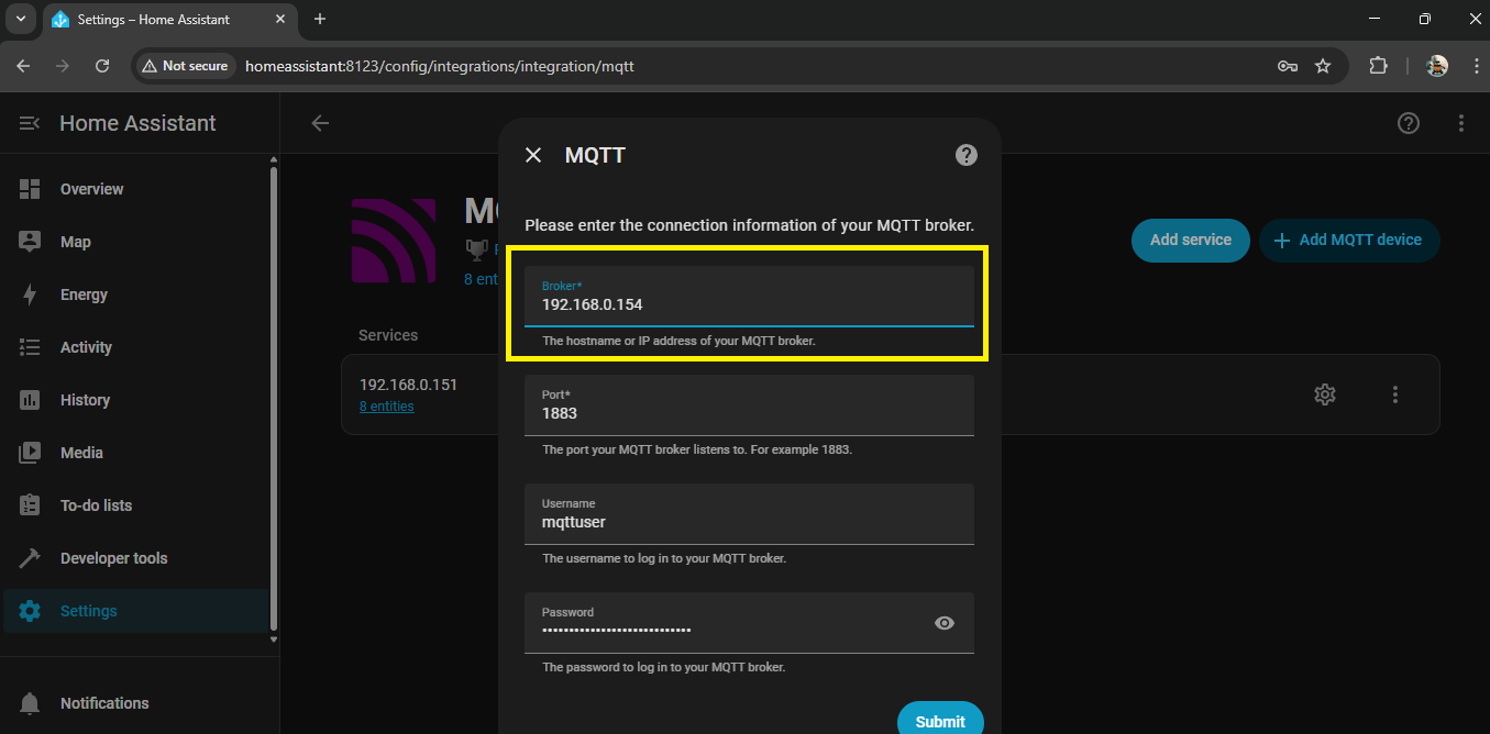

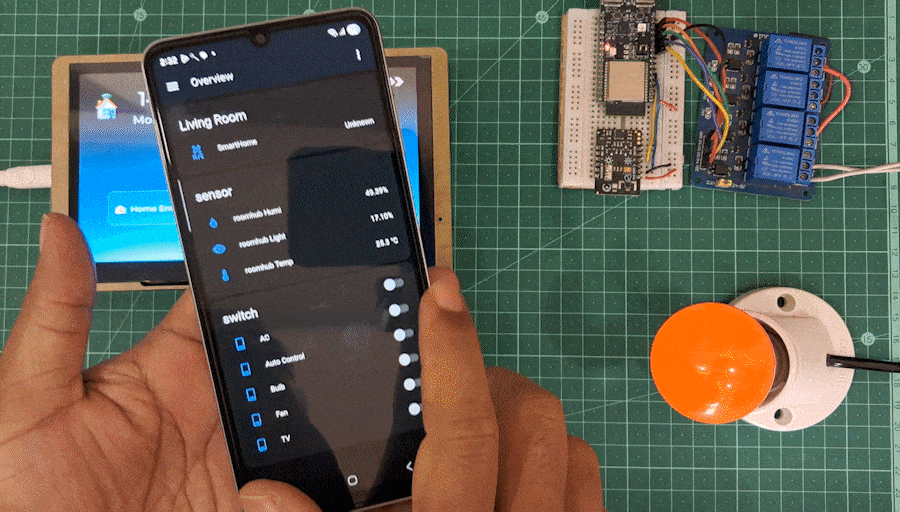

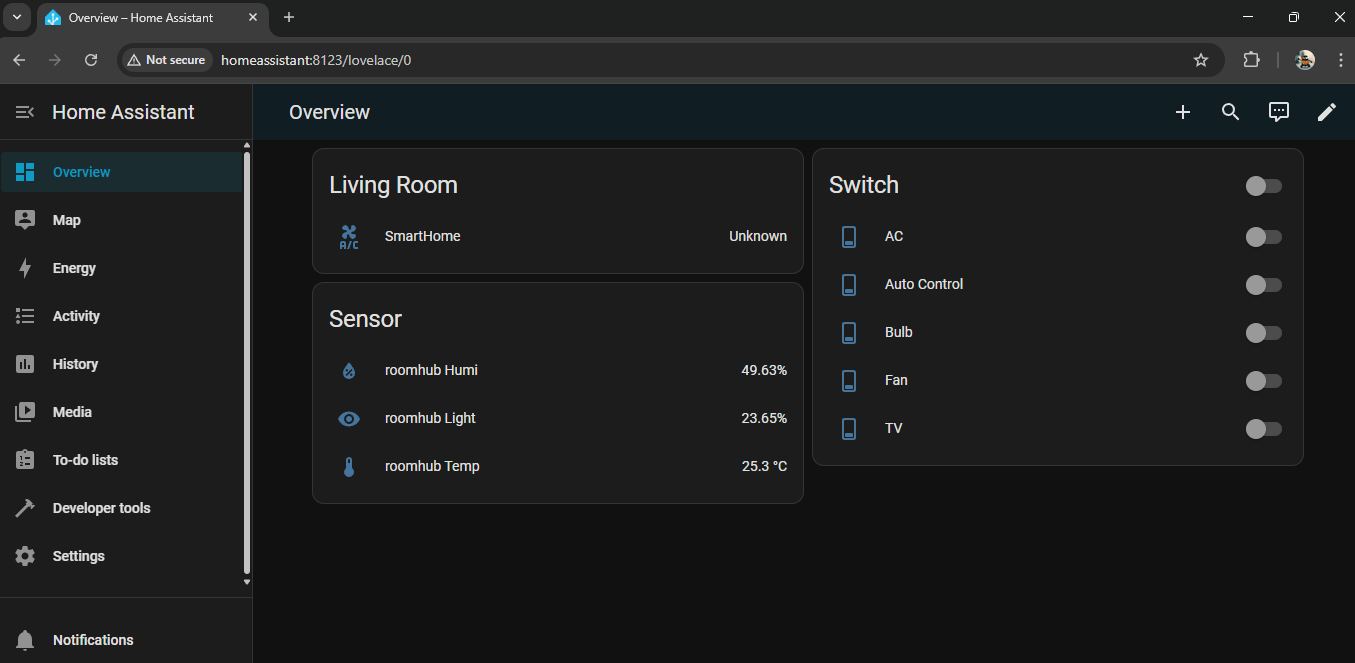

4.Home Assistant running on Raspberry Pi3
  • I have also used my Home Assistant setup running on Raspberry pi3 board.
  • It adds a powerful automation and visualization layer on top of the SmartHome Control Tab system.

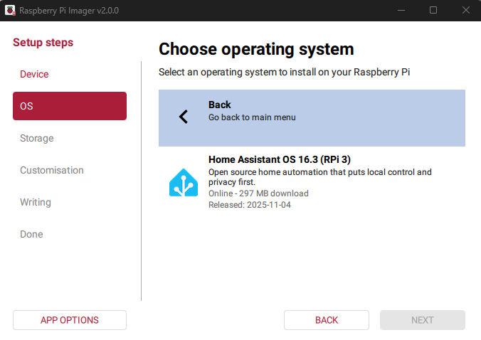

  • You can use Raspberry Pi Imagersoftware to flash the Home Assistant Operating system onto the SD card.

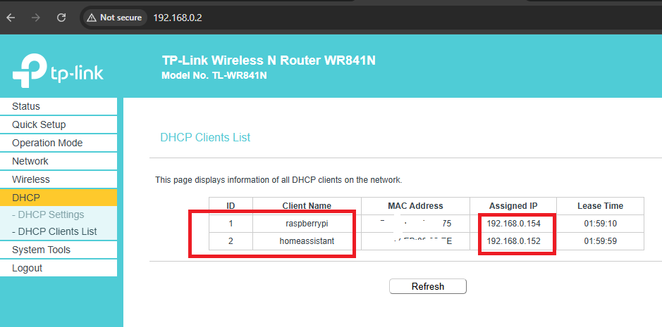

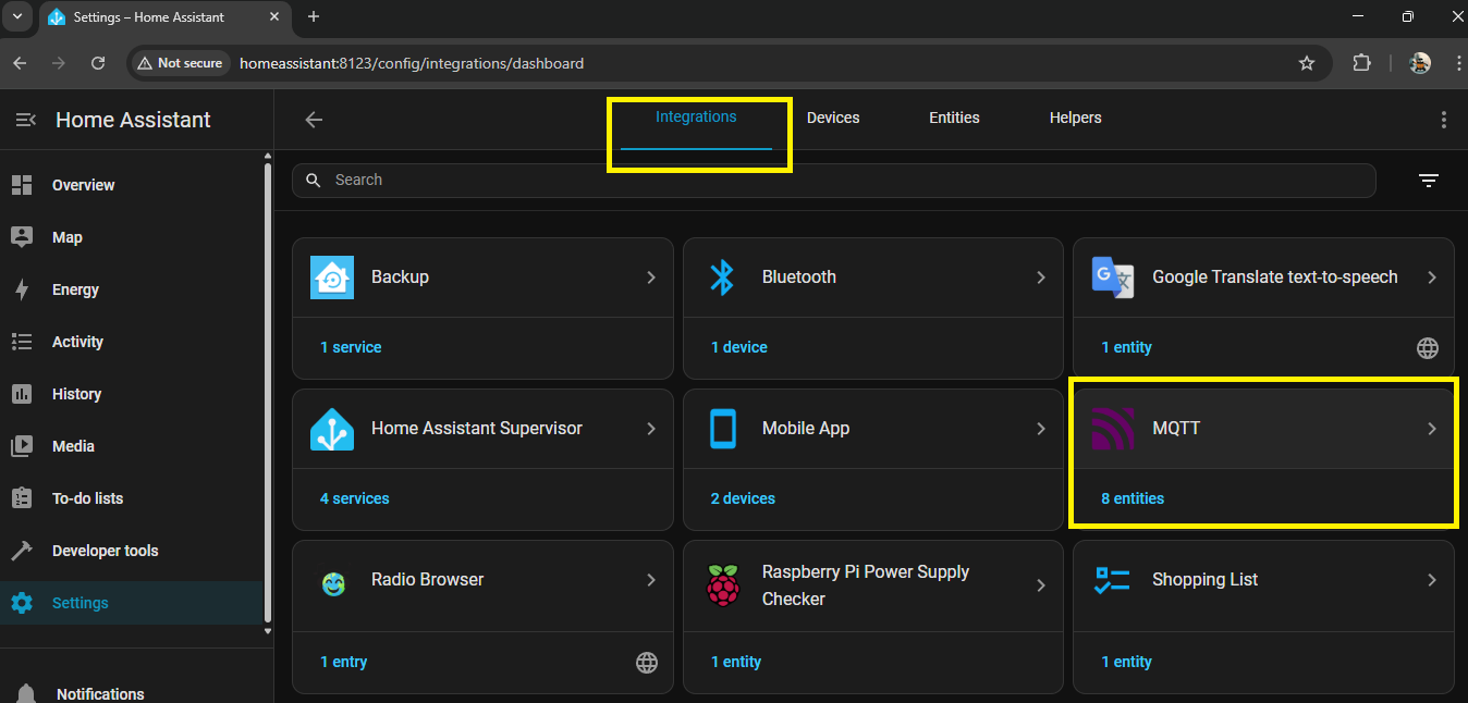

  • In Home Assistant, you have to add 'MQTT integration service' for/to listen to your (RPi Zero W) MQTT Broker
  • You must know the IP of your Broker, for that you can check the WiFi router DHCP client list
  • Enter that Broker IP in MQTT configs like following with port, username and password
  • Home Assistant enables centralized dashboards, historical data logging, and rule-based automations without interfering with the core MQTT-based operation.
  • Above screenshots shows Home Assistant running on PC and Smartphone with dashboard of "SmarHome Tab Project".
Because Home Assistant acts as an MQTT client (not the broker), the system continues to function even if Home Assistant goes offline. This makes Home Assistant an enhancer, not a dependency—ideal for experimentation, monitoring, and future smart automations.

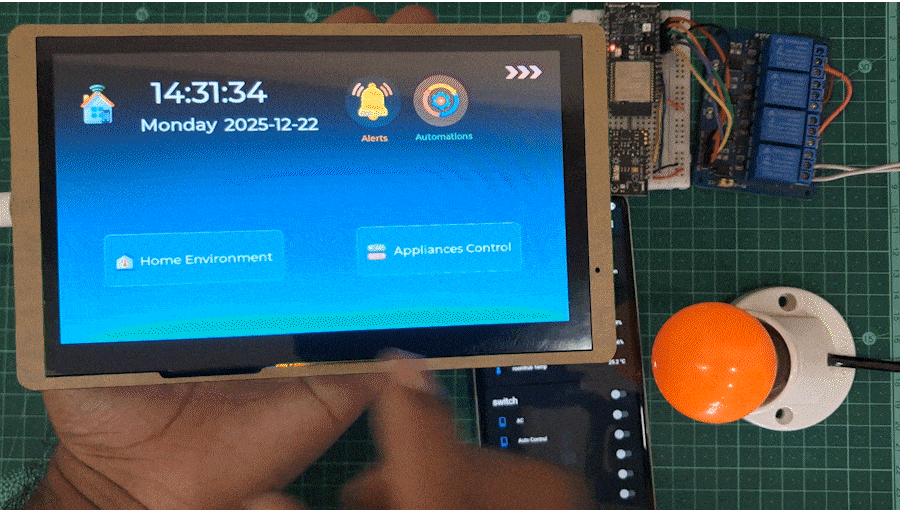

Real-World Usage - Does It Actually Work?
I've had this running 24/7 for two week. Here's what I've learned:
What Works Amazingly:
  • The "glance factor" - Walking past it and instantly knowing room conditions is addictive. No unlocking, no opening apps.
  • Guest-friendly - While I was testing it, My uncle visited. He walked up, tapped "Lights", Bulb came on. No tutorial needed. That's the UX win.
  • Offline resilience - ⛔ Internet went down during a 'fiber cut issue'. Tablet kept working. Controlled all local devices. Clock still accurate (RTC-with battery).
  • Instant response - Tap button, relay clicks within 200ms. No lag, no "thinking" spinner, just action.

Testing and Demos
Check my following video to see the basic demo of SmartHome Tablet
To get started with "CrowPanel Advance 7.0 HMI Display" you can check out my following review videos
