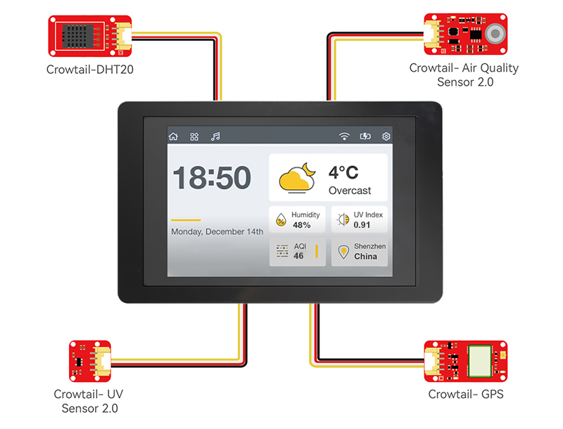

Connect with Crowtail Sensors
It can be connected with 150+ types of Crowtail modules to complete more interesting projects.
ESP32 S3 display with sensors ESP32 S3 touch screen

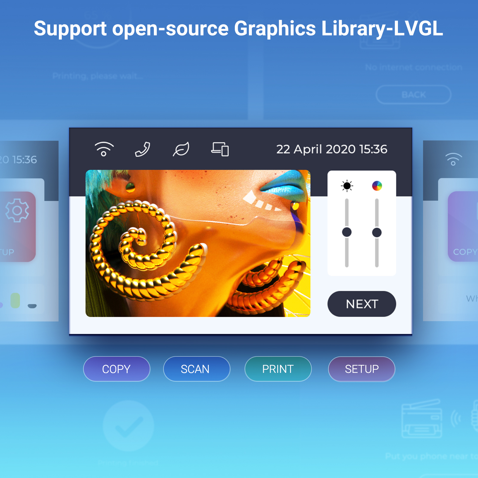

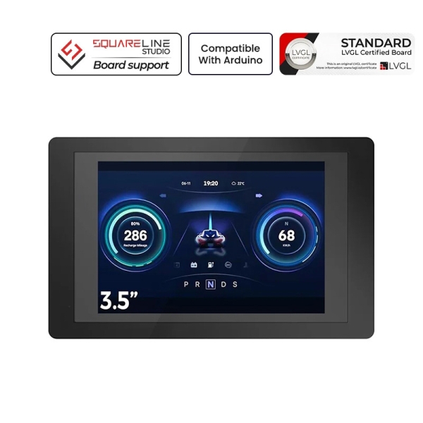

It supports LVGL graphics library. You can design a variety of UIs.ESP32 S3 display support lvgl

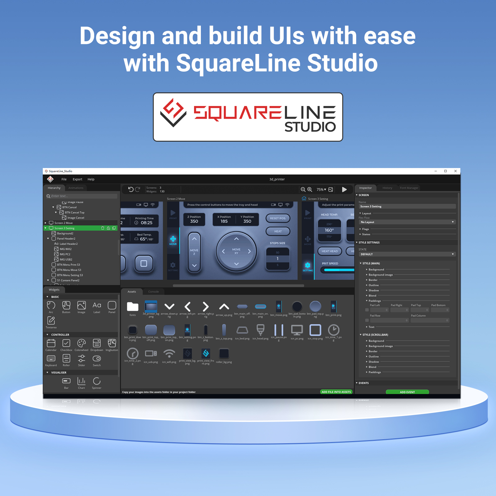

Design and build UIs with ease with SquareLine Studio
Use SquareLine Studios to design and implement your own LVGL UI and export ready to use projects with one click.Squareline Vision has entered BETA, sign up now to get 40% off all licenses. https://vision.squareline.io/ESP32 S3 display support lvgl

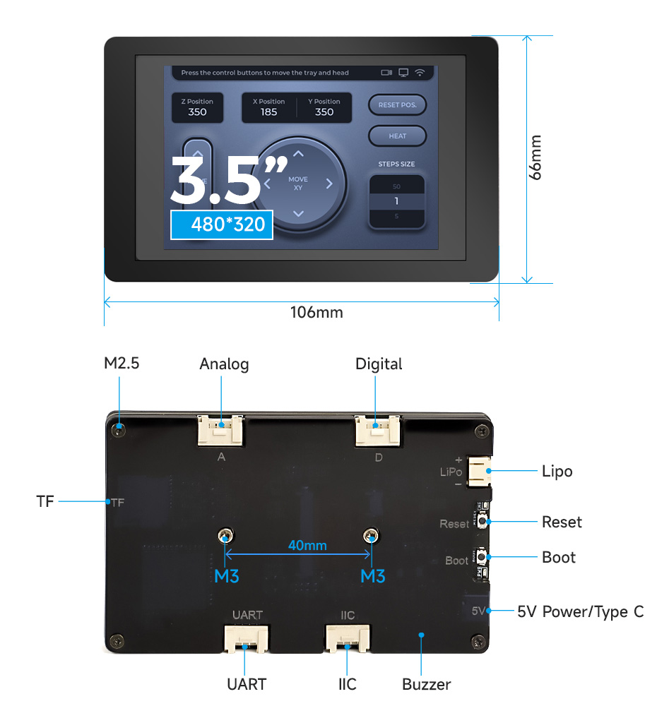

Structure Overviewstructure overview of ESP32 S3 display
ESP32 S3 Touch Screen Hardware Overview
Display for ESP32 S3 touch display overview
  • REST button. Press this button to reset the system.
  • LiPo port. Lithium battery charging interface (lithium battery not included)
  • BOOT button. Hold down the Boot button and press the RESET button to initiate firmware download mode. Users can download firmware through the serial port
  • 5V Power/Type C interface. It serves as the power supply for the development board and the communication interface between the PC and ESP-WROOM-32.
  • 4 Crowtail interfaces. Users can program the ESP32-S3 to communicate with peripherals connected to the Crowtail interface.
  • Integrated ESP32-S3 module, which supports 2.4 GHz Wi-Fi and BLE
  • LCD 3.5 inches parallel TFT-LCD with 480*320 resolution

  • LiPo Battery Interface: PH2.0
  • Operating temperature: -10°C ~ 65°C
  • Active Area: 73.63(L)*49.79mm(W)
  • Appearance Dimensions: 106(L)x66mm(W)*13mm(H)
