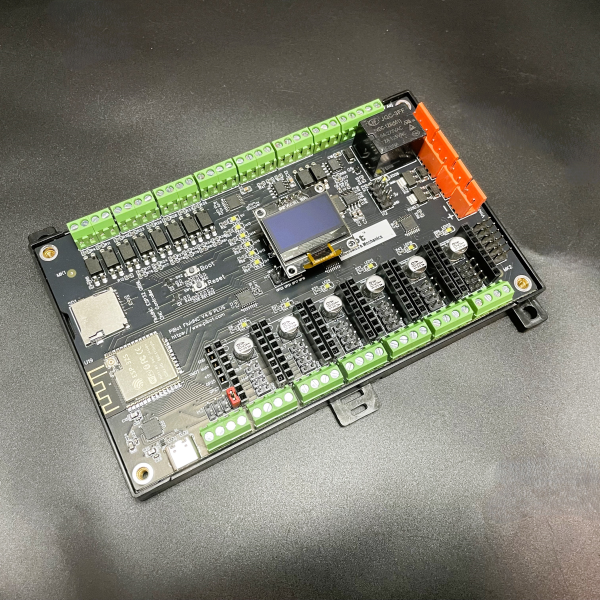

This was designed to control a wide variety of CNC machines. It can control 6 motors and many spindle and laser types. It is very easy to configure. You never have to compile any software. All configuration, upgrading, etc can be done via web browser.
order from elecrow you can get a free antenna
The 2025 Lastest Version is V4.9 Plus B Now in Stock!
2024 V4.9P upgrade to 2025 V4.9PB,
Compared to the V4.9P version from 2024, V4.9PB have incorporated a voltage level selection function, allowing users to choose either 3.3V or 5V as the onboard drviers control voltage.
We have fixed some pin setting errors in V4.9P, and as a result, it can now support TMC2130 and TMC5160 drivers. (the old 2024 version V4.9P can not support TMC drviers)
How to distinguish the new version:
A:The versions shipped in 2025 are all the new ones, which are silkscreened with "PiBot FluidNC V4.9 PLUS B".
B:Below the relay on the PCB, there is a 3-pin jumper cap labeled "Driver Logic Signal Level".
C:The V49PB adopts a new ESP32 original module, which is faster and more stable, thus requiring an extral antenna for WiFi connectivity.
In addition, the other V4.9PB functions remain largely the same as V4.9P. The old documentation for the 2024 V4.9P version can be obtained from the link below.

V4.9P-B  (New!!!!!  in stock!!!!)
The V4.9P-B  feature compare to the before:
1. To make it compatible with a 150 * 90 * 40mm  box. ( it needs to be purchased separately)
2. Change the output connector to a screw method. (use the jumper opinion then can choose output model for extra driver or to motors via the capnut on or off)
3. Change the antenna to an external more faster and stable.
4. The main power supply and stepper motor power supply are input separately.
5. use the plug then can change the output for drivers or motors.
6. Supports onboard TMC2130 and TMC5160 drivers, as well as external TMC5160 drivers. (only for 2025 V49PB)
7. Procuring CP2102 chips from Silicon's official and authorized suppliers.
8. Procuring genuine ESP32 chips from Espressif's official suppliers ensures greater stability and reliability.
The V49 PLUS can adapt a 150 * 90 * 40mm box and use screw
