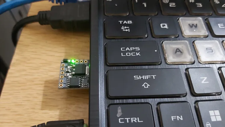

ATTiny85 mouse jiggler
This project uses a Digispark ATTiny85 to act as a USB mouse jiggler. Using the DigiMouse library, it emulates a mouse and moves the cursor in a small square pattern every few seconds, preventing the computer from going idle or locking automatically.

🖱️ ATtiny85 USB Mouse Jiggler
Turn your Digispark ATTiny85 into a compact, plug-and-play USB Mouse Jiggler using the DigiMouse library. This tiny tool keeps your computer awake by simulating subtle mouse movements — perfect for long downloads, presentations, or unattended tasks.

📦 Project Overview
The Digispark ATTiny85 is a low-cost microcontroller capable of emulating USB HID devices. In this project, it acts as a virtual mouse, gently moving the cursor in a square pattern — right, down, left, up — every few seconds.

🧠 How It Works
  • The DigiMouse library initializes a virtual USB mouse.
  • The loop moves the cursor in a small square pattern.
  • A delay ensures subtle, periodic movement to keep the system active.
