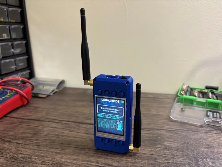

Presenting DualCast! My latest (and most advanced) project to-date. It is a compact wireless device capable of analyzing live traffic on 2.4GHz Wi-Fi networks in addition to being able to send 915MHz AES-128 encrypted, long-range commands via LoRa technology. (Up to over a kilometer on default settings!)
DualCast in Wi-Fi Mode
Flip 180° to activate Wi-Fi mode.

One antenna is optimized for 2.4GHz (Wi-Fi), the other is optimized for 915MHz (LoRa).
When you're done, simply flip DualCast 180 degrees (literally) to put it into LoRa mode. In this mode, you can communicate with your own weather or other sensor stations, dispatch commands (lock/unlock door, turn on/off lights, etc.), or any other applications where an independent long-range signal would be useful. You can kind of think of it as an IoT command center, in which you can communicate with all your other custom devices securely. Just simply click the command you want to send. (Up to 255!)

Using DualCast
Here I'll explain what all the different buttons do and how to use DualCast like a pro! If you just got here, the info on using the receiver is above ^. I'll go ahead and label the buttons as below to make everything easier to explain.
Numbers will flip with orientation!
Okay, so first things first. Turning DualCast on while upright (like above) will put it into LoRa mode. From here, you have the following button options:
  • Button 1 will show your encryption/decryption key and iterate the selected hexadecimal character.
  • Button 2 will show your encryption/decryption key and change which hexadecimal character is currently selected.
    • Use these two buttons to update your key, selecting and then changing it one character at a time.
  • Button 3 will subtract 4 from all number commands at the bottom.
  • Button 4 will add 4 to all number commands at the bottom.
    • These two are used to change which number (as a command) you want to send to the receiver. For example, if the receiver is listening for a 2, or 8, or 12, etc., you can update the range here.
  • Buttons 5-8 will just send whichever number is above it. For example, if there is a 1 above button 5, when you press button 5 it will send a 1.
