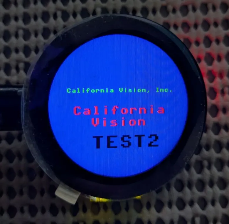

The sample code displayed in the video uses the LCD_1inch28 class from the gc9a01 library to display a message on startup and then shows text and colors in a while loop. The video shows the device running the LCD.py program from the repo.

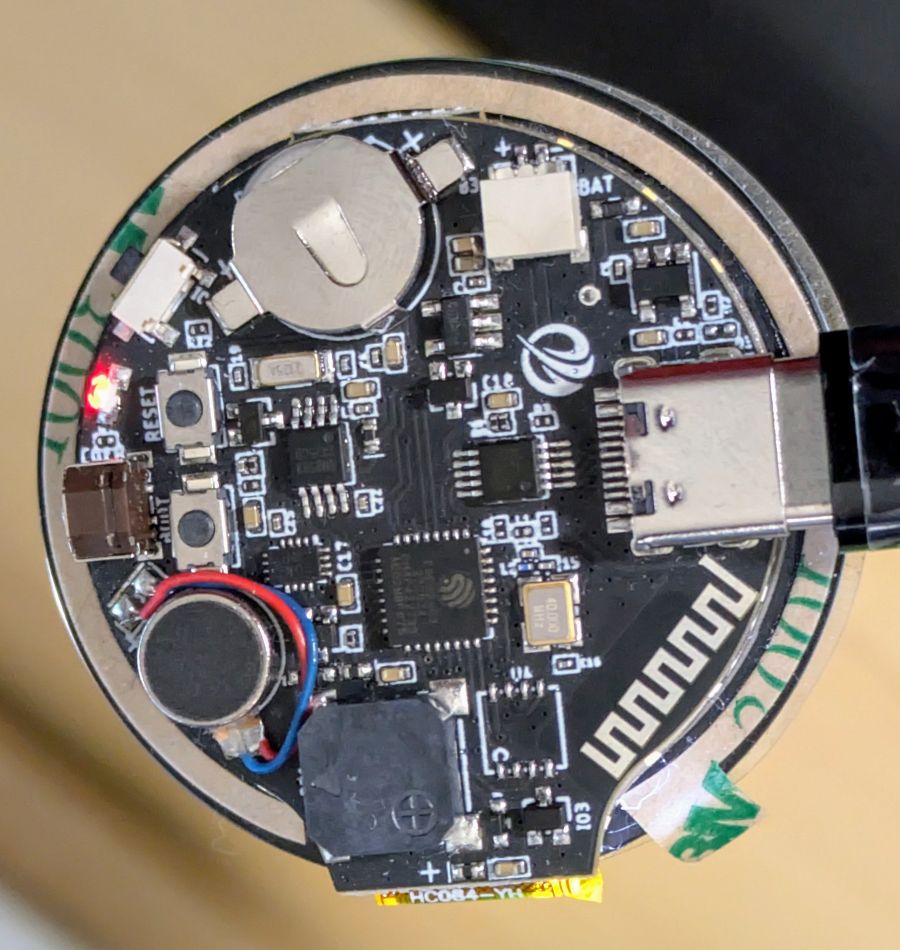

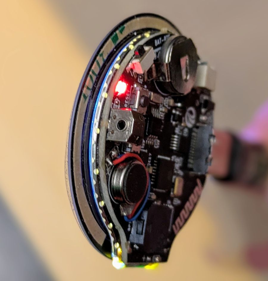

I will update this post to explain the code used for the display loop. These photos show features like the RTC unit, buzzer, ceramic antenna, and rotary encoder:
Elecrow 1.28" Round Display - Rear
CrowPanel Rotary Encoder
Rotary Encoder
