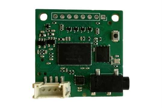

TinyTTS is a compact neural text-to-speech module — a small microcontroller-based board with embedded TTS software — designed to bring natural, on-device speech to hardware products and DIY projects.
It receives short text messages over UART and outputs natural speech in real time.
Because the voice is generated dynamically, the device can speak anything the firmware provides: updated weather data, different forecast patterns, localized time phrases, or custom messages you design. There’s no need to store or manage audio files, and no internet connection is required for speech.
[Data Fetch] → CrowPanel → (UTF-8 text) → UART → TinyTTS → Speaker

Connecting the Hardware
Connecting the hardware is simple and takes only a few minutes.
  • Use the 4-pin UART cable to link the CrowPanel to the TinyTTS module
  • (TX → RX, RX → TX, 5V, GND).
  • Plug your speaker into the TinyTTS audio output.
  • Power the CrowPanel through USB-C.
  • After flashing the firmware and sending the settings from the desktop Setup tool, the device will automatically communicate with TinyTTS and start generating speech.

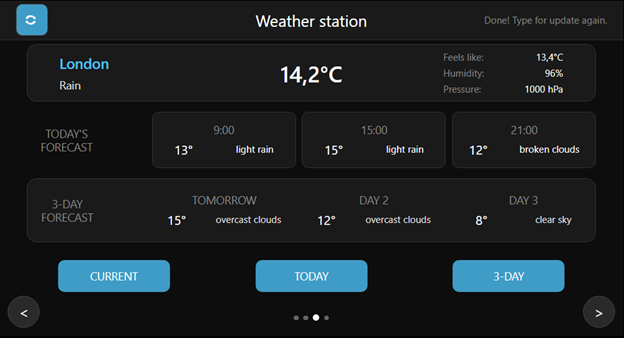

Weather Screen
The Weather screen is the heart of the project.
It shows:
  • current temperature and conditions,
  • “feels like,” humidity, and pressure,
  • a short-term forecast for today,
  • and a three-day outlook.

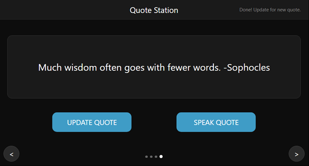

Quotes Screen
Displays a short inspirational quote that updates automatically.

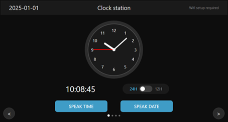

Clock Screen
A clean digital clock with the current date.

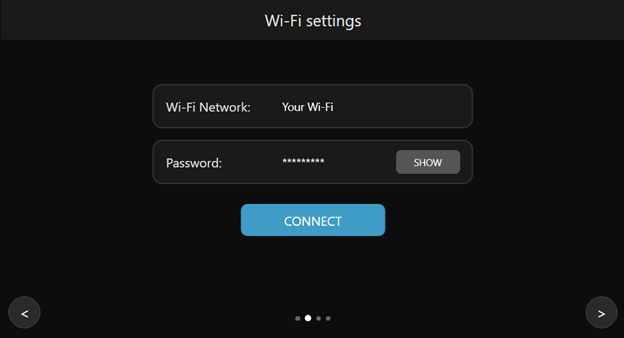

Wi-Fi & Status Screen
Shows the connection status and indicates whether weather data can be updated.
Most configuration happens through the desktop Setup tool, so this screen stays minimal and unobtrusive.

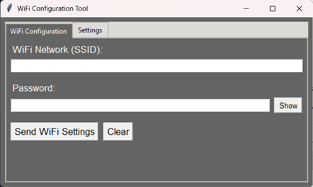

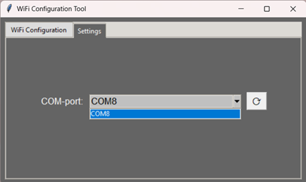

Setup Tool
The project includes a small desktop Setup tool that sends all required settings to the CrowPanel over USB — no typing on the touchscreen is needed.
  • Select the correct COM port,
  • enter your Wi-Fi network name and password,
  • and send everything to the device in one click.
