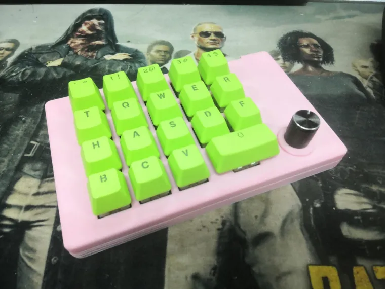

Have you ever thought about DIYing a multifunctional mechanical keyboard for yourself? It can not only meet the needs of your design work, but also switch to various gaming keyboards at any time. For example, PlayerUnknown's Battlegrounds, League of Legends, etc. And just such a multi-functional mechanical keyboard can be realized for only 30 dollars. Then, let's start designing this multifunctional mechanical keyboard!

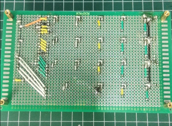

Step 3: Wiring
Wiring
Wiring
According to the wiring diagram, cut jumpers of different sizes and route them on the soldering board.
Turn the soldering board over, and use a soldering iron to solder all the soldering holes through the jumper with tin.
Step 4: Solder Jumper
1. Turn the soldering board over, and use a soldering iron to solder all the soldering holes through the jumper with tin;
2. Use scissors to cut off all excess raised jumpers.
Step 5: Fix the Raspberry Pi Pico
Insert the Raspberry Pi Pico into the designated position of the soldering board, then turn it over and solder it with tin, and trim it.

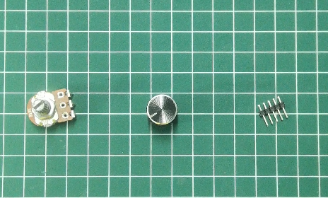

Step 6: Fix the Potentiometer
Cut the three pins of the potentiometer short, and solder it to the 5P pin header with the electric soldering iron.
Step 7: Continue Welding
Continue Welding
Continue Welding
Flip the solder plate over and connect all the individual solder points with jumpers according to the solder wiring diagram.

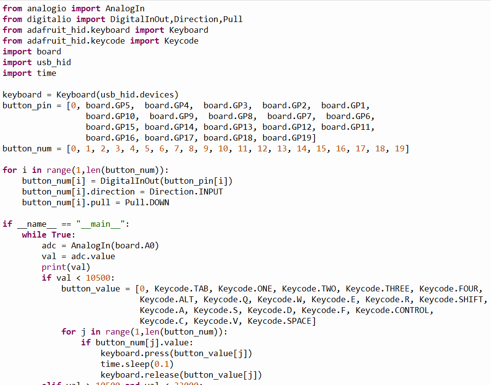

Step 8: Programming
Programming
Here we need to install the circuitpython version of the firmware first, and you can find it by directly searching the circuitpython official website.
In addition, the two library files "keyboard" and "keycode" are also required, which can be found by searching "Adafruit_CircuitPython_HID" on GitHub.
Step 9: Program Testing
By obtaining the value of the potentiometer and judging which range the current value is in, that is to switch the mechanical keyboard to the function defined by the range.

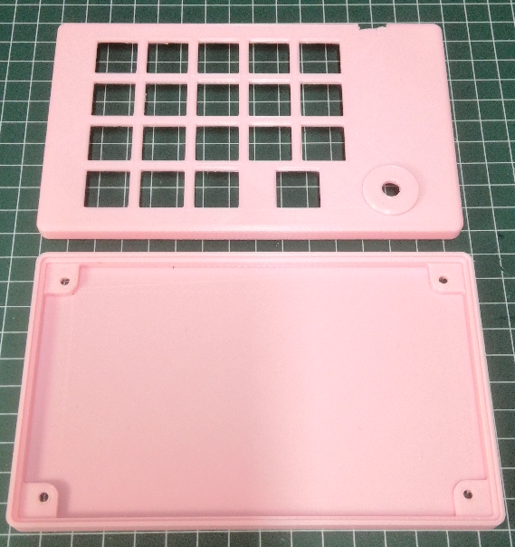

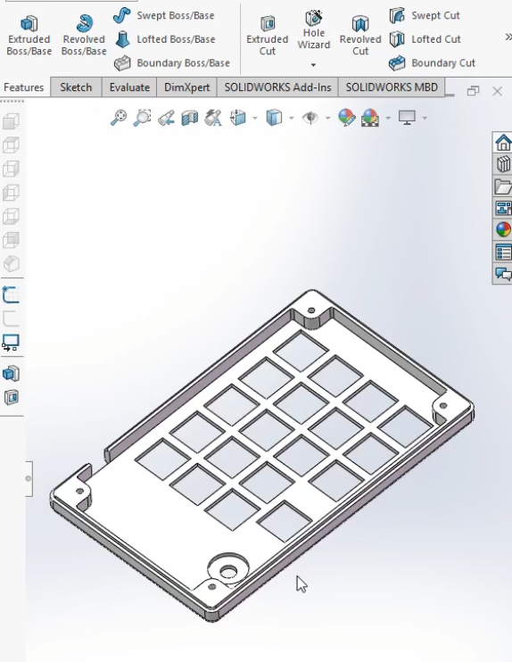

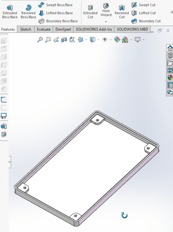

Step 10: Structural Design and 3D Printing
Step 11: Assemble and Install
Here we need to remove all the keycaps before assembling.
In this way, our mechanical keyboard is assembled.
(For detailed operation video, please view the compressed file)
