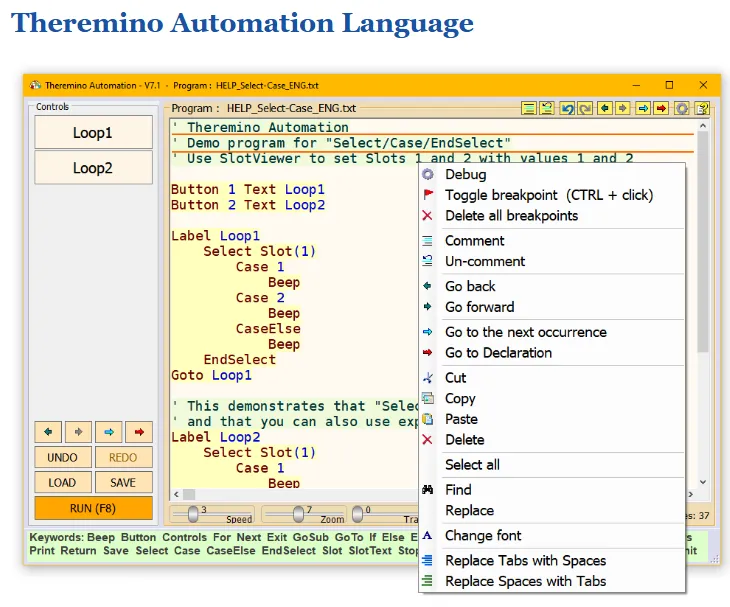

Theremino Automation programs typically consist of an initialization section followed by procedures.
Initialization: The program begins with an initialization section, which usually ends with a STOP instruction. This section is for setting up the program and any initial parameters.
Procedures: Procedures begin with a LABEL and are executed when called by buttons or other events. These procedures are like functions and are called when a specific event occurs.

Debugging: The software includes a debug panel, which helps to understand the values of variables during execution. The debug panel shows the values of variables, expressions, and slots, updated in real time.
Text Box: There is a text box that can be used to display multiple lines of text using the Print command. The Controls OpenTextBox command opens the text box, while Controls CloseTextBox closes it. The text box can be resized by dragging the gray bar separating it from the program area.
