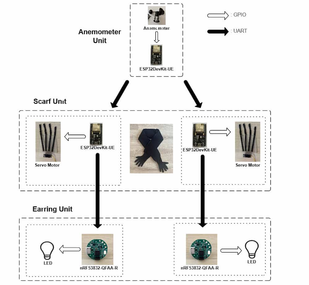

This project is designed to translate wind into tactile feedback. First, the anemometer detects wind, and send wind data to the scarf's ESP32. Then the scarf's ESP32 sends it to the earring's nRF52832, and controls the servo motors. After that, the earring blinks the LED inside like candle frame.

Components

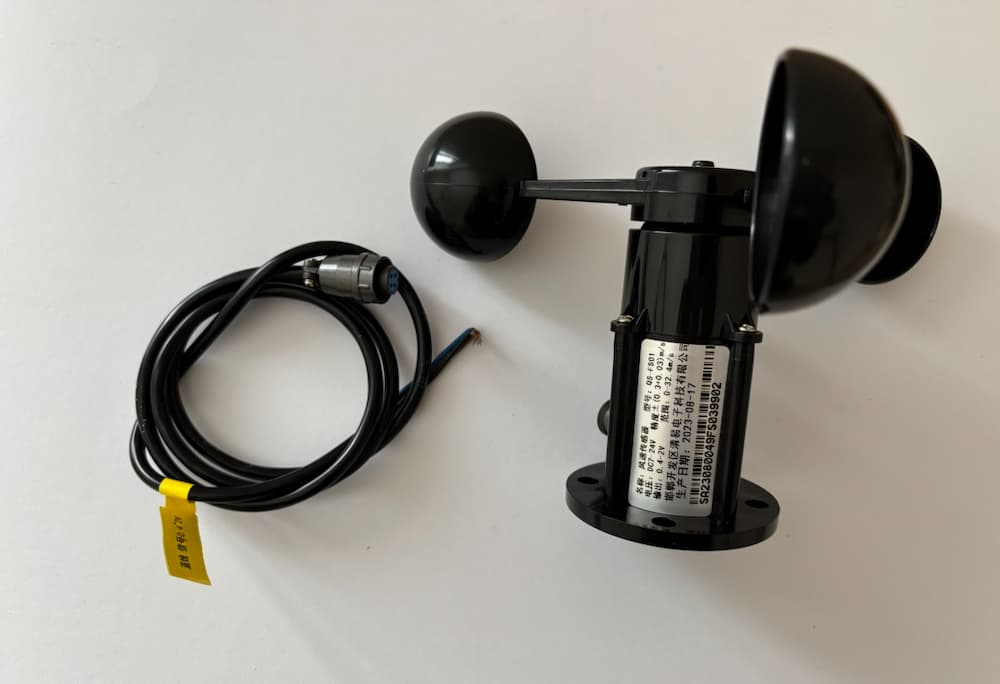

🌬️The Anemometer (ESP32DevKitC) Detects wind and sends the data to the scarf.
Anemometer
🧣 Scarf (ESP32DevKitC) Receives wind data from the anemometer, sends it to the earring, and controls a servo motor.
Scarf

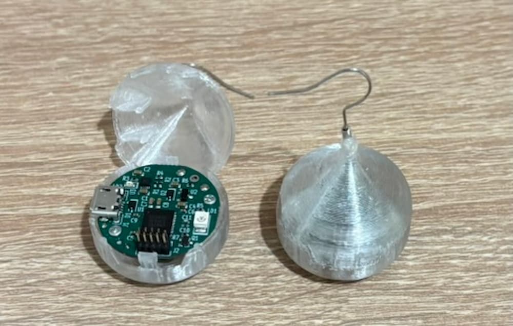

💍The Earrings(nRF52832) Receive wind data from the scarf and controls LED blinking.
Earring1
Earring2

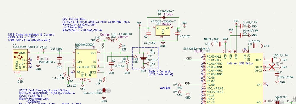

1. The Charging Circuit
Charging Circuit SCH
