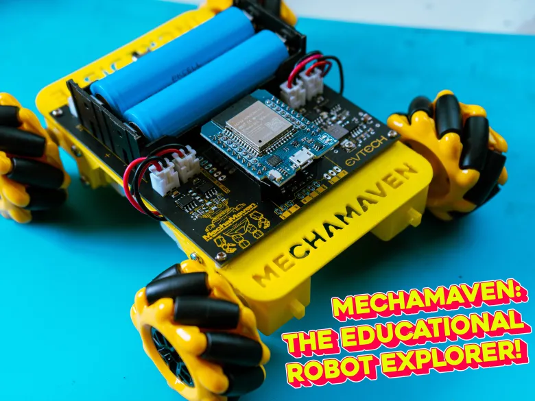

Hi everyone! I'm Earl Daniel Villanueva, the founder of Evtech, and for today's project, we're going to build MechaMaven: The Educational Robot Explorer.
But hey, you might be wondering, Earl, how can you claim that this is an educational robot?
Well, I specifically designed this for educational purposes. It has 10 output pins to connect 10 sensors or an LCD. It also has 2 output pins for the I2C interface. It includes 4 motor drivers to operate 4 motors, with the option to add up to 6 servo motors. Also, it is equipped with a passive buzzer to play music, and much more! This robot can be controlled using a PS3 controller, a mobile phone, and a computer. But for today's video, we are going to focus on controlling this robot using a PS3 controller.

The first thing we need to do is print the body of this robot, followed by printing these 4 pieces of spacer.
Soldering Time!
First, we need to place the stencil on top of the PCB. Then, apply a decent amount of solder paste and spread it over the holes in the stencil. After doing that, remove the stencil from the PCB.
Next, place all the SMD components, starting with the L9110S IC, followed by the 0.1 uF capacitor, and the 10k resistor. From this point, I'll just list the names and values of the components based on their placement on the PCB: a 22uF capacitor, a 10 uH inductor, a 26.1K variable resistor, an MP2307 IC, a 10K resistor, a 3.9 nF capacitor, a 6.8K resistor, a 0.1 uF capacitor, a 100K resistor, and two 10 uF capacitors. Repeat this process on the other side of the PCB. Also, don't forget the LED indicator light and the 1K resistor. Look at that! It really looks awesome! Now, using a hot air rework station, melt the solder paste, which will effectively position the components correctly.
After that, it's time to solder all the THT components, starting with the 2-pin JST female connector, followed by the slide switch. Next, solder the 3-pin and 4-pin JST female connectors, the 18650 battery holder, the passive buzzer, and the female header pin for the ESP32.
And there you have it, we're done placing all the components on the PCB.
Yes, of course, I have provided the Gerber files and the schematic diagram for this project.
Now, it's time to solder the male header pins of the ESP32
The 3D Printed Body
Now it's time to attach the PCB to the 3D-printed body. Start by inserting the 4 pieces of 1.8mm x 10mm screws into the PCB, making sure to place the spacers between the PCB and the 3D-printed body. After that, secure them with the nuts.
The Motor
Of course, this robot car will not work without the motors. We need to attach all 4 motors to the 3D-printed body first. Secure them in place using the 2.7mm x 29mm screws and their nuts.
Solder the Wires of the Motor
In this part of the tutorial, we need to do some soldering again. We need to solder wires from the PCB to the motors, and we will use the 4 pieces of 2-pin male JST connectors.
For the orientation of this robot, remember that this is the front part. If you look closely at the PCB, there are indicators showing where to connect the wires from the motors to the PCB. For instance, "MFR" stands for Motor Front Right, meaning this is where you will connect the wire from the front right motor of the robot to the PCB. So make sure to take note of that.
The Mecanum Wheel
Now, we need to attach the Mecanum wheels to the shafts of the motors. Before doing this, make sure you are placing the wheels in the correct orientation. The Mecanum wheel has a specific mechanism and will not work properly if it is not placed correctly.
If you look closely at the Mecanum wheel, there are labels indicating whether it is for the right or left side of the robot. So in this case, since these are the wheels for the right side, I'll attach these two wheels to the right side, and the other two to the left side of the robot.
