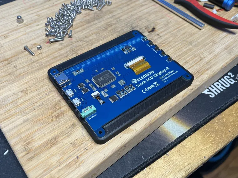

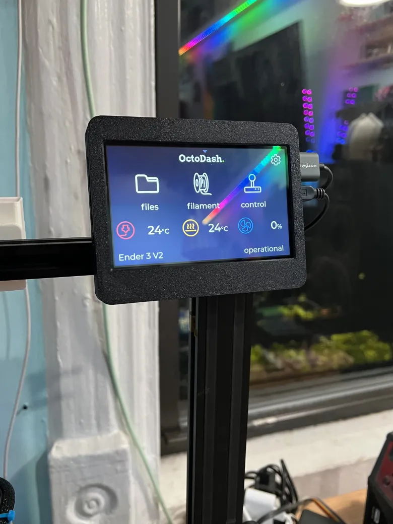

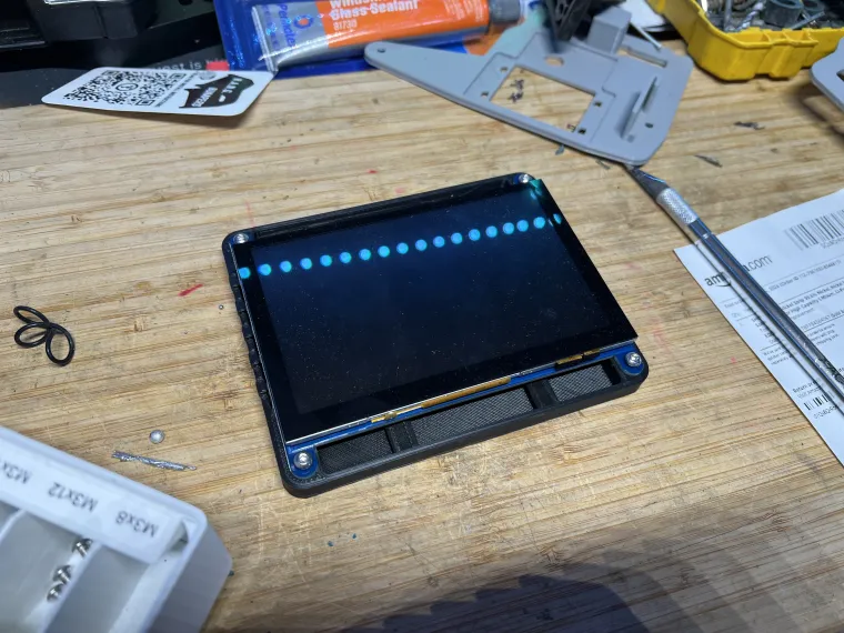

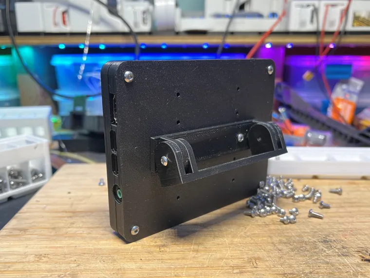

With this customizable case for the Electrow RC050 5-inch HDMI touch screen, you can easily mount the screen any printer with T-slot rails! Designed with elegance and flexibility in mind, the case has perfect cutouts for all of the ports, and tactile buttons to control the display. The case has a hinge with 5 height adjustments and can be mounted on the front or top of the rail with T-nuts.
