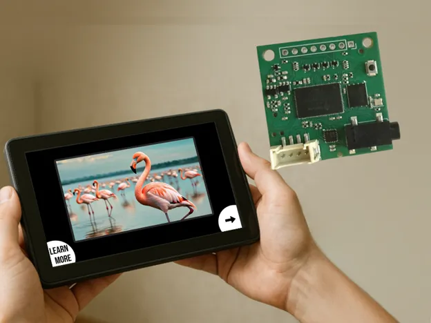

Kids love quizzes — especially when the screen actually talks back to them.
In this project, we turn a simple animal quiz into a small interactive console: the child reads a question on the Elecrow CrowPanel, taps an answer, sees the animal on the display, and then hears a short explanation spoken aloud by the TinyTTS module. Everything runs completely offline, with instant response and no cloud connection.
For makers and educators, this build is more than just a demo. It’s a reusable pattern: a touch UI on a CrowPanel plus a local TinyTTS speech module. You can keep the animal theme, or reuse the same structure for geography quizzes, museum exhibits, classroom posters, or any other “picture + short story” content.
In this project, you’ll build:
  • A touch-driven animal quiz running on the Elecrow CrowPanel 5" (ESP32-S3).
  • A simple two-screen flow: Question → Answer with image → “Learn more” text.
  • An offline TinyTTS speech module that speaks both the quiz question and the “Learn more” explanation through a speaker or headphones.
  • A reusable template where you can swap animals, text, and images to create your own themed quizzes or educational displays.
