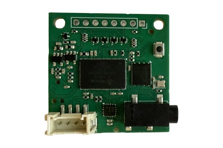

TinyTTS Module

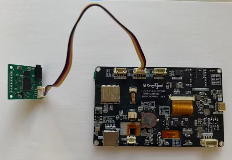

1. Connect the CrowPanel to your computer via USB/Serial.
Set the panel’s function-select switch to “WM(0,1)” (UART1-OUT mode).
Do not connect the tinyTTS module yet.

3. After flashing:
Connect the tinyTTS module to the CrowPanel (UART0 ↔ UART1-OUT) with the 4-pin cable.
Attach the audio output (3.5 mm jack) from tinyTTS to a speaker or headphones.

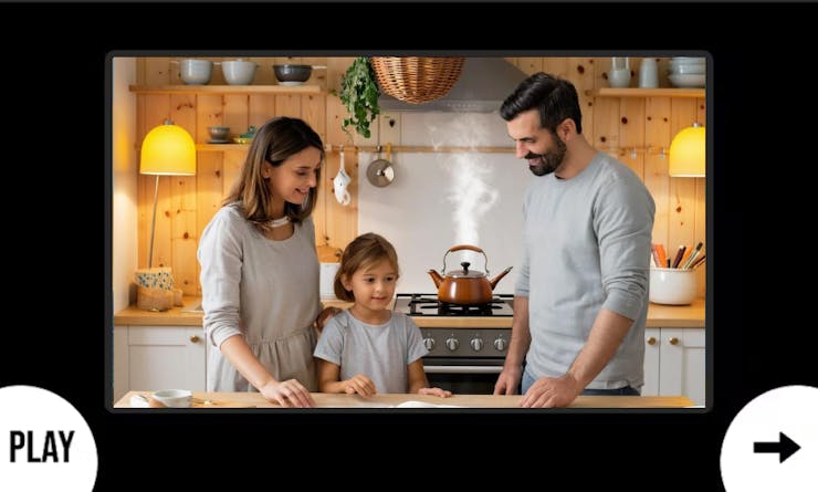

5. Run the demo:The screen shows a photo card.
    • Press Play - the card text is spoken by tinyTTS.
    • Press "→" - next card appears (looped list).

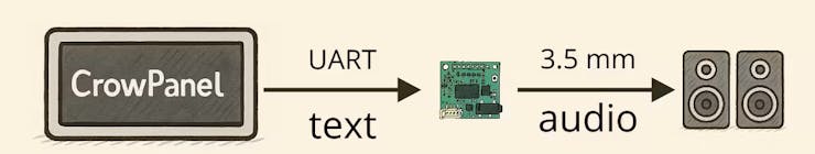

  • CrowPanel reads image and text files.
  • Text is sent over UART to TinyTTS.
  • TinyTTS generates speech.
  • Audio output from TinyTTS goes to the speaker.
  • Everything runs fully offline.
