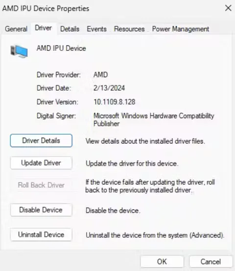

Minisforum UM790 computers are shipped with the IPU disabled. Check if the AMD IPU is present as a system device in the device manager.
If the IPU is not present in the list of devices, you should enable it in UEFI Setup.
Select:
Advanced Startup -> Recovery Options -> Restart Now
After restart:
Troubleshoot -> Advanced options -> UEFI Firmware Settings -> Advanced -> CPU Configuration ->
IPU Control -> change to Enabled -> Save & Exit
After restarting Windows, you may need to install drivers for the IPU, which can be downloaded from the AMD website.

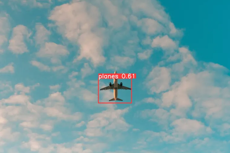

After running it, we will get an image with a marked plane with a specified probability
Object recognition in photos has many applications in various fields. In this project, the Yolo algorithm was used to detect airplanes in photos. In subsequent versions, changes will be introduced to allow for detecting the type of plane, which can be used in computer games, e.g. WarThunder for quick identification.
