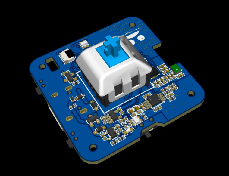

This AI key is powered by the esp32s3.
Features:
  • MCU: Espressif ESP32-S3, supporting WiFi and BLE, equipped with 16MB Flash storage and 8MB RAM.
  • Audio Processing: Built-in ES8311 audio chip for high-quality audio playback.
  • Display Screen: 0.85-inch color display with a resolution of 128x128, suitable for displaying various information.
  • Audio Output: Built-in speaker for clear audio output.
  • Audio Input: Built-in microphone for convenient voice recognition application development.
  • User Interaction: Built-in mechanical key switch for enhanced user interaction.
  • Power Management: Built-in lithium battery and power switch, supporting USB Type-C charging and firmware download.
  • Visual Effects: Built-in RGB LED to add visual appeal to the product.
  • Motion Sensing: Built-in accelerometer for motion detection.
  • Expansion Capability: 4-pin I2C expansion interface for connecting additional peripherals.

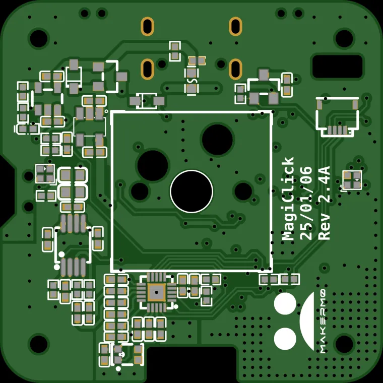

Schematic and Layout
  • https://github.com/MakerM0/MagiClick-esp32s3/tree/main/hardware/2.4/2.4A
