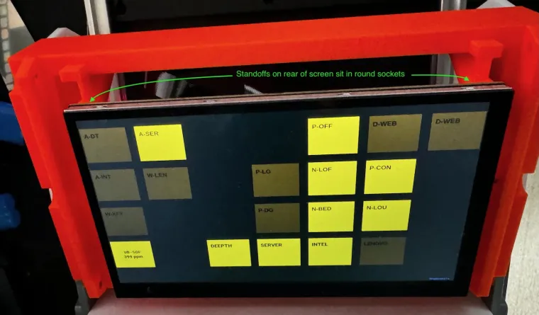

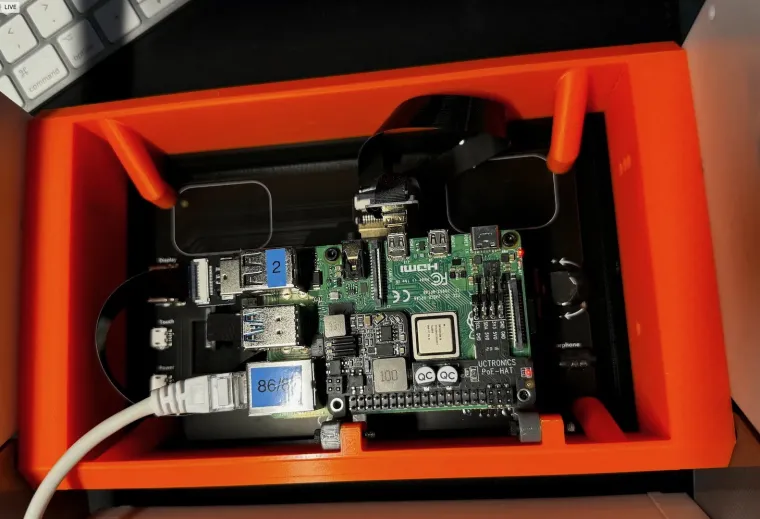

Taking inspiration from the engineering consoles from the STARFIELD game I've created a case to house an Elecrow 7" touchscreen, with rear mounts for a Raspberry Pi4.

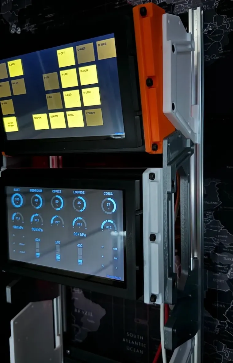

The consoles designed to be mounted on STARFIELD inspired brackets that attach to 1515 aluminium section.
I used M4 hex socket head machine bolts to connect the parts, available from Amazon.
The computer is running Raspberry Pi OS with the Chromium browser set to full screen showing a dashboard feed from Thingsboard running I'm running on docker to show what devices on my network are currently up.
