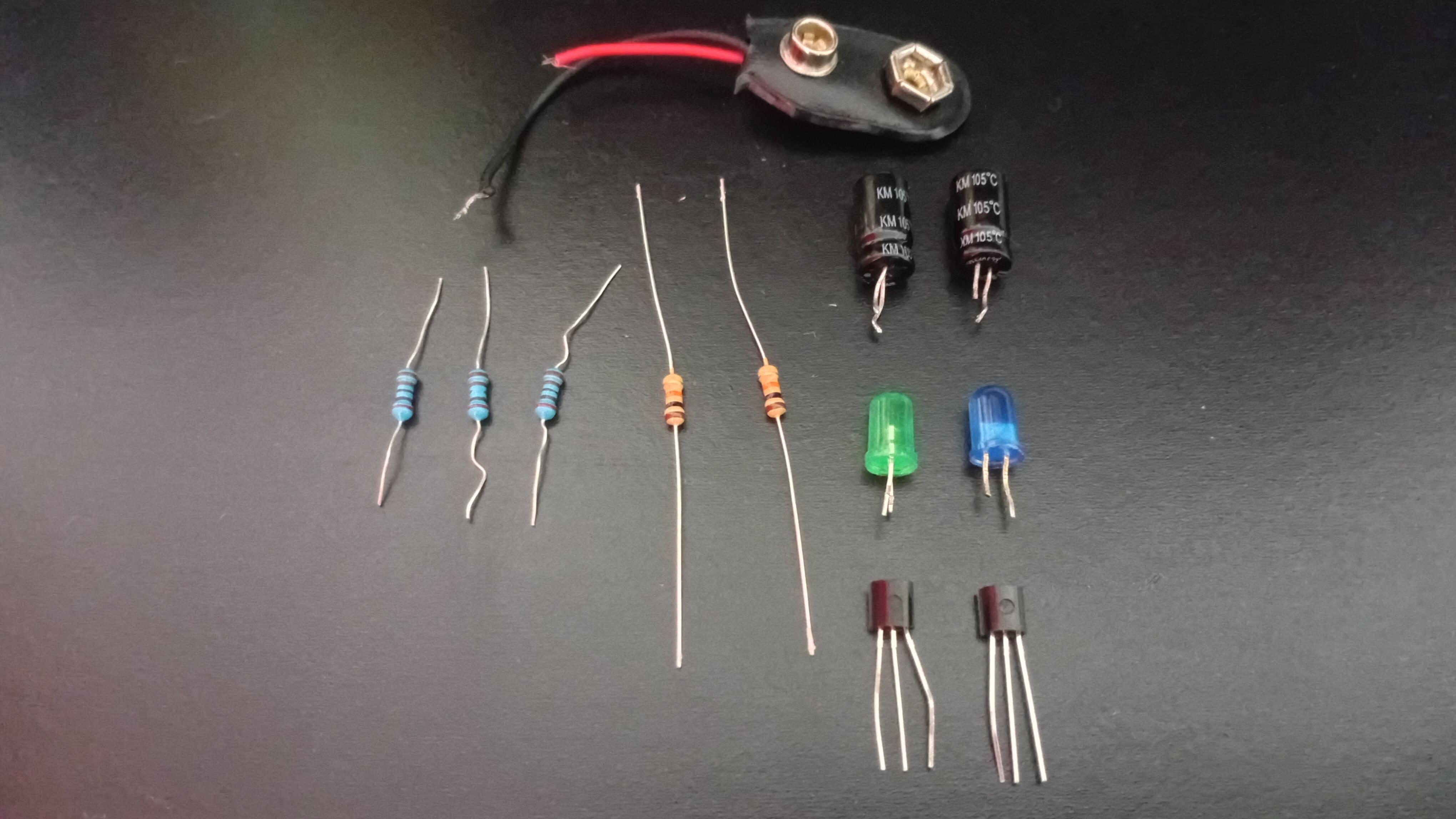

Here are the components and materials we'll use today:
  • 2 × BC547 transistors
  • 3 × 5mm LEDs (any color)
  • 2 × 100 µF electrolytic capacitors
  • 2 × 10 kΩ resistors
  • 3 × 2 kΩ resistors
  • 2 x 9V battery connector
  • Copper clad laminate
  • Ferric chloride
  • Permanent marker (pen)

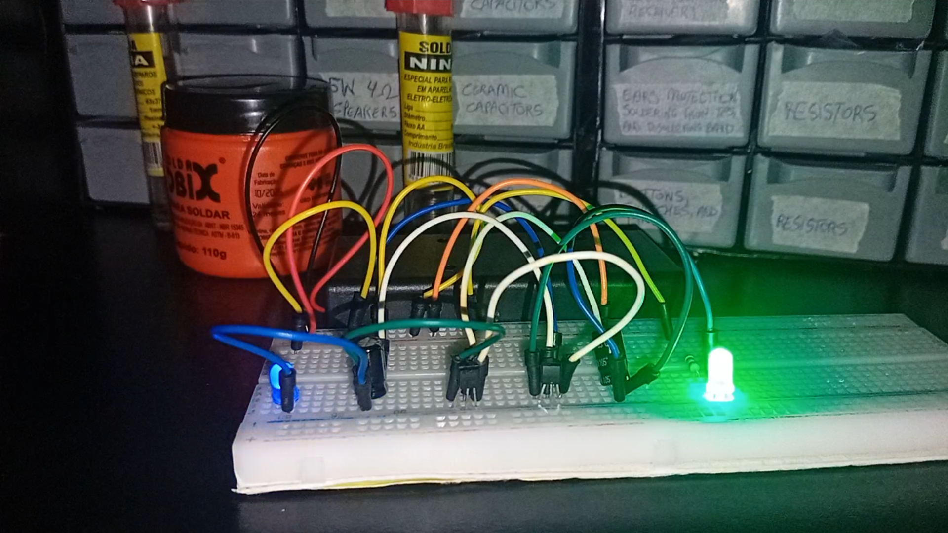

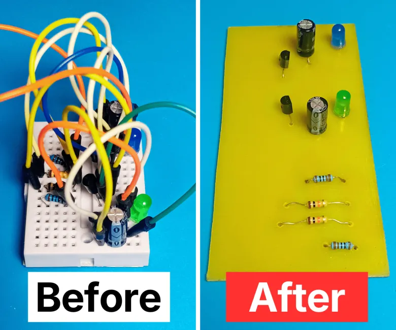

Why Breadboards Eventually Become a Problem

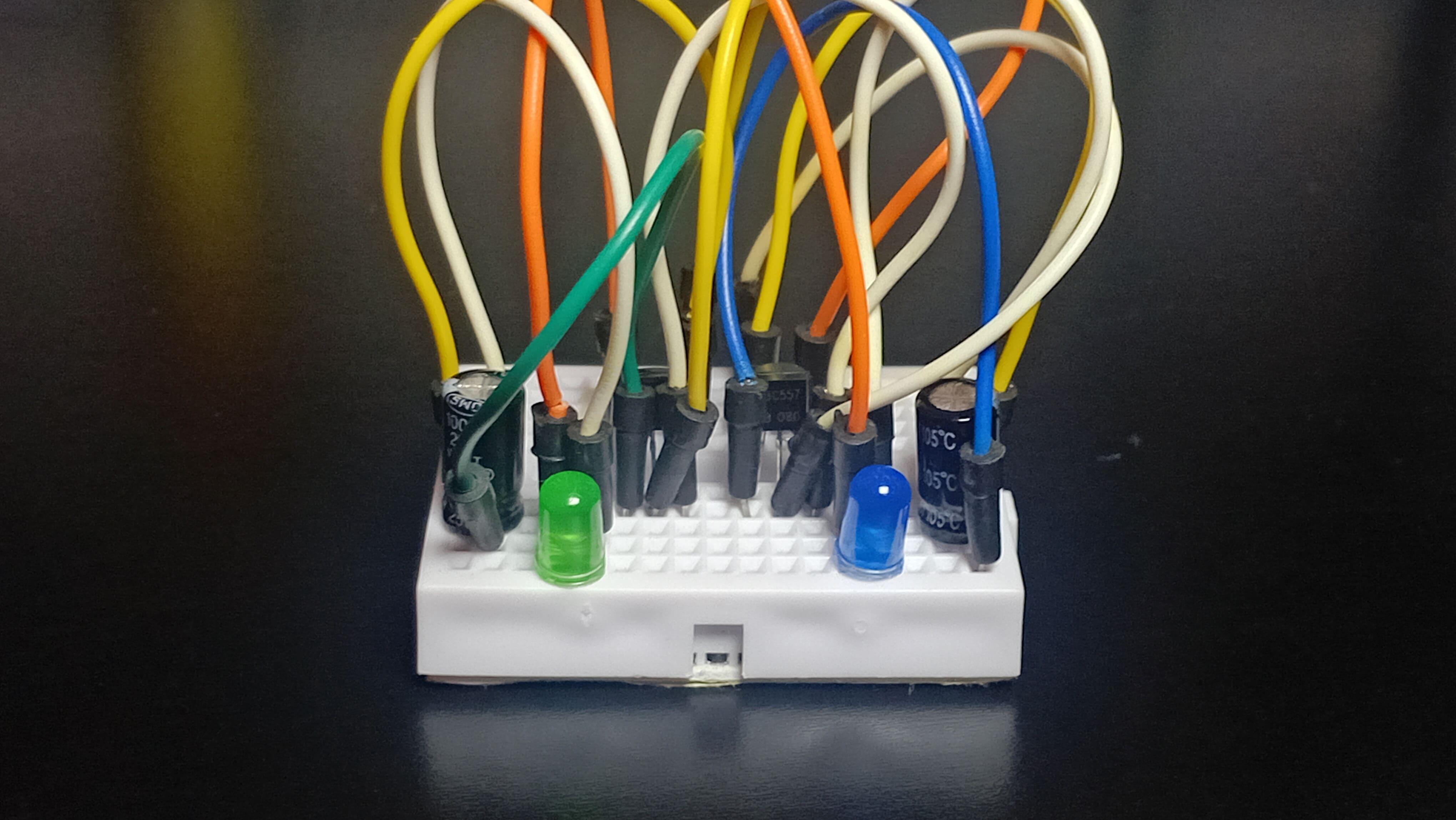

If you've been building electronic projects for a while, chances are you've used breadboards in almost everything you've made.
Breadboards are excellent for prototyping:
  • No soldering required
  • Circuits can be modified quickly
  • Wiring mistakes are easy to fix
  • Perfect for learning and experimentation
For early testing, they are hard to beat.
However, breadboards have serious limitations once a project needs to last longer than a quick test.

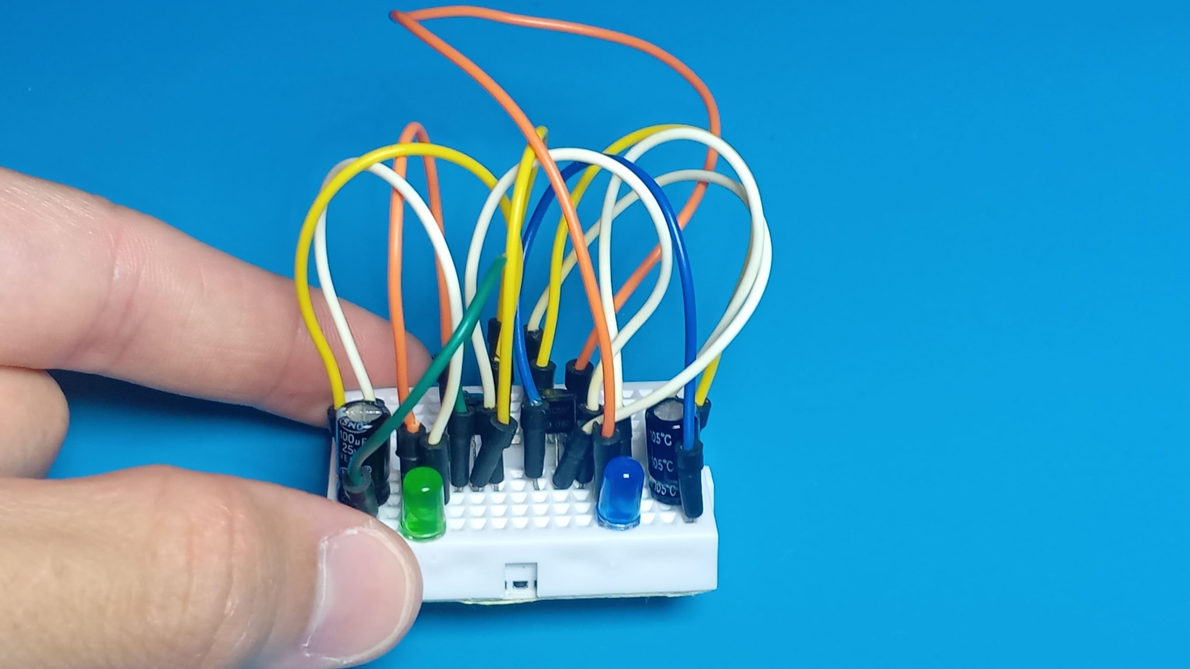

  • The circuit becomes physically large
  • Connections are unreliable
  • A small movement can break contact
  • Vibration and transportation cause failures
Breadboards are simply not designed for long-term or real-world use. If you want your project to feel solid and professional, you need something more robust.

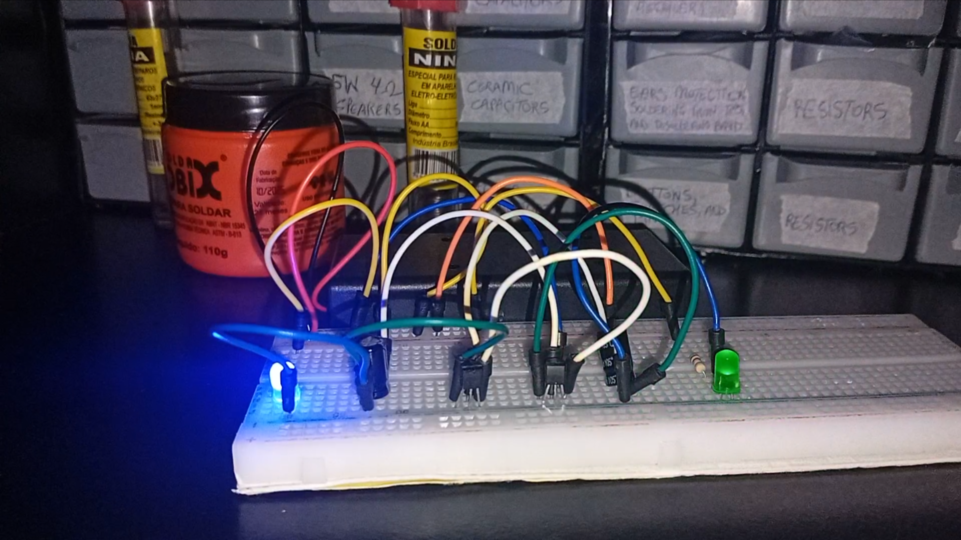

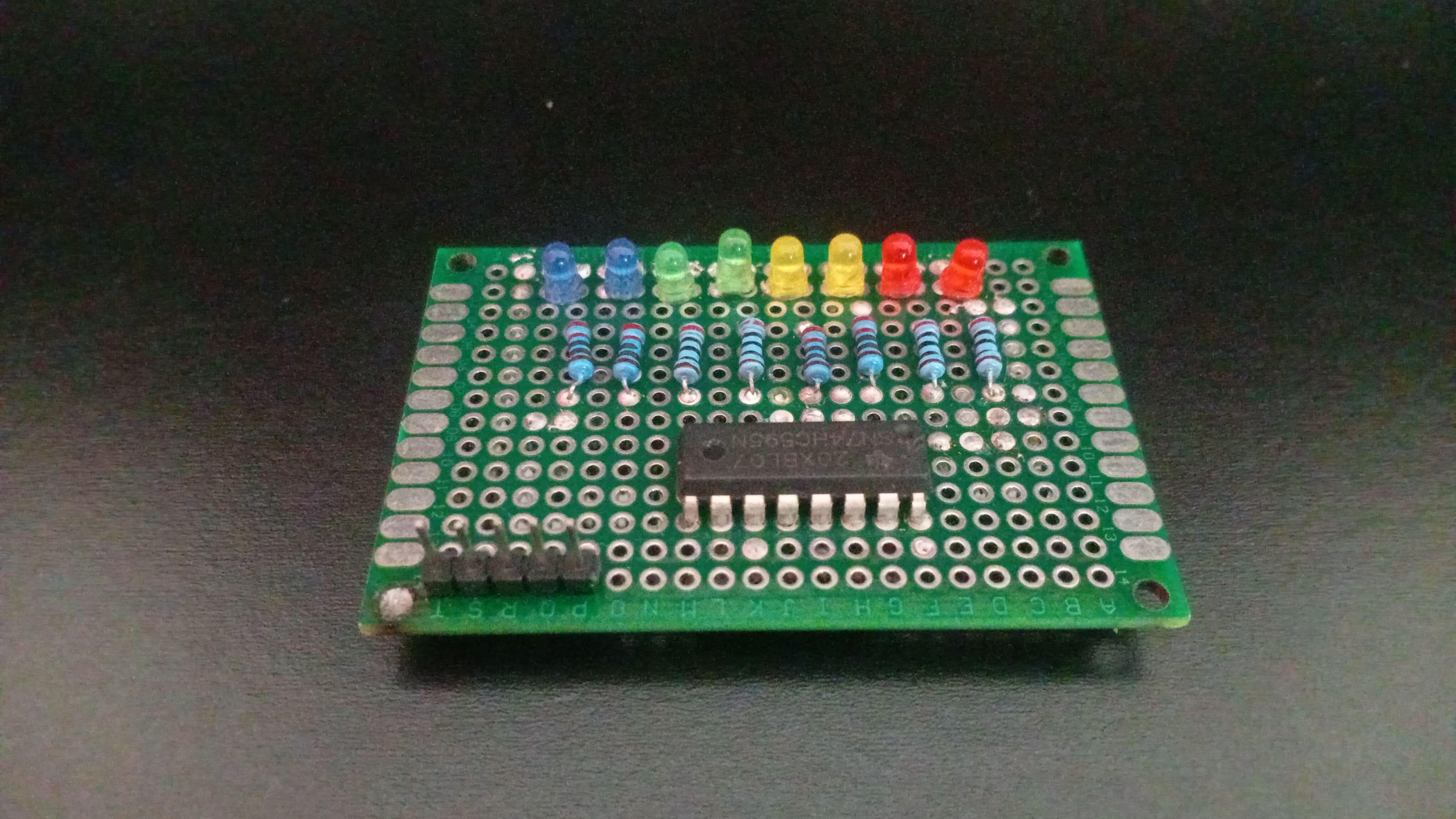

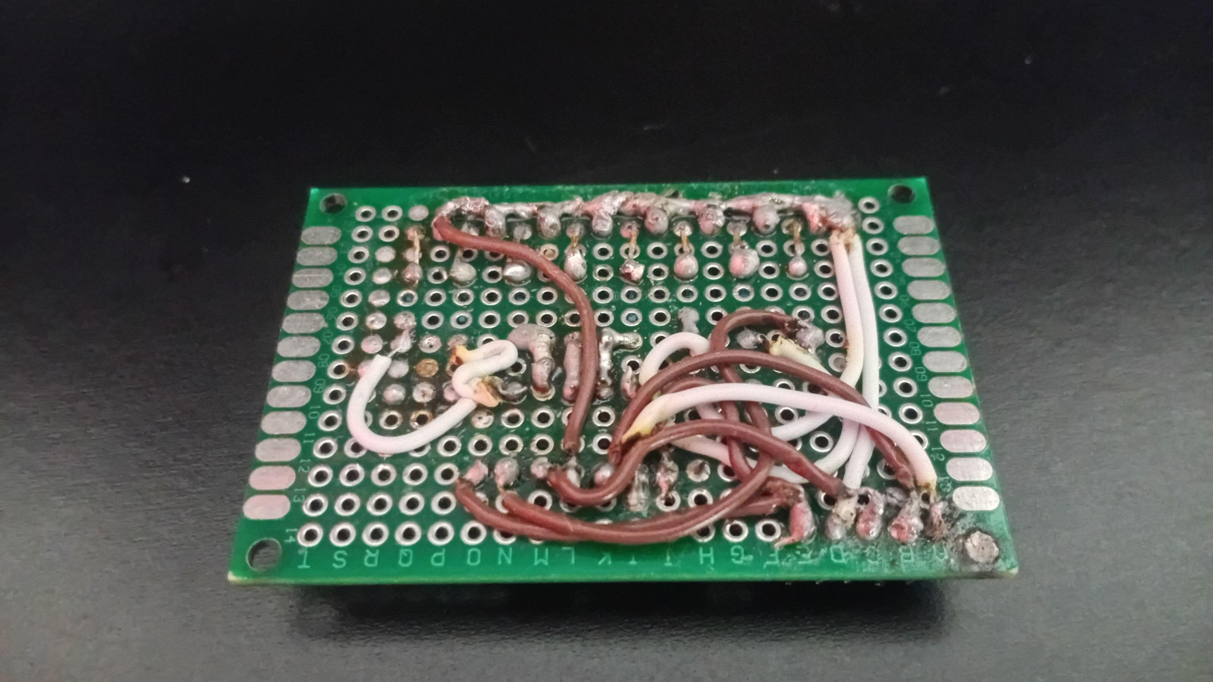

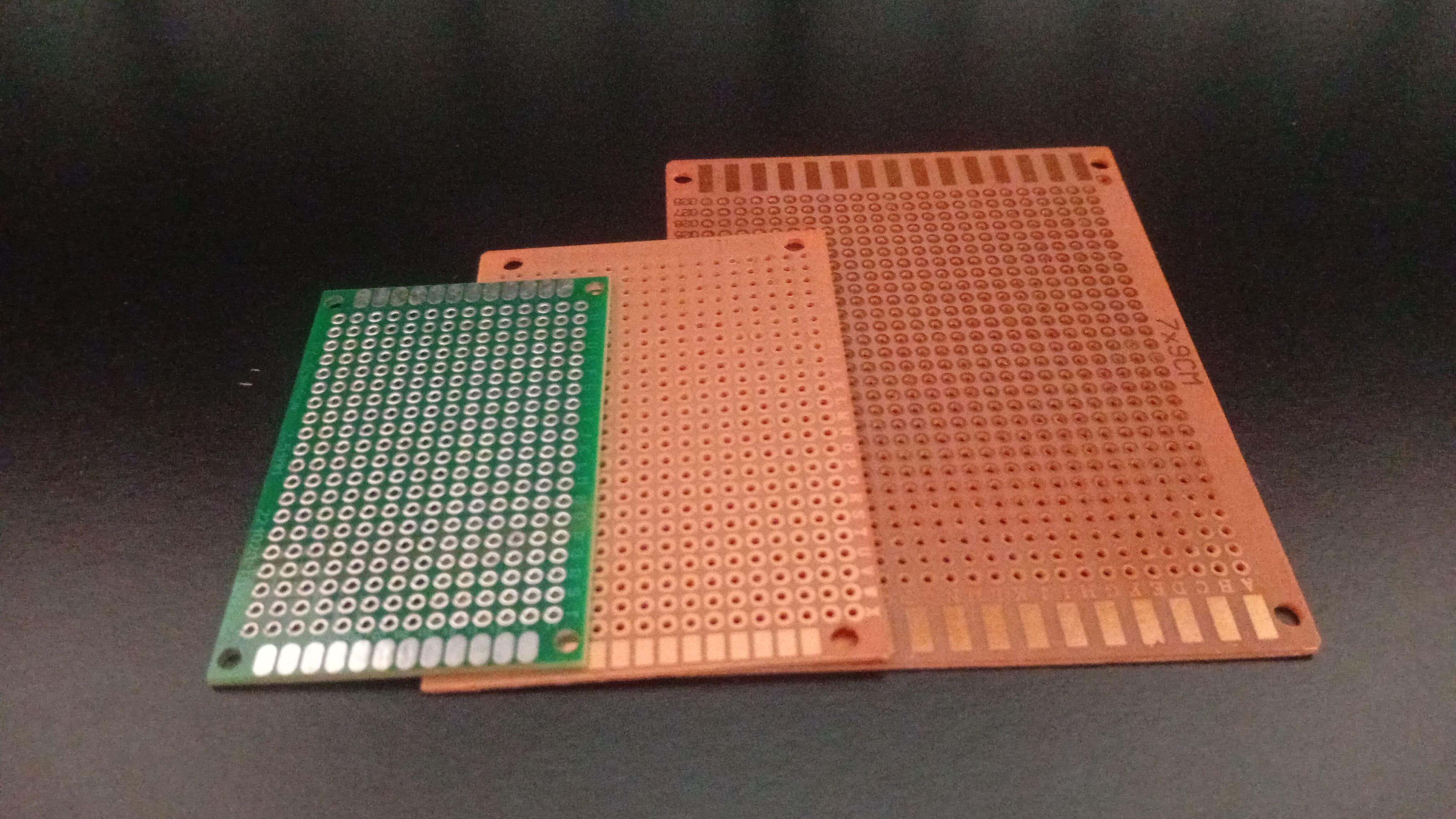

Perfboards: Better, But Still Not Ideal
The next step many people take is using perfboards or universal boards. These allow you to solder components instead of plugging them in, which improves mechanical strength.
But a new problem appears very quickly.
  • Wiring becomes messy
  • Traces are hard to follow
  • Debugging large circuits is difficult
  • The final result often looks improvised
It works - but it's not elegant (as you can see in the photos above).

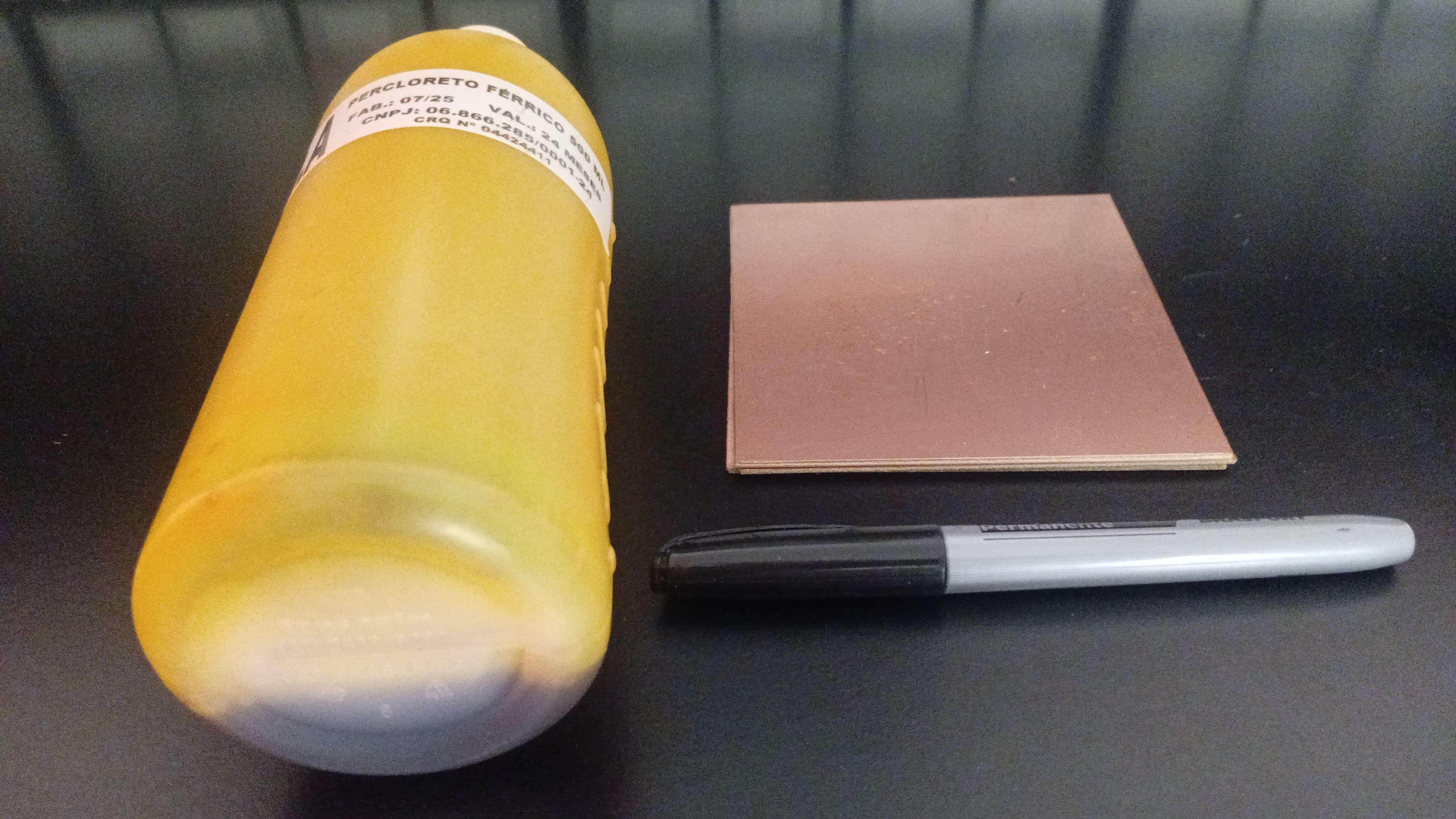

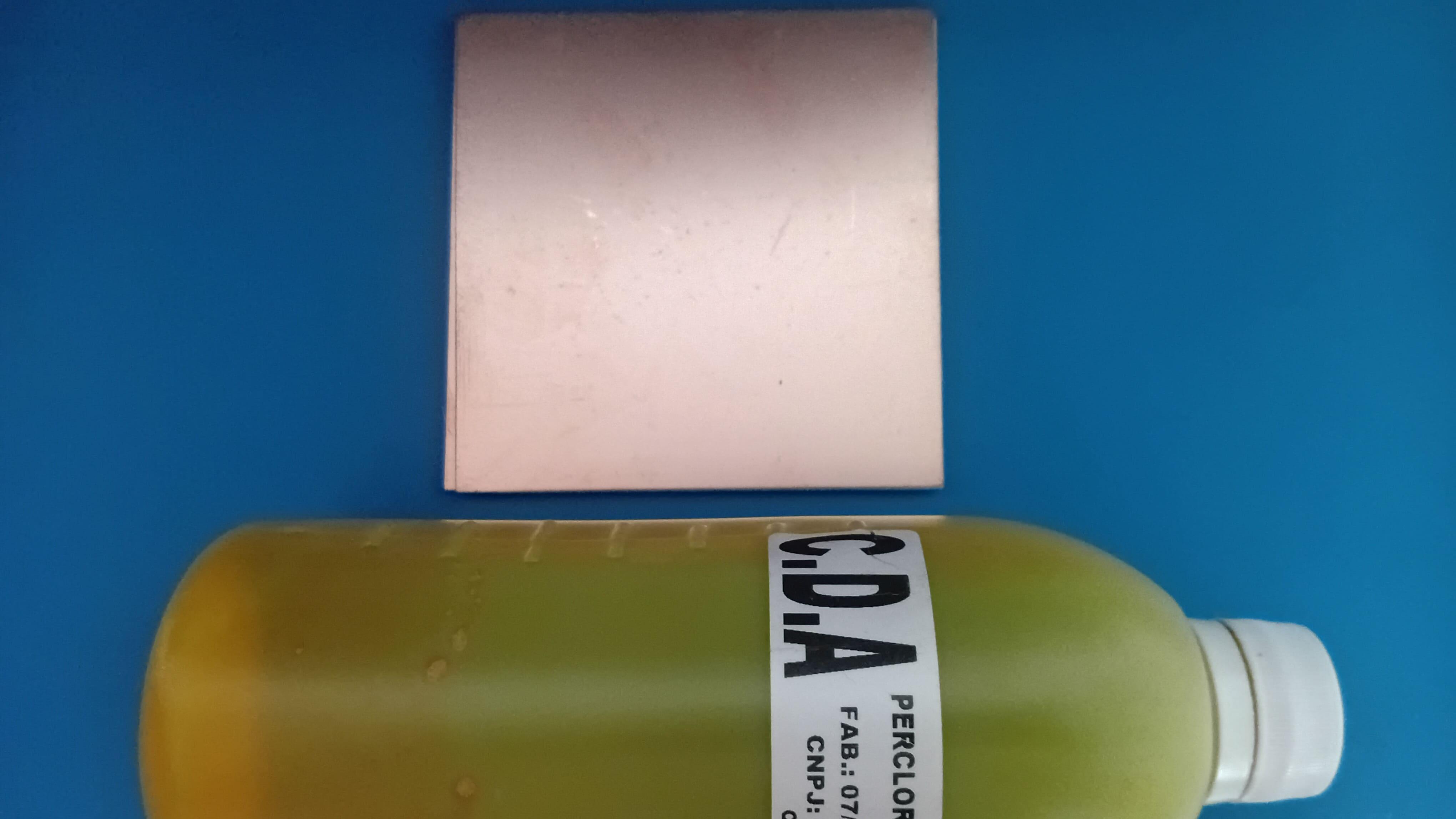

Copper Clad Laminate
This is a fiberglass or resin board coated with a thin layer of copper on one or both sides. The copper layer will become the electrical traces.
Ferric Chloride
Ferric chloride is a chemical etchant that reacts with copper and dissolves it.
By protecting specific areas of copper, we control where copper remains. Those protected areas become the traces that connect the electronic components.

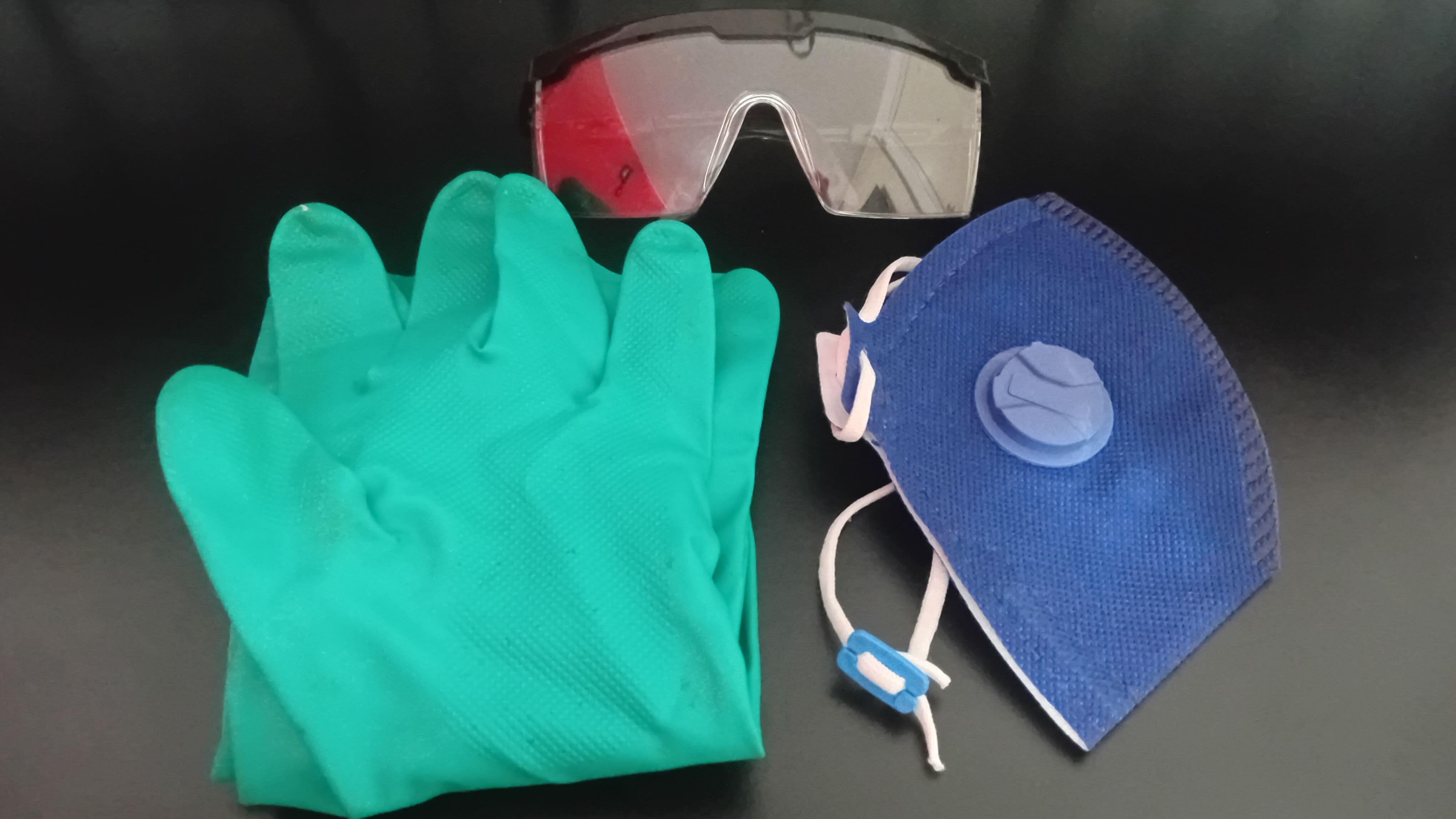

Safety Warning (Very Important)
Ferric chloride is not a harmless substance.
  • It stains surfaces permanently
  • It corrodes metal
  • It irritates skin
  • It can cause serious eye damage
Always
  • Wear gloves and eye protection
  • Work in a well-ventilated area
  • Use plastic containers only
  • Never pour it into a drain
  • Dispose of it according to local chemical disposal rules
Safety is not optional.

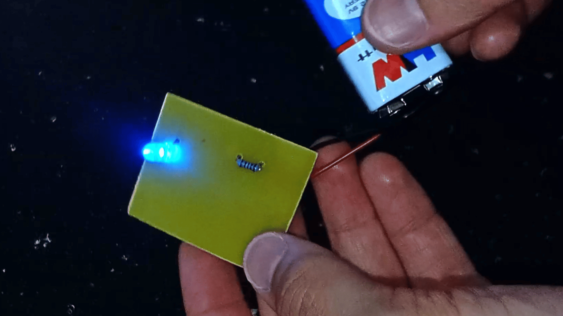

Project 1 - A Simple LED PCB
The first project is intentionally simple. The goal is not electrical complexity, but understanding the PCB fabrication process.
For this project, you'll need:
  • 1 × 5mm LED
  • 1 × 2kΩ resistor
  • 1 × 9V battery connector

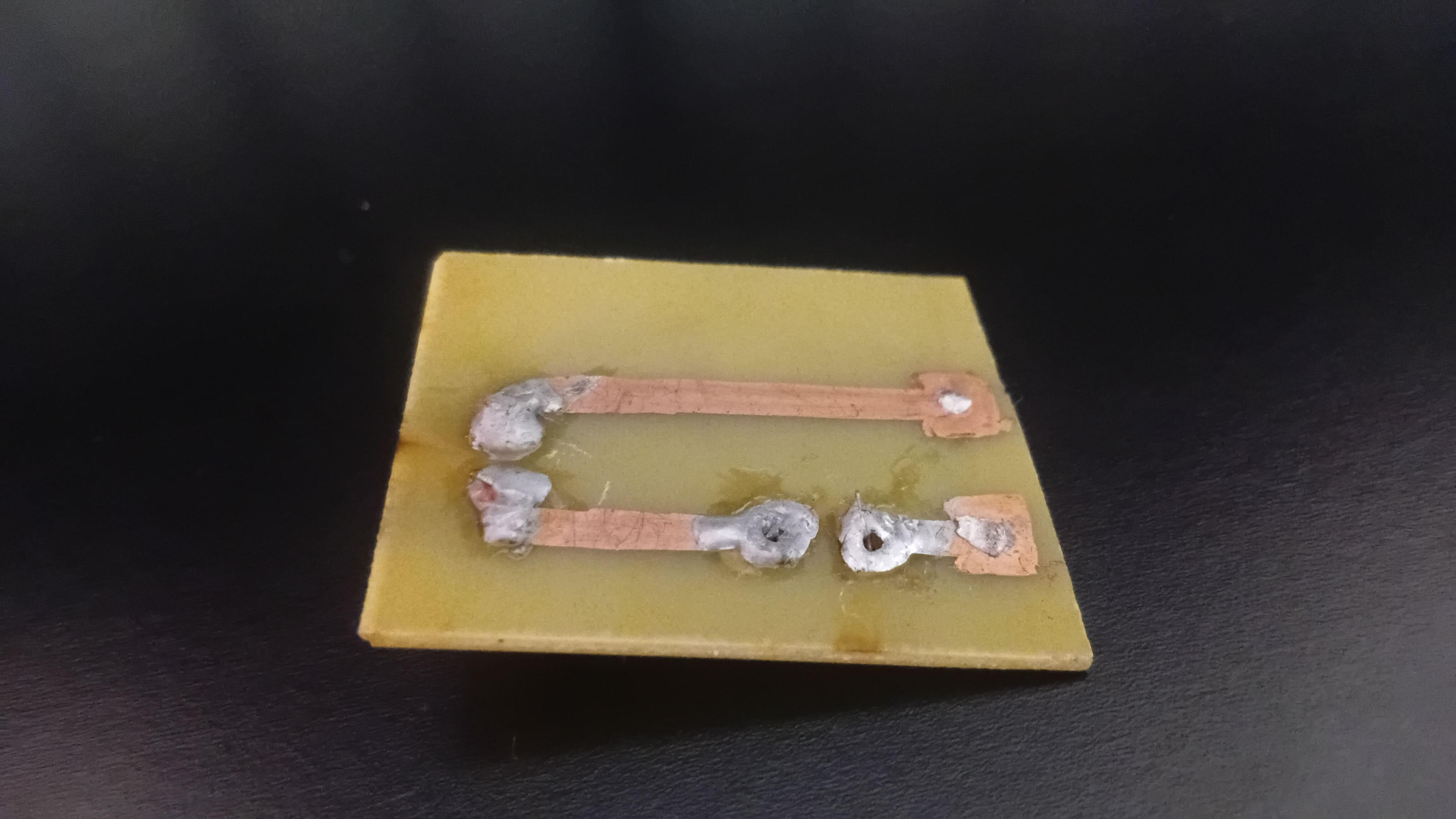

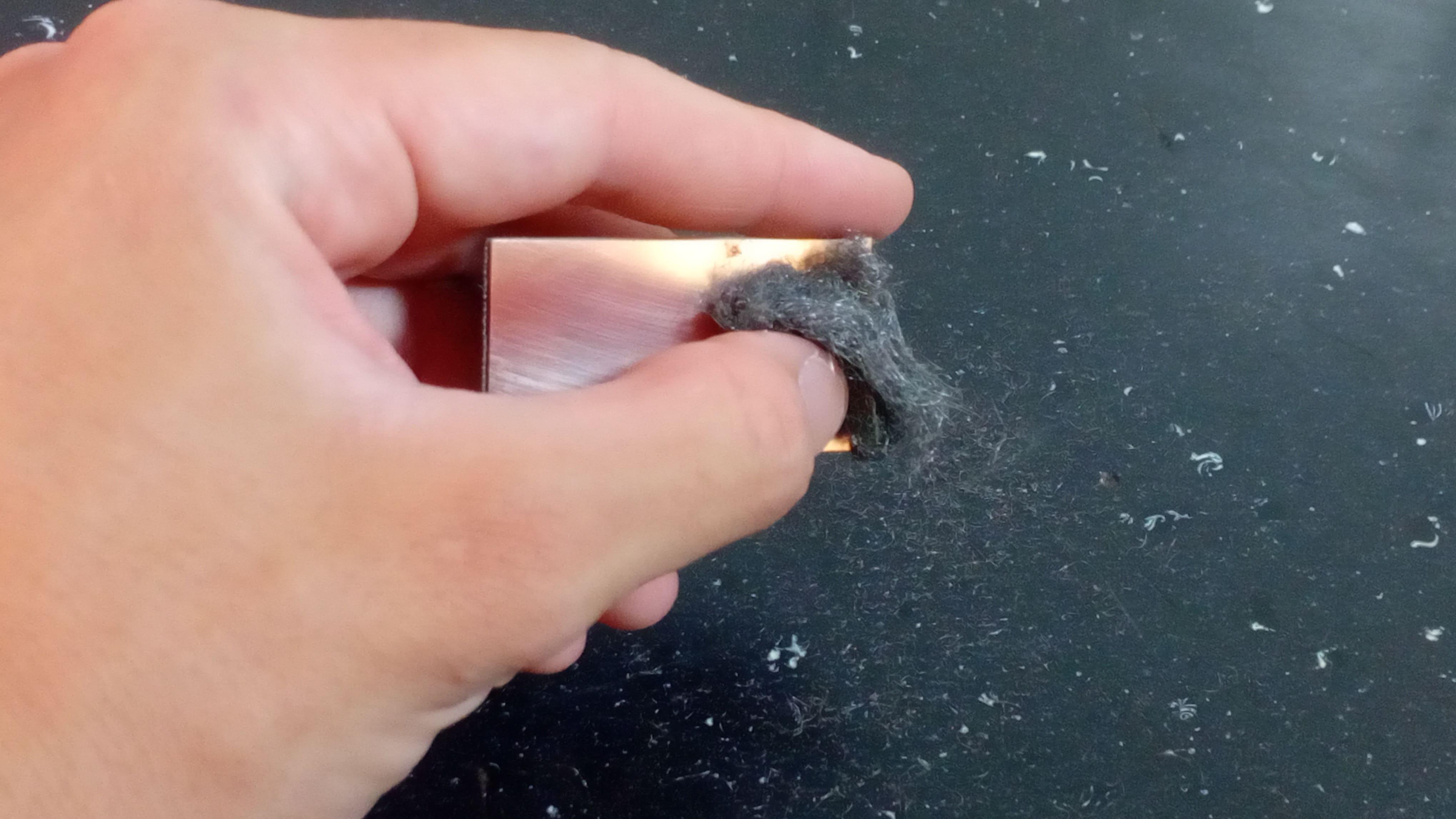

Step 1: Clean the Copper
Start by cleaning the copper surface using a dry cloth or fine steel wool to remove dirt and oxidation.
A clean surface is critical for proper etching.

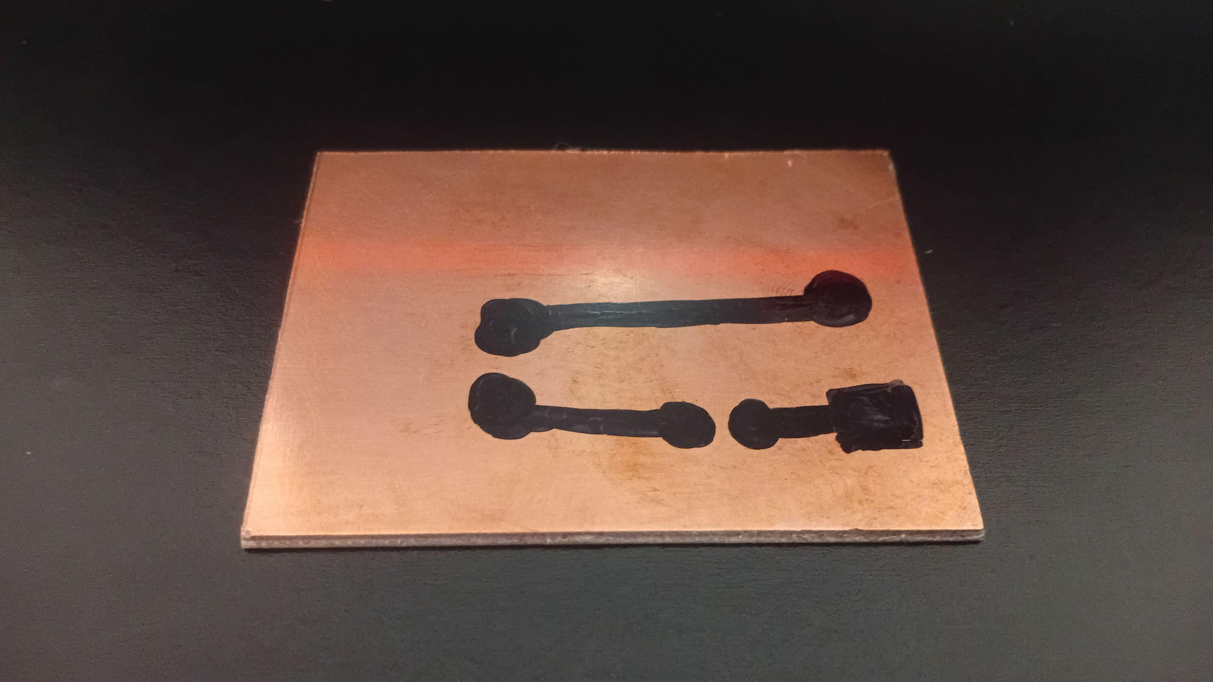

Step 2: Draw the Traces
Using a permanent marker, draw the traces directly onto the copper.
The marker ink acts as a resist, preventing ferric chloride from reaching the copper underneath.
This technique works surprisingly well for simple circuits.

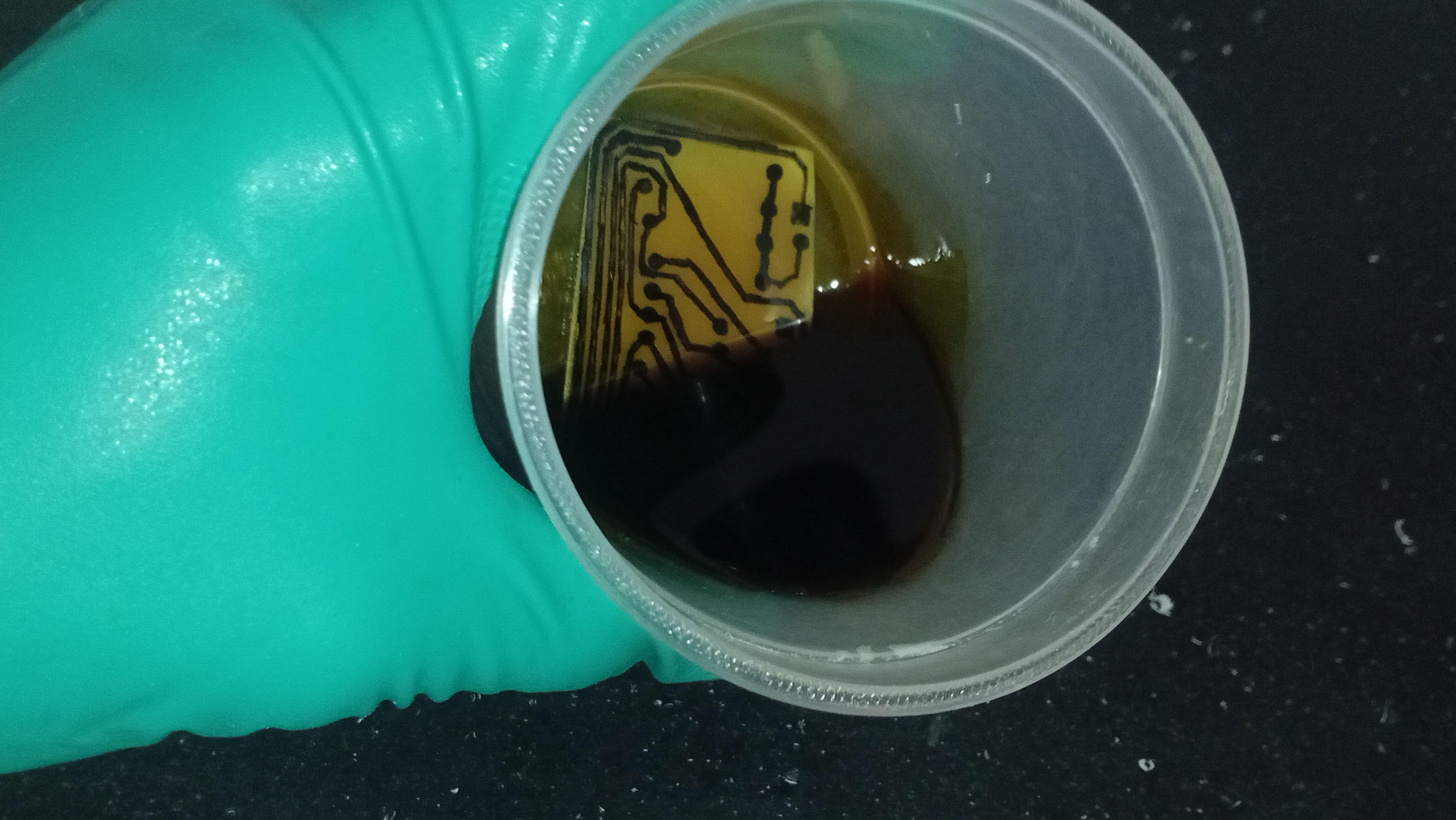

Step 3: Etch the Board
Place the board into a plastic container filled with diluted ferric chloride.
If using ferric chloride powder:
  • Mix 1 part ferric chloride
  • With 2 parts water (by mass)
For example:
  • One ounce of ferric chloride (28 g)
  • And two ounces of water (56 g)
Some tips:
  • Gently move the container every few minutes
  • Keep the copper facing downward so etched copper doesn't settle on the board
After some minutes, the exposed copper will dissolve.
Step 4: Clean and Finish

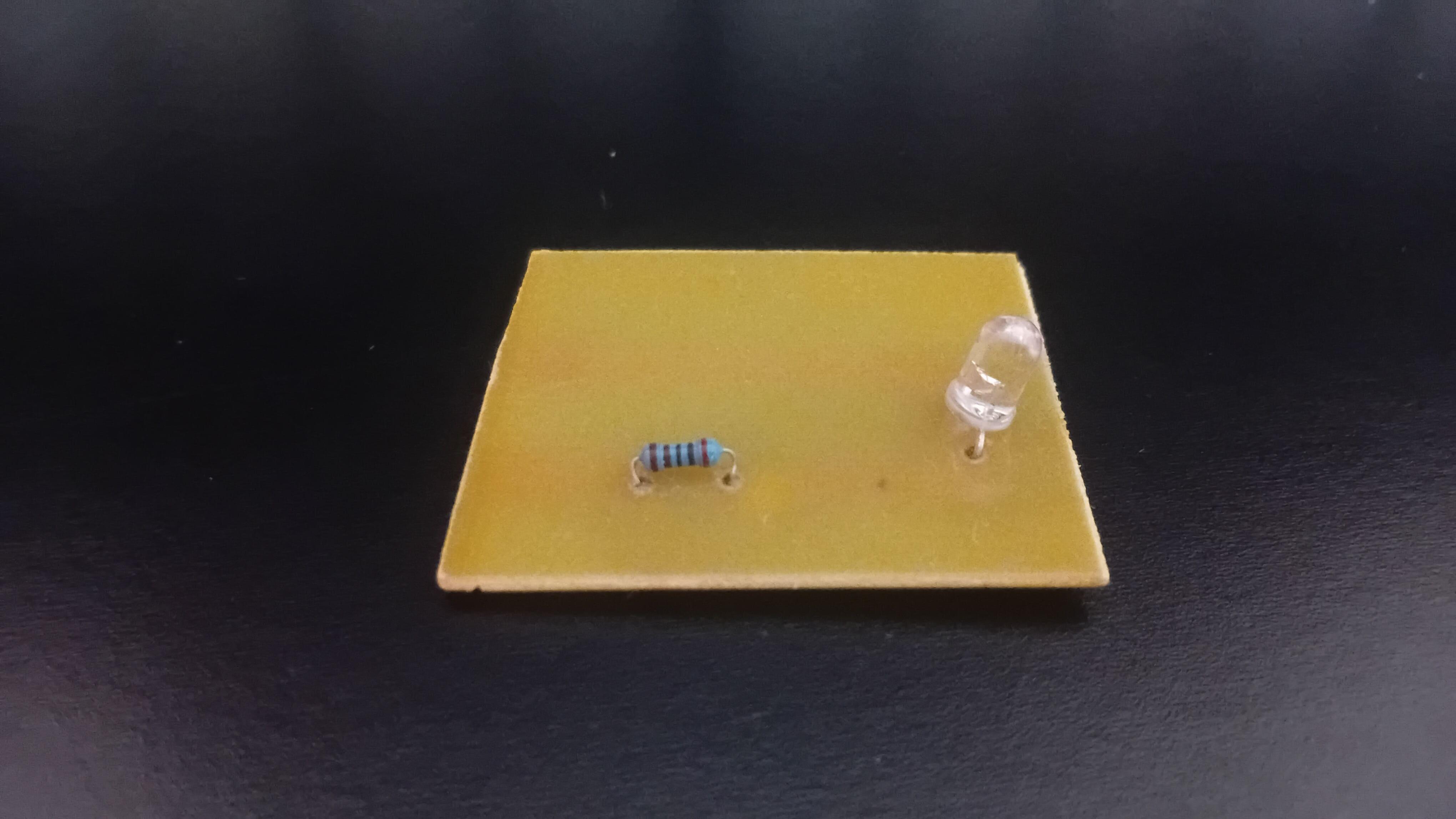

  • Rinse the board with water
  • Remove the marker ink using alcohol
  • Drill the holes
  • Solder the components
Once powered, the LED lights up exactly as expected - confirming that the PCB process worked.

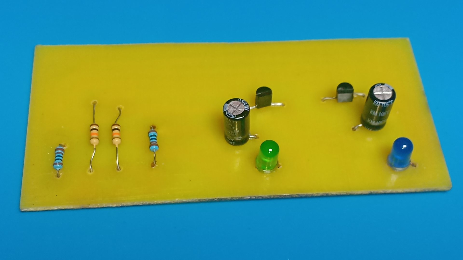

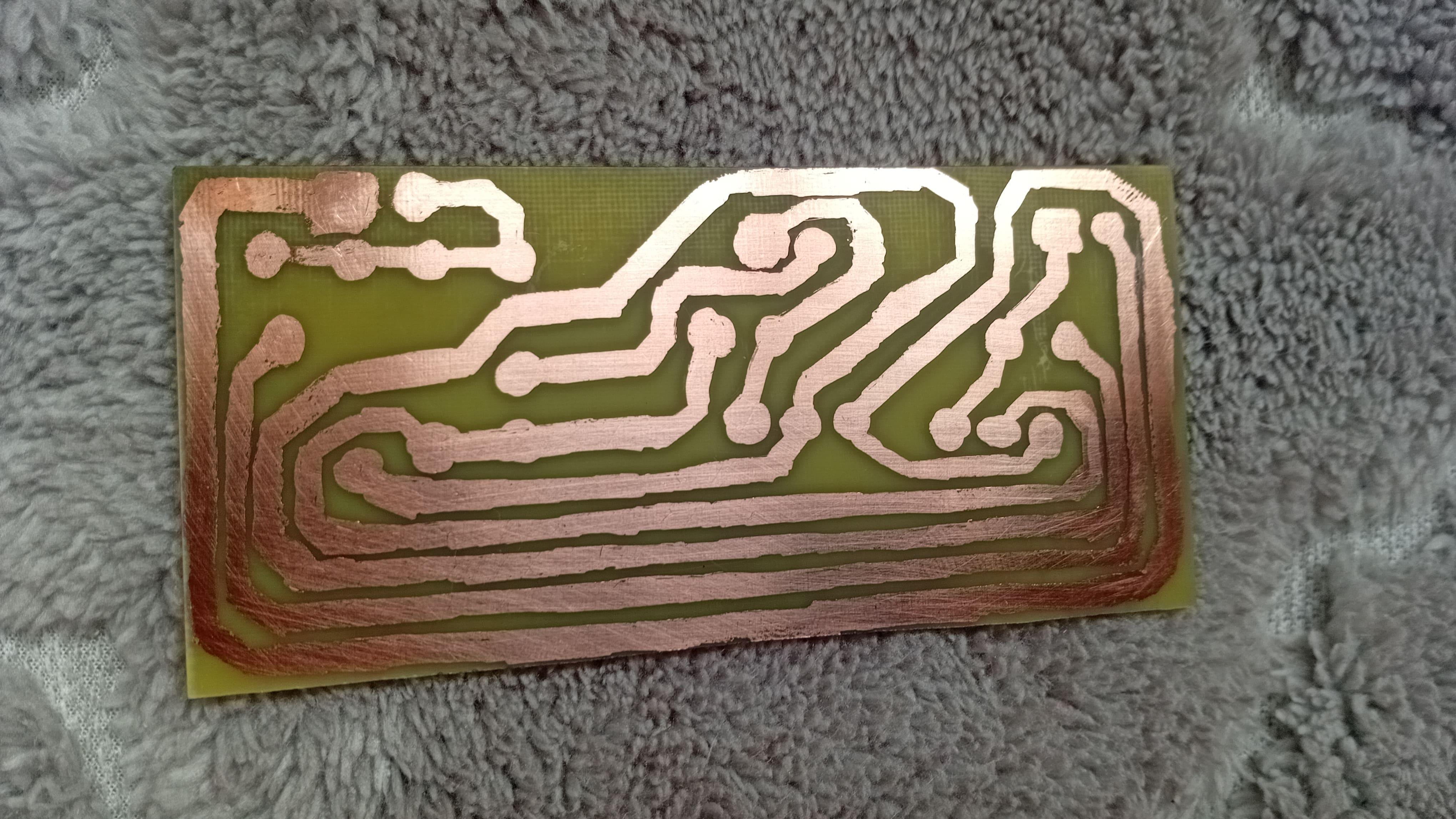

Project 2 - A Flip-Flop Circuit PCB
The first project was simple. Now let’s build something more interesting: a flip-flop. A circuit that makes two LEDs blink alternately when power is applied (see photos below).
What Is a Flip-Flop?
A flip-flop is one of the most fundamental circuits in digital electronics. It is a bistable system, meaning it has two stable states. Once it enters one state, it will remain there until an input causes it to change.
Each flip-flop stores exactly one bit of information. All digital memory systems, whether in old computers or modern processors, are ultimately composed of massive networks of such circuits.
In our design, two transistors, capacitors, and resistors form a simple oscillating flip-flop. Each transistor alternately turns the other off and on, creating the blinking effect. While this may appear simple, the same logic forms the basis of clocks, counters, and memory registers.
Step-by-Step Project

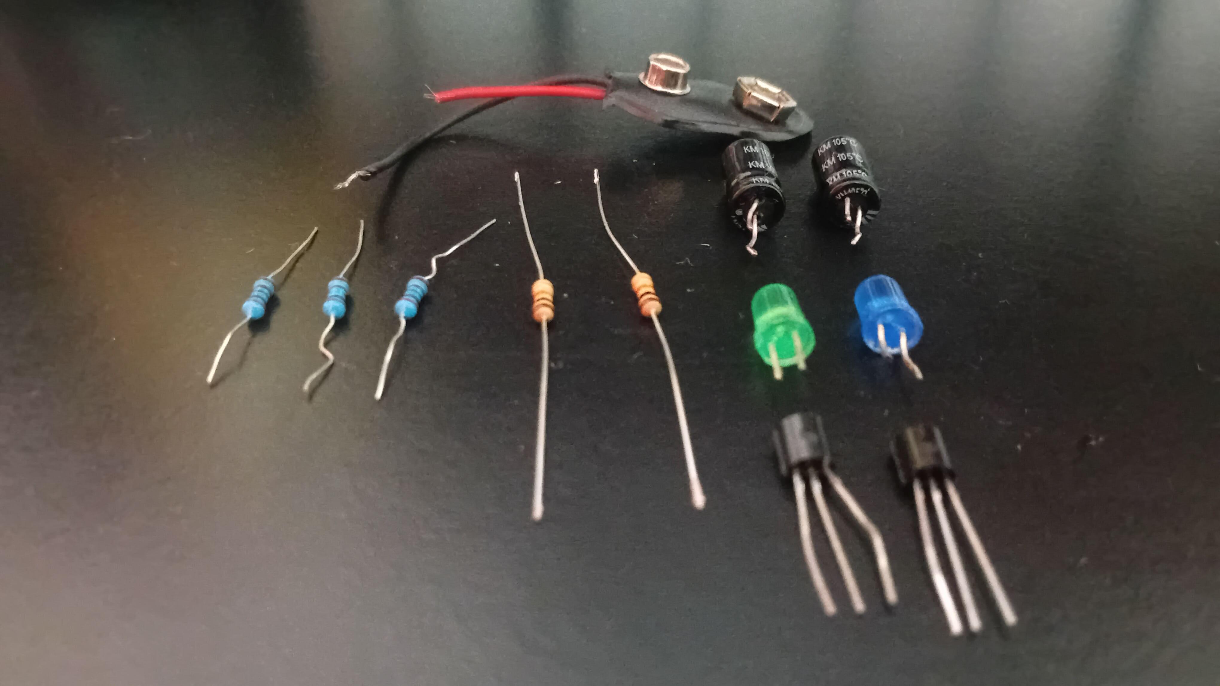

To create this project, you'll need:
  • 2 × 5mm LEDs
  • 2 × 2 kΩ resistors

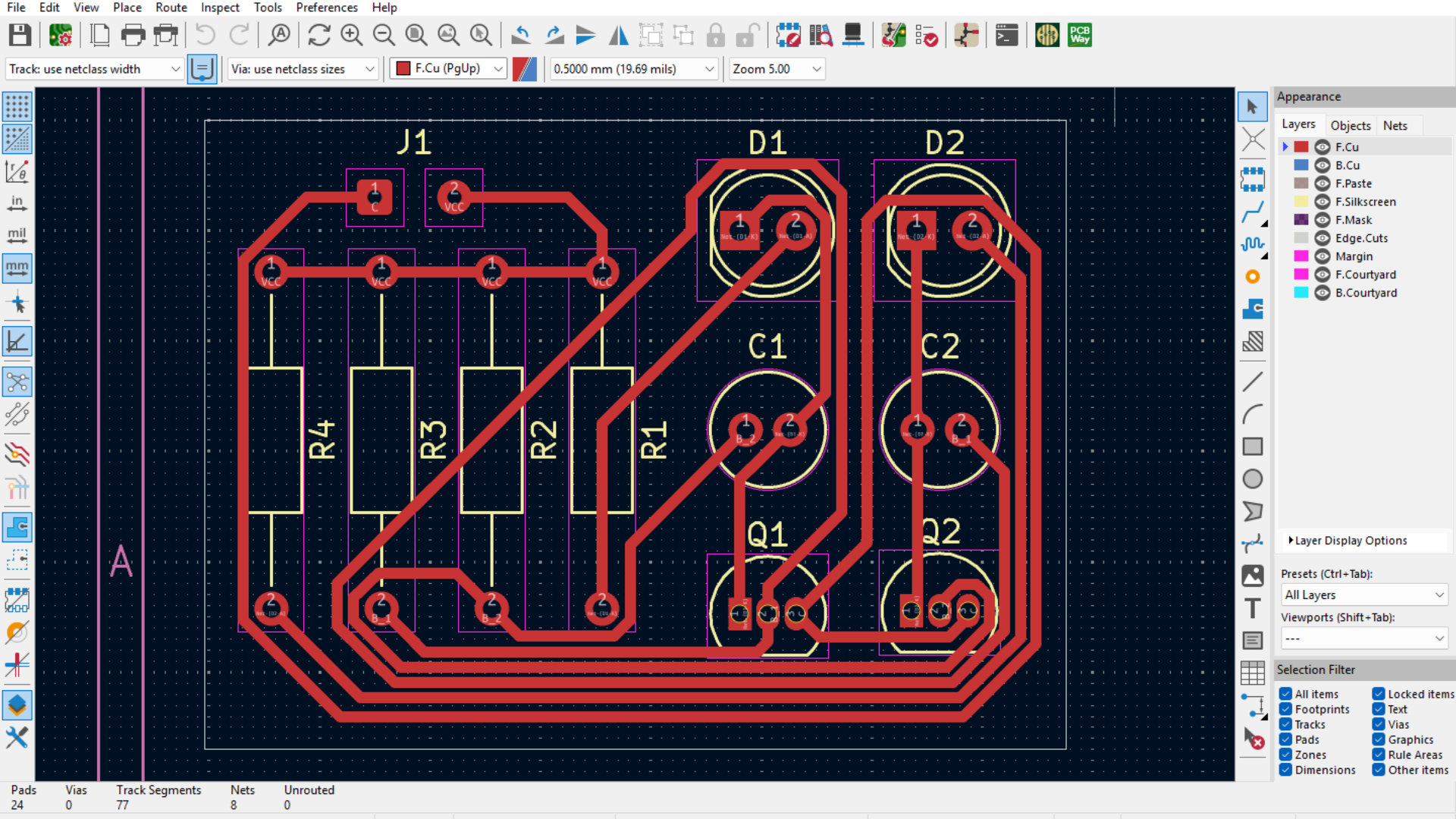

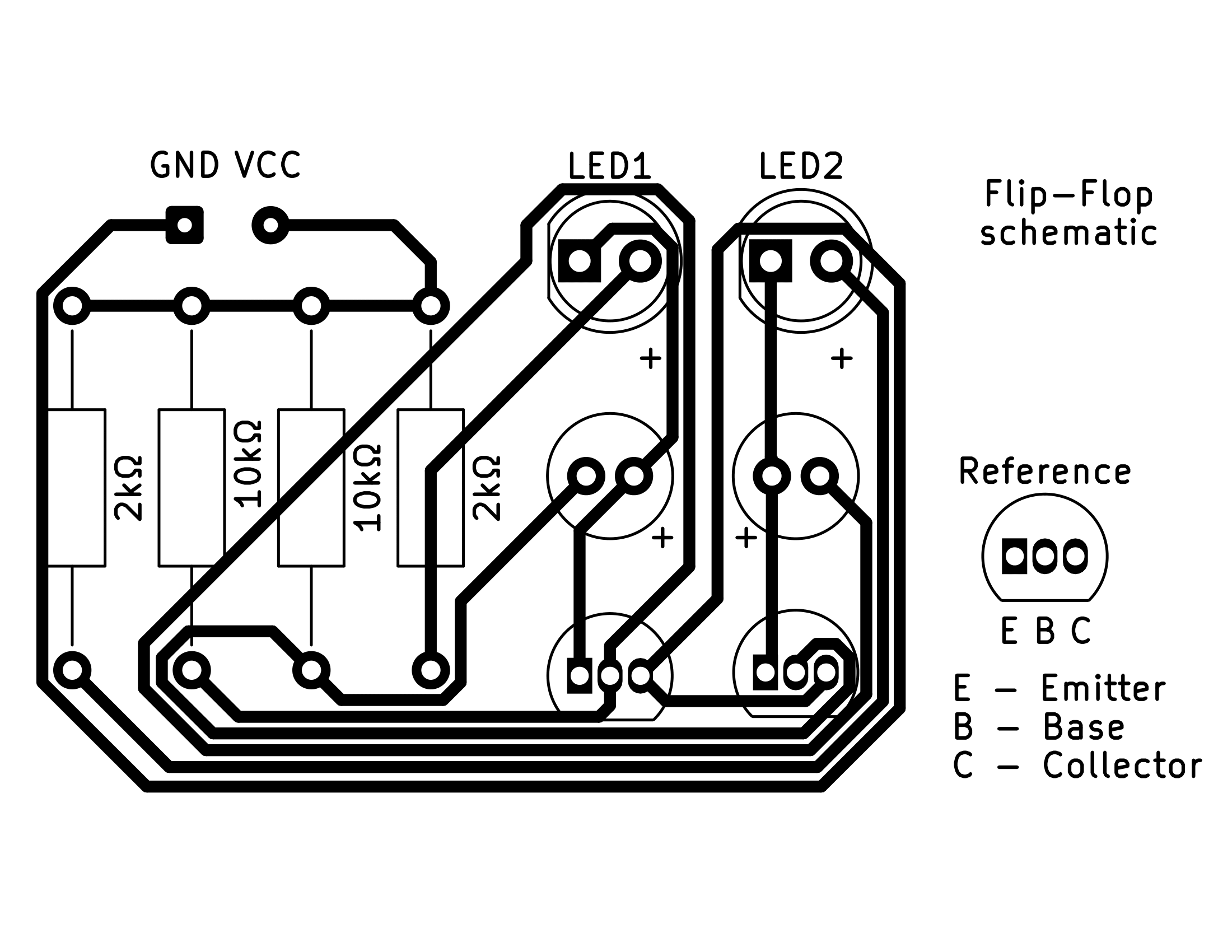

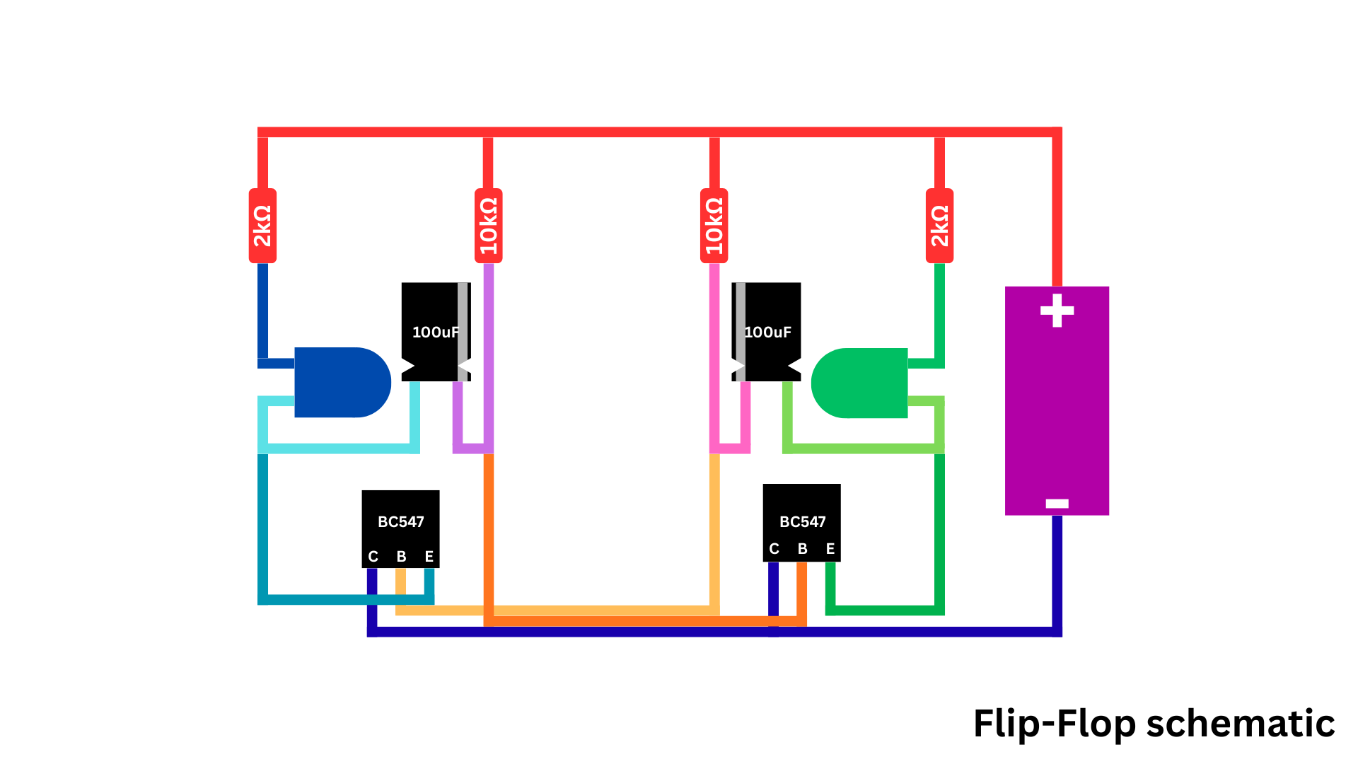

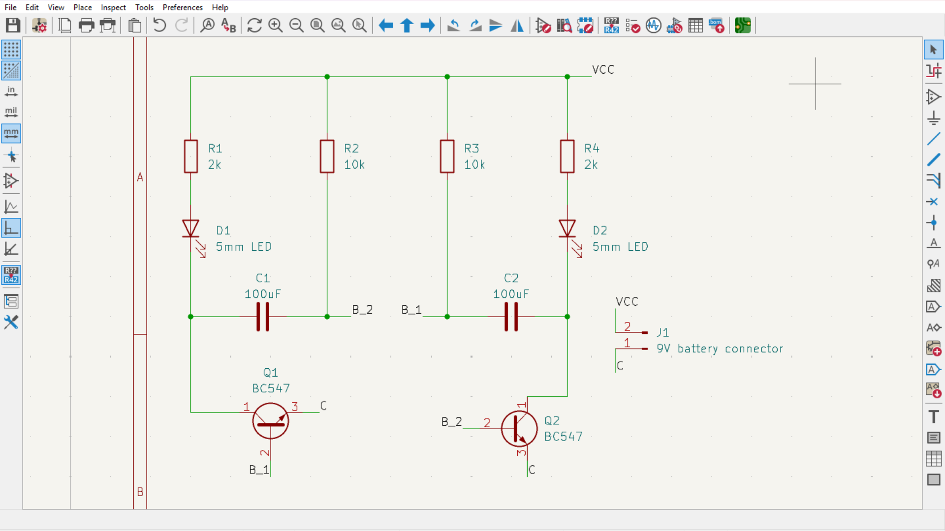

To accomplish this project, I designed the circuit using KiCad, a free and professional-grade PCB design tool.
First, the schematic was created. Then it was converted into a board layout where the components are arranged and traces are routed.

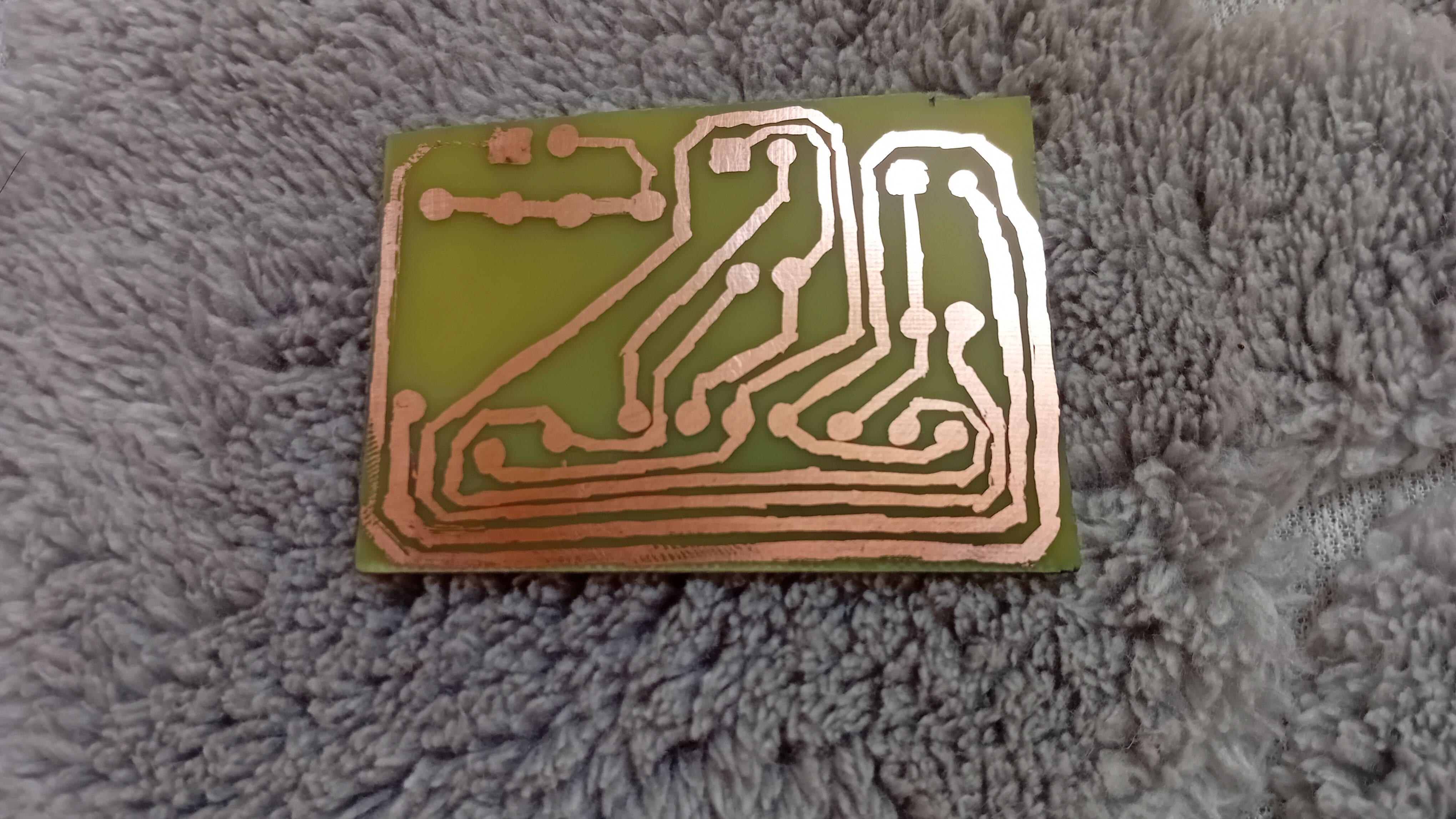

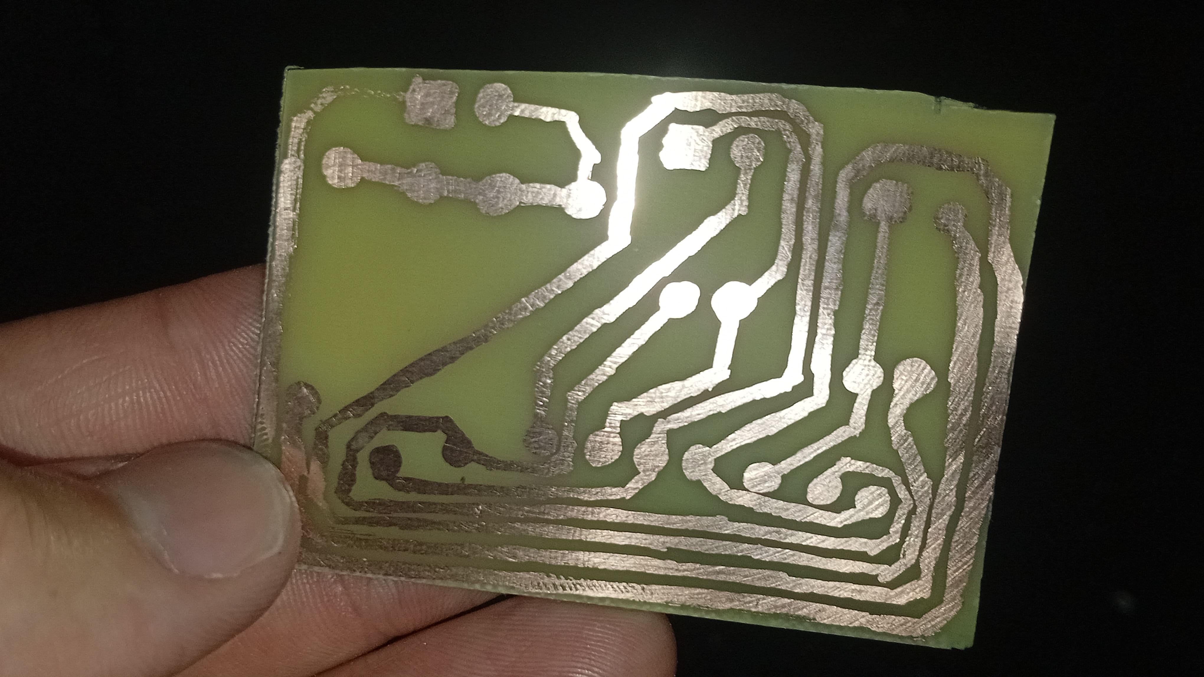

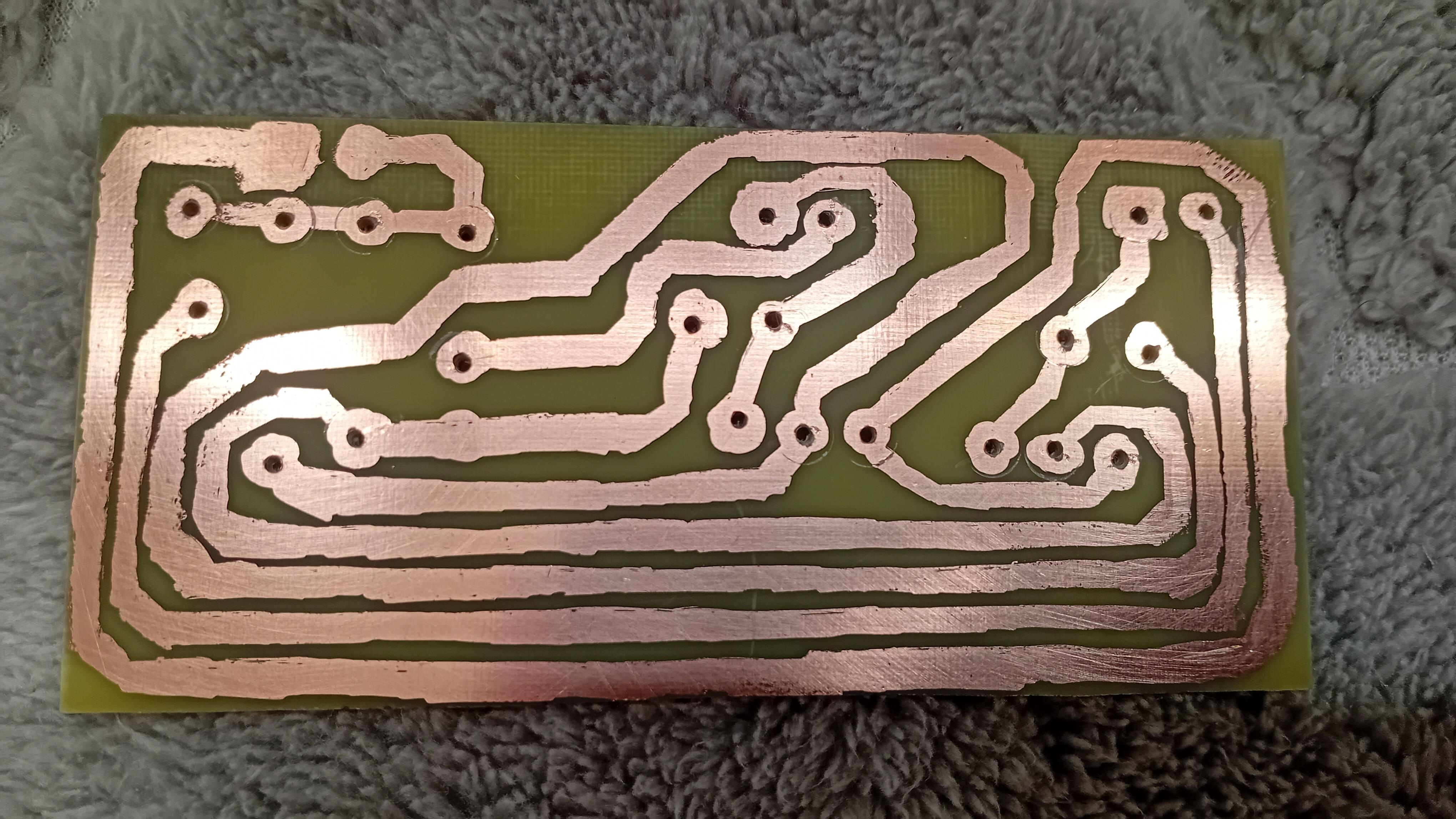

Once the design was complete, I used the permanent marker (pen) to draw it on the copper, according to the schematic below. Then I went to manufacuring it, but the first PCB didn't work quite well.

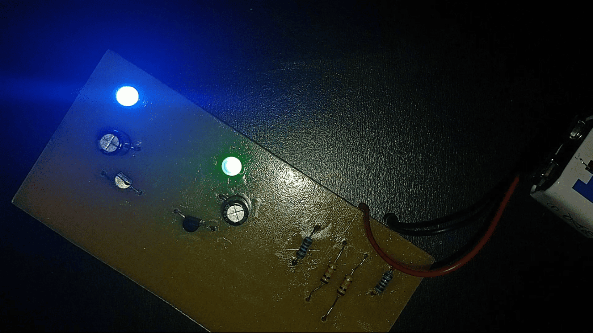

Some traces were faulty, so I decided to create another PCB. After some time and hard work, I finally got a PCB suitable for the project. I let it sit on ferric chloride for about 15 minutes, and it worked just fine.
I cleaned it, drilled the holes and soldered the components.
Lastly, I connected the battery and watched the LEDs blinking one after the other.
