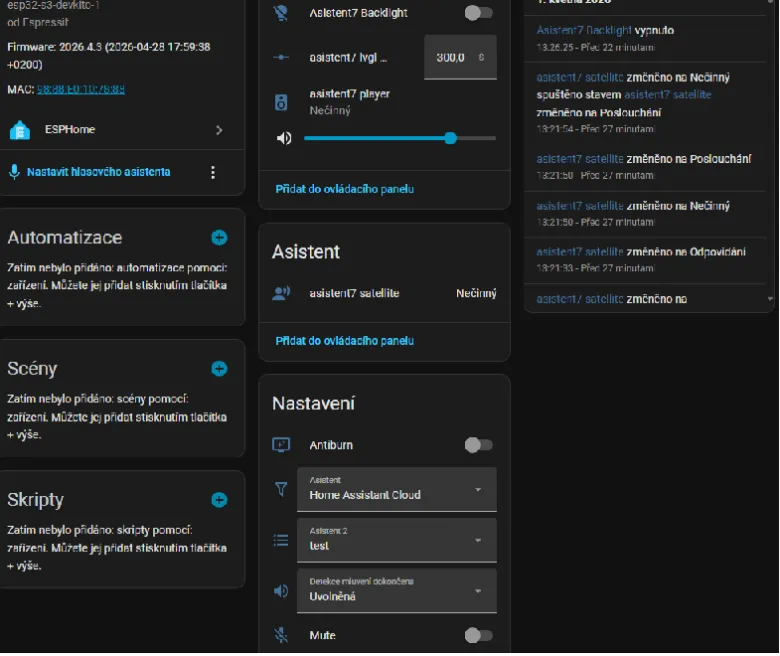

After enabling the voice assistant on the Crow panel v1.2, I managed to enable the voice assistant on the Crow panel v1.3. For this version, it took much more, trying different settings and testing. At the same time, I tried to enable Xiao
zhi for this version. I got to the point where I had a working display and speaker in Esphome but no mic. In Xiaozhi, after problems with the display, the mic + display were working but no speaker.

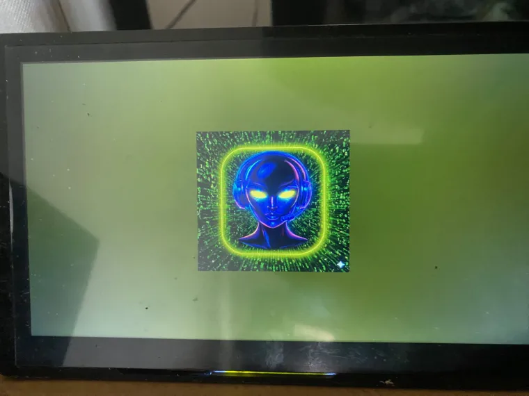

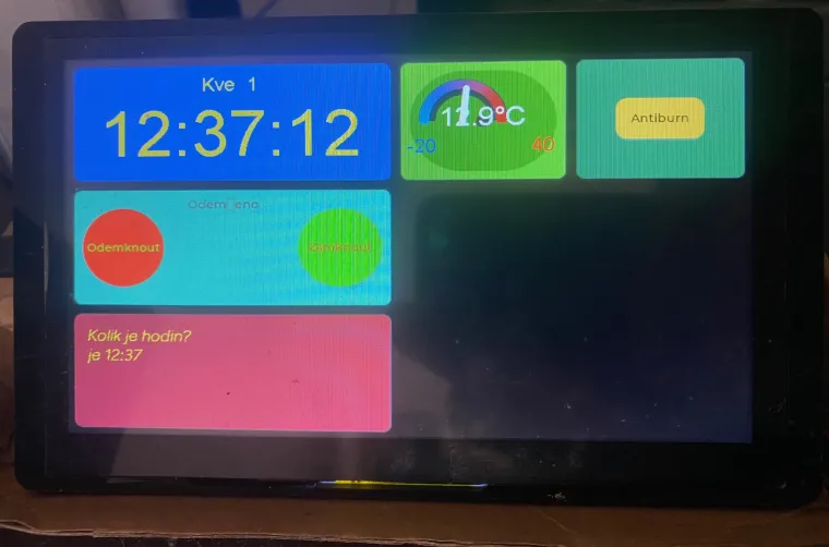

I put the project aside for a while and then came back to it and together with Claude I managed to launch a fully functional voice assistant running under Esphome. I also have Xiaozhi for this version of the panel, the display + mic works, but not the speaker, the answers are displayed on the display.                                                                    VA  Esphome:
- Ok,nabu
- ww on the board
- control the display brightness from ha
- setting the display off time
- turn on the display by touch, switch from ha or voice
- psram speed: 120MHz
- time and date + sensor + a pair of buttons on the display
