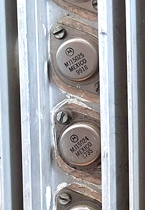

  This is the picture of second amplifier, I made it at almost the same time, right after the mosfet amplifiers and I also made three identical samples.
 These amplifiers worked in incomparably more difficult conditions than the previous ones, in large discos, under maximum load, both on passive speakers and active systems. The source of the circuit diagram is unknown to me, in fact the owner of the company where I worked at the time brought me a nicely documented script titled "PAKEL" - Proaudio Kit Electronic, so that I could make for him a Mosfet amplifier described in it. The script contained several amplifier and preamplifier projects described in detail with circuit diagrams and PCB drawings. Just to mention that I have built all the projects from this script and they all work flawlessly. It was immediately clear that these were super-quality audio projects made with components easily available at the time.
After a long search through my old documentation, I couldn't find this script, and on the internet, I accidentally found a circuit diagram and layout of the PCB elements from the top side, just for this project, at the end of the text you can download it. Еven in today's modern era of cheap D-Class amplifiers, these old designs are superior in terms of audio quality.  Guided by previous experience, my attention was drawn to a 500W audio amplifier with MJ15003 and MJ15004 high-power audio transistors, which at that time were much easier to obtain and were much cheaper than MOSFETs. I actually managed to get the MJ15024 and MJ15025 complementary pair at that moment, which are even more powerful than the originals.
  At that time, the focus of my interest was on the power and not on the quality of the amplifier, but still in this case it was an exceptionally high-quality product. It is a standard concept of a complementary amplifier in AB class. It is nothing exotic, but still with proven quality of most of the amplifiers from the leading audio companies of that time. This amplifier also worked immediately after switching on after 35 years. At the time when we exploited them, we called these amplifiers indestructible because despite the extreme conditions in which they worked, not once did a major failure occur than a blown fuse. At that time, there was great competition between discos in the city, so several times we found a stuck pin in the audio cable that caused a short circuit at the output of the amplifier. In all those cases, only the fuse burned. In this video, I will not dwell on comparing the sound quality or power of these two amplifiers, but I just wanted to present them to you as devices that are still functional after so many years, but also competitive with today's devices of this type.
